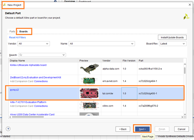

In the Vivado project creation wizard, there is a possibility to prime your design from a board definition.
You don't need to find out what the exact FPGA is, and what hardware is available.
There are more project preparation tools. Constraint files and TCL files that fully define the board with all possibilities enabled.

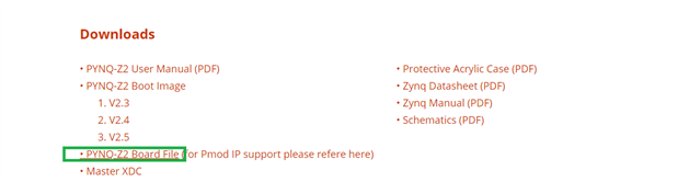

Get the board file
The files listed on pync.io are not available. I found them here.

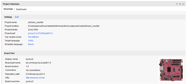

  • (deprecated) Directly put the files in the Vivado boards folder: <Xilinx installation directory>\Vivado\<version>\data\boards\board_files.
  • Or (preferred)  put them at a location you decide, and add a line to the Vivado init file, %APPDATA%/Xilinx/Vivado/init.tcl (create it if it does not exist)
    set_param board.repoPaths [list "D:/Xilinx/pynq-z2/A.0"]
I used the 2nd option. You have to restart the editor.
The result is that you can now create projects that have the right FPGA info for the Pynq-Z2:
