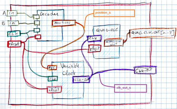

This design is a pure VHDL quadrature signal generator.
With variable frequency. The frequency can be controlled with a scroll wheel.
The purpose of this design is to build an alternative local oscilator for Shabaz' Software Defined Radio (SDR) Experiment Board.
I tried to make everything as standard as possible, so that it can be used on many FPGA makes and sizes.
I'm working on a Xilinx Spartan 6, with a 12 MHz clock (Xess XuLA2 kit).
The design has 4 inputs
  • rotary encoder pins A and B
  • clock  input
  • reset
and 5 outputs:
  • quadrature signals 0 -> 3
  • the variable clock based on the input clock and the encoder setting
The design is broken up in 3 components:
  • decoder to translate the movements of a scroll wheel into a numeric value.
  • variable clock that will stretch the input clock based on the value coming out of the decoder
  • quadrature signal generator will create 4 90° phase-shifted signals from that variable clock.
A wrapper glues the components together.
All this has been used before for my Pynq blog series and this Spartan 6 article: XuLA2 FPGA - Rotary Encoder and VHDL.

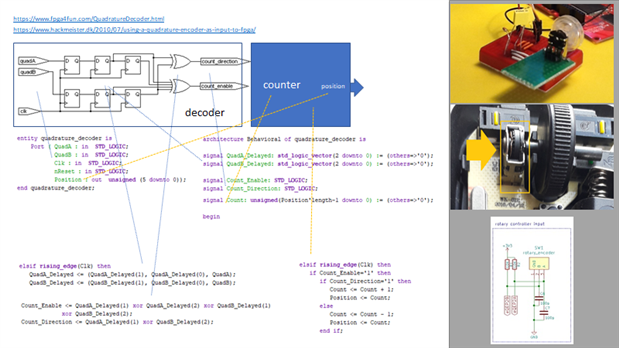

    The rotary encoder explained (from the workshop that Enrico and I ran last week):
    A better implementation (there is one with just the direction and enable pins, and a derived one that has the counter) is available form devbisme 's github: https://github.com/xesscorp/VHDL_Lib/blob/master/RotaryEncoder.vhd
    I put the 3 main objects (decoder, clock delay and pwm generator)  between -- =============================  lines, to make it easy to find them back.
    The 4th object , the wrapper, holds the main inputs and outputs, and wires the 3 other objects together.
    The connections are exactly as in this drawing, except position and clk_out. For those I used an intermediate signal to hold and pass them around (they go from component to component).
    All other pins go directly to an FPGA ball.
