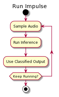

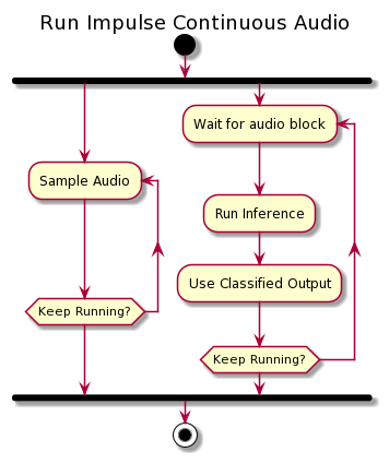

When doing keyword spotting the method used is "continuous audio sampling" which runs the model (impulse) in parallel with capturing the audio data rather than running them sequentially which could cause missing detection windows due to processing latency.  The sequential vs continuous sampling is shown in these images from the Edge Impulse documentation:
Currently, continuous audio sampling is implemented on the ST B-L475E-IOT01A and the Arduino Nano 33 BLE Sense boards.  The implementation uses double buffering which allows the impulse to use one buffer while the other one is being loaded with sample data.  I have an Arduino Nano 33 BLE Sense board that I've used with Edge Impulse examples so I'm going to use that to initially develop and test the keyword spotting model before I try it on the Wio Terminal.

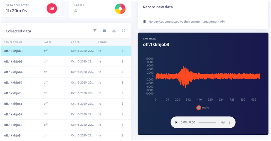

I want to use the impulse to turn the LCD display and NeoPixel strip on and off, so I'm going to train it to recognize the keywords "on" and "off".   The key to accurate inference is having a robust data set.  For keyword detection it is recommended to use 1 second data windows and at least 4 classification categories (labels).  For labels I have the two keywords and a category for background "noise" and for words other than the keywords "unknown".  Normally one would generate the labeled data using data captured from the target board but to save the time required to capture many 1 second samples I elected to use a prebuilt dataset and test how it performs.  I used http://download.tensorflow.org/data/speech_commands_v0.02.tar.gz which is a very large (> 3GB) dataset that contains 20 core keywords ("Yes", "No", "Up", "Down", "Left", "Right", "On", "Off", "Stop", "Go", "Zero", "One", "Two", "Three", "Four", "Five", "Six", "Seven", "Eight", and "Nine").  I used the "On" and "Off" data and merged that with the "noise" and "unknown" data from this dataset https://cdn.edgeimpulse.com/datasets/keywords2.zip .  It contains 25 minutes of data per class, split up in 1 second windows,  So, that's 1500 samples per label and that data is split using 80% as Training data and 20% as Test data.  This process is well documented by Edge Impulse so I won't repeat it here.
Here's a quick snapshot of how the Training data looks in the Data Acquisition window:

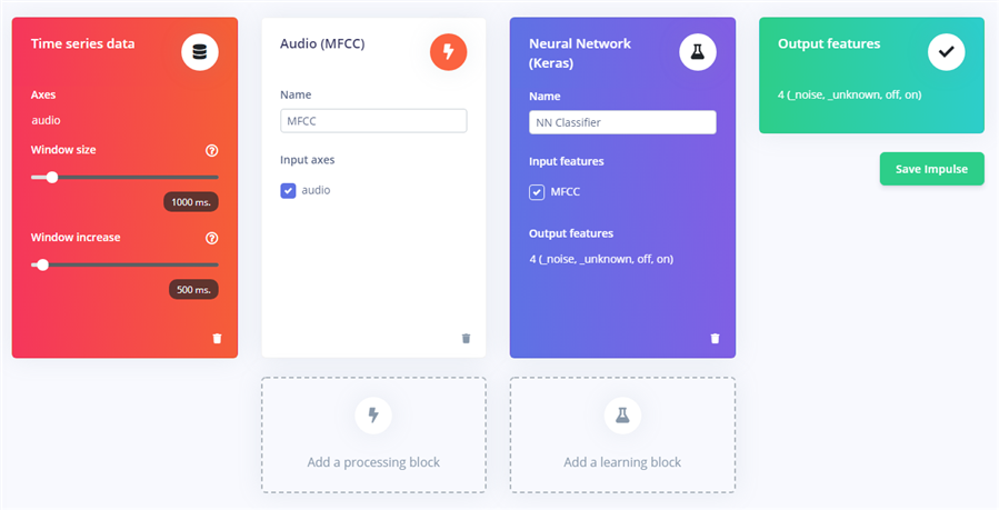

Then you create your impulse in the Impulse design window - shown here with the Data, Processing, and Learning blocks used for this impulse.

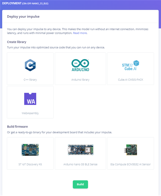

Then you test and deploy the impulse.  You can choose to deploy the impulse as a library or as firmware if you are using a supported board.  I chose to deploy it as an Arduino library that I could use to control device actions within my own program.

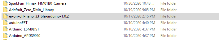

You can then load the library using the Library manager in the Arduino IDE.  Library is shown loaded into my libraries directory:

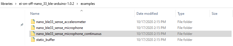

I used the nano_ble33_sense_microphone_continuous.ino example to create my test program
Here's the program modified to toggle the LED_BUILTIN on when it recognizes the keyword "on" and off when it recognizes "off".
