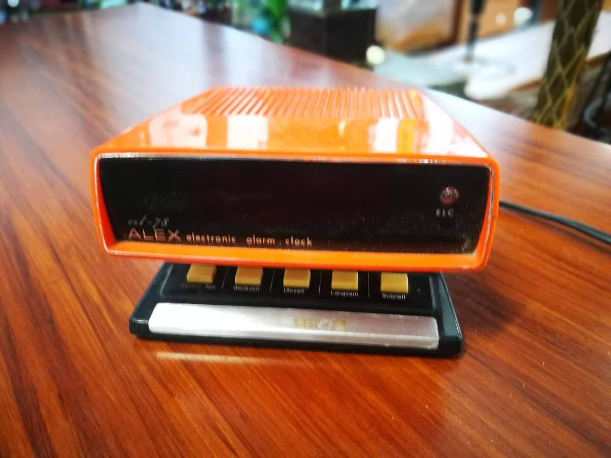

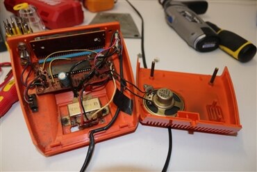

The idea to make a smart clock was not in my mind until a few weeks ago, when I found an incredible nice alarm clock of the past century. Alex is a digital alarm clock, design dates 1978 and - as far as I saw on the net = not so easy to find, only partially working,

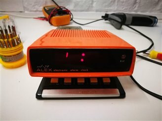

This piece of past attracted me immediately; due to the functional problems I had the opportunity to take it for a ridiculous price. The image below shows the first try to power-on (a sort of road test unpacking first images image )

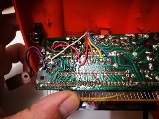

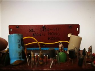

The clock main board immediately appeared easy to reverse engineer but the enthusiasm vanished in few time. Powering the device the lowest voltage I have detected following the wires connected was 16V. Also the discrete components left few hope to integrate the original circuit with new features.
Not easy to find, I have identified the microcontroller as MM5387AA, a digital clock controller working at 24V. It is a pity as I had to remove the entire board and change the original plan: only the peripheral parts was possible to be reusde in some way. For users interested in aged ICs you can find the MM5387AA datasheet in attach.

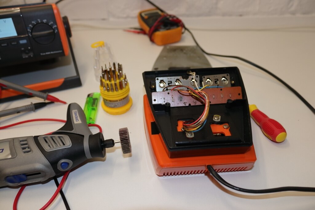

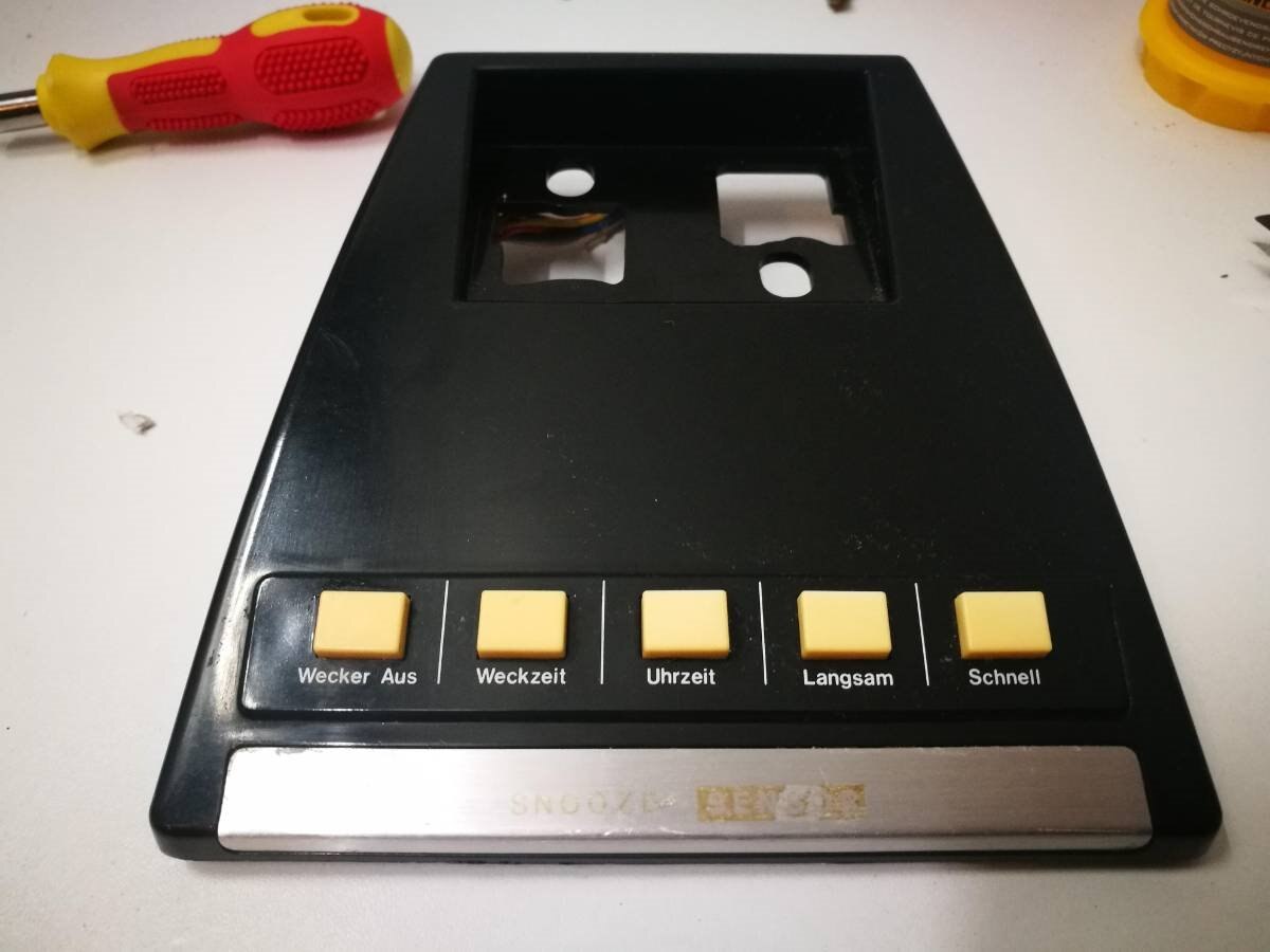

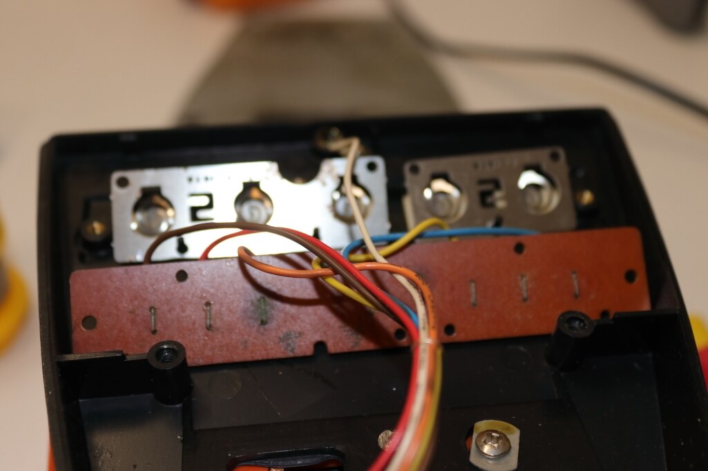

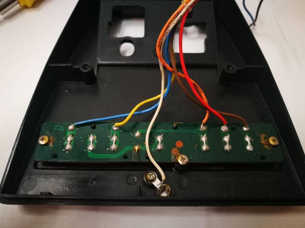

The first cleaning operation has been the clock control buttons. The images below shows the buttons cleaning phases.
{gallery} Buttons cleaning

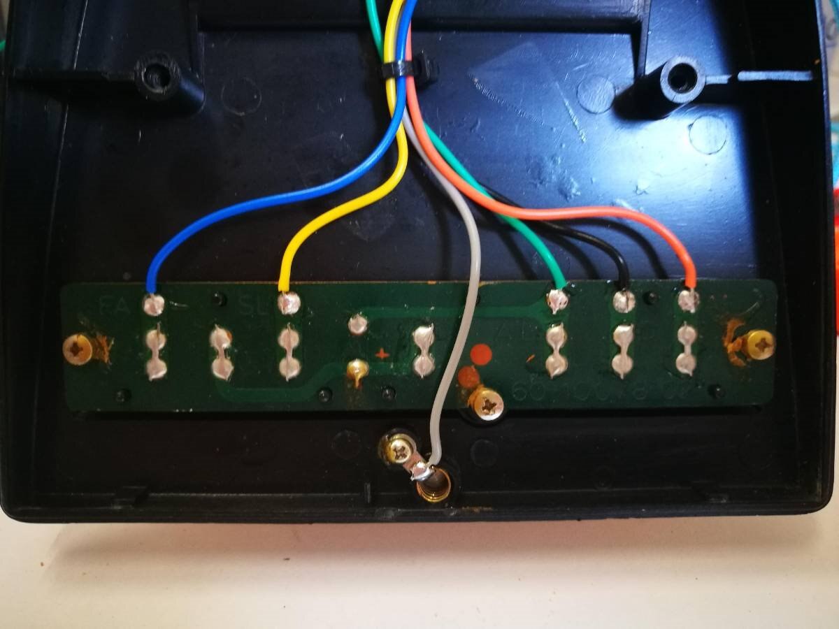

The buttons contacts (upper side) and the connector circuit
Cleaning the contacts and sanding the circuit
The buttons circuit reassembled
The new wires connecting the buttons circuit
The clock base with the button cleaned
