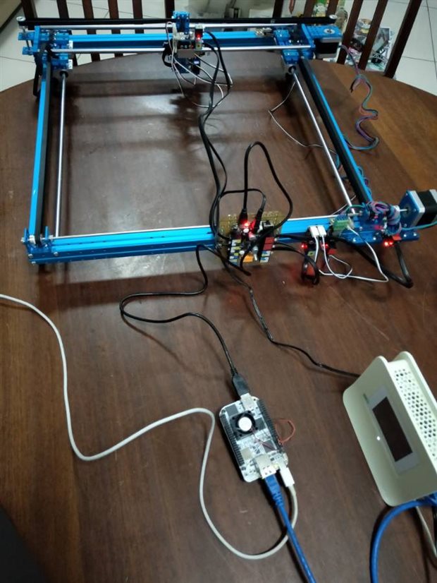

Beaglebone AI is used to control a x-y gantry robot by controlling it via USB serial port. some videos are attached towards the later part of this blog

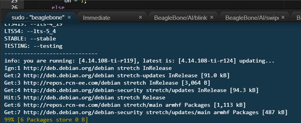

I initially struggle with the insufficient disk space on my Beaglebone AI but solve it
Not enough disk space for apt upgrade on Beaglebone AI

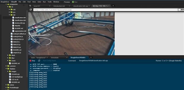

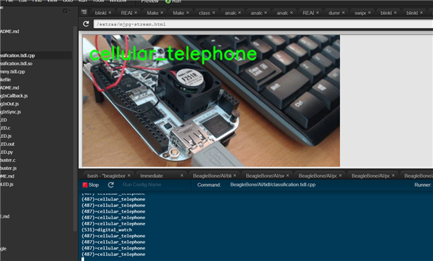

i use a Logitech webcam connected to the Beaglebone AI. Photo here shows the x y gantry. This is using MJPG-Streamer. Instruction as in https://www.hackster.io/175809/tidl-on-beaglebone-ai-1ee263
it is also discussed in more details in the AI with Beaglebone section below

[3] to update kernel
cd /opt/scripts⏎
git pull⏎
sudo tools/update_kernel.sh⏎

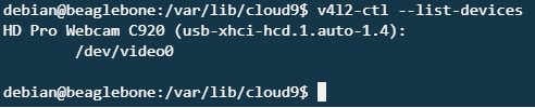

[6] v4l2-ctl --list-devices to list the camera connected.

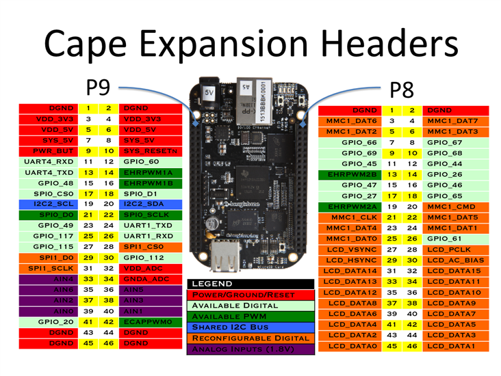

Pinout

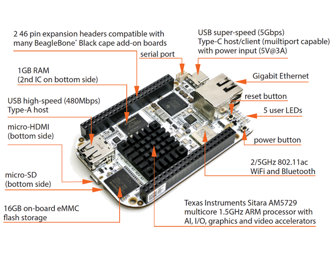

The board photo i grab from https://github.com/beagleboard/beaglebone-ai/wiki/Quick-Start-Guide  shows the subsystem layout
i get to know its pin is compatible with other beaglebone and below pinout is what i get from https://beagleboard.org/Support/bone101 . pin 8 can on P9 header can be used to power up the Nidec fan provided by Tariq.

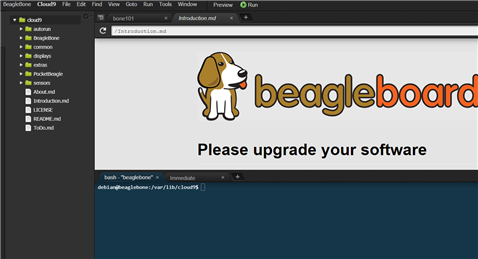

To check whether our BB AI is alive and kicking, connect to the board via USB at 192.168.7.2. We will reach the screen below.
This can be further referred at https://beagleboard.org/getting-started
X-Y Gantry

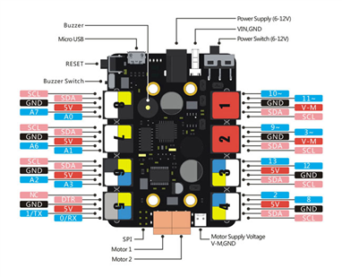

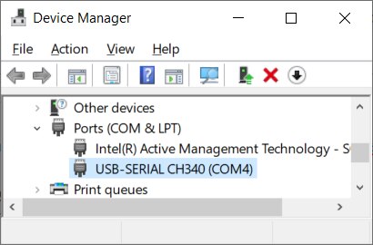

my X-Y gantry is driven by 2 stepper motors. To drive a stepper motor, i use makeblock orion
it has getting started guide here Makeblock Orion – Open-source Arduino Robot Building Platform|Makeblock Learning Resource
Communication between Beaglebone AI and makeblock orion (Arduino Uno with some connectors for makeblock modules)
i use Beaglebone AI to control Makeblock Orion

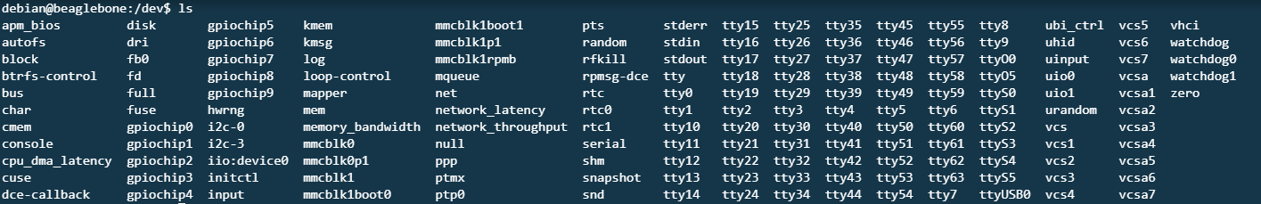

on terminal, the Makeblock is found to be /dev/ttyUSB0
snippet of code that setup a serial port listener as well as a writer

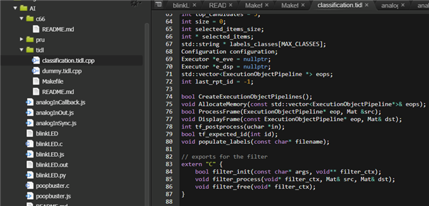

AI with Beaglebone AI
The only viable example seems like https://www.hackster.io/175809/tidl-on-beaglebone-ai-1ee263  with the TI TIDL library
i have to admit that after looking at the classifiction.tidl.cpp i have not much clues what it is doing
these codes are screenshot from classification.tidl.cpp
to run it, after press run and type password, it takes up to 4-5 minutes for me to able to use MJPG-Streamer to look at the picture
before that, it will shows the error screen below "beaglebone.local refues to connect"
after it is ready, it suppose to detect object. my BeagleBone AI with the Nidec fan is detected as a cellular phone image

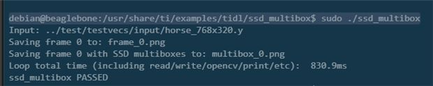

http://downloads.ti.com/mctools/esd/docs/tidl-api/example.html contains a lot of examples on how to use the TIDL API.
to run the example need to use sudo, ie. debian@beaglebone:/usr/share/ti/examples/tidl/ssd_multibox$ sudo ./ssd_multibox
To view processed image, I use eog. Install it by using
sudo apt-get install eog
