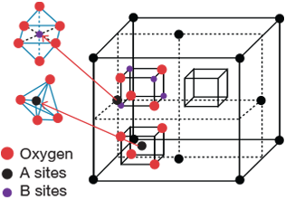

What is the Crystal Structure of Spinel Ferrites?
Spinel ferrite crystallizes in a cubic structure and has a closely packed arrangement of oxygen anions, in which 32 oxygen ions form each unit cell. The anions are packed in a face-centered cubic (FCC) array, leaving two types of spaces between anions: tetrahedrally-coordinated sites (A), surrounded by the four nearest oxygen atoms, and octahedrally-coordinated sites (B), surrounded by the six nearest-neighbor oxygen atoms. Figure 1 illustrates the positions of the four oxygen ions in each octant. The positions are the same in octants sharing only one edge and different in octants sharing a face. The figure further depicts the ionic positions at two adjacent octants, where the octant on the top contains the octahedral sites, and the octant on the bottom contains the tetrahedral sites. All ions are positioned along the diagonals of the octants, and the octant at the bottom contains a tetrahedral site at the octant center.
diagram 1
Figure 1: Crystal structure of Spinel ferrite. Image Source: Yu, Lichao, Applied Physics, 2020

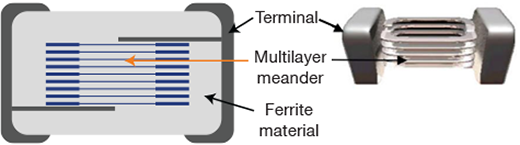

  • SMD Ferrites: Surface mount ferrites or 'chip bead' ferrites consist of a multilayer flat metal coil (aka 'meander') embedded in Nickel-Zinc (NiZn) ferrite material. In this sense, an SMD ferrite is essentially an inductor with high resistive losses at frequencies approaching or higher than 100MHz.The two ends of the meander are connected to terminals that allow connection to PCB soldering pads. Since SMD ferrite uses flat wire windings, they have an extremely low DC resistance (few mΩ to 1Ω). Their use helps to avoid the problems of voltage drop and potential difference, particularly in DC applications.
diagram 4
Figure 3: SMD ferrite. Electromagnetic Compatibility - Without Equations. Chetan Kathalay, 2019

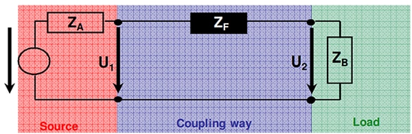

  5. Relationship Between Impedance and Attenuation: Measuring ferrite impedance is one of the most common methods for selecting a ferrite. The impedance of a ferrite core is typically the most important specification for EMI applications, but in many cases, the amount of attenuation is just as relevant. The relationship between impedance and attenuation is expressed as follows:
    formula
Where A is attenuation in dB, and ZA, ZF, and ZB are source impedance, suppressor core impedance, and load impedance, respectively. Figure 8 illustrates a method for determining the attenuation of a ferrite core. Increasing the impedance of the cable ferrite will increase the attenuation for a given source and load impedance.
diagram 9
Figure 8: Determining the attenuation parameter of a ferrite core
