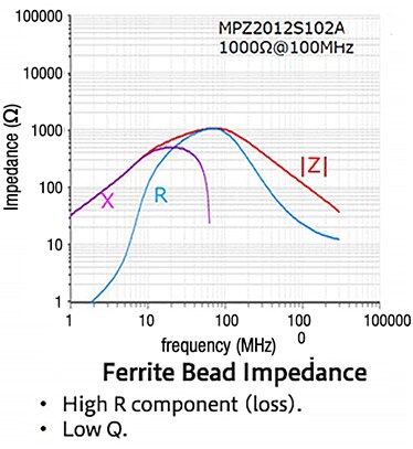

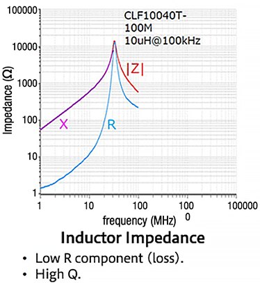

Figure 4: Ferrite Bead vs. Inductor Impedance. Image Source: ROHM Semiconductor
- Ferrite beads are components with a low Q factor. Ferrite beads absorb more noise than inductors, and are thus more effective than inductors for reducing noise emissions over a broader range of frequencies.

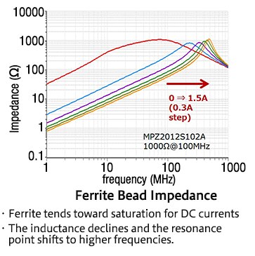

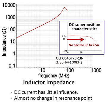

Figure 5: Ferrite Bead vs. Inductor Impedance in the presence of DC. Image Source: ROHM Semiconductor
- When a DC current is passed, ferrite beads attain saturation, causing a decrease in inductance and shifting the resonance point to higher frequencies. In general, inductors are able to tolerate DC currents without a significant change in inductance.

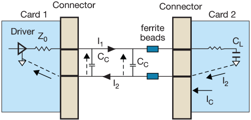

- Common Mode Choke: Common mode chokes with a wide attenuation bandwidth are required to reduce common mode noise on data lines that are transmitting high-frequency signals. The presence of common mode noise can affect the performance of other electronic devices connected to the same power source, causing potential failures. Figure 6 illustrates the use of a ferrite as a common mode choke. I1 and I2 are differential mode currents, and Ic is a common mode current following a different return path. The abnormal current return path is facilitated by the parasitic capacitance Cc. Using ferrite beads with their high inductance will reduce the magnitude of Ic, particularly at high frequencies. Because the ferrite bead’s effectiveness in reducing common-mode current is dependent on frequency, the correct bead material must be carefully chosen in order to target the right frequencies.
Figure 6: Ferrite used in a common mode choke application. Image Source: Perez, Reinaldo. Wireless Communications Design Handbook: Interference Into Circuits: Aspects of Noise, Interference, and Environmental Concerns. Academic Press, 1998

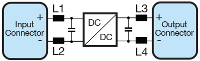

- Input Filtering: Power supplies are designed for steady-state operation; however, transient conditions must also be considered. In practice, transient conditions such as startup, shutdown, and load transients are often far more stressful on the components of the power supply than operation in a steady state. To suppress high-frequency noise, chip bead ferrites are frequently placed at the input and output of power supplies.
Figure 7: Generic DC-DC converter with chip bead ferrite beads L1-L4 at the inputs and outputs
