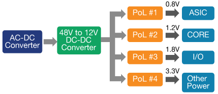

Evolving Power Architectures: Power architectures continue to evolve beyond the classic distributed power model, adapting to system makers' need for multiple voltage rails at lower voltages. Underlying these trends are new packaging designs with increased integration. Smaller packages mean more thermal issues, and companies are looking at ways to improve efficiency while managing heat dissipation. This has led to the development of a "Dynamic Bus Architecture (DBA)," which consists of board-mounted DC-DC converters or point-of-load (POL) regulators that communicate with a centralized power system host control via a digital communications bus (Figure 1).
Figure 1: Example of a Distributed Power Architecture
DC/DC converters serve as POL voltage regulators and provide the required step-down voltage to power various loads like microprocessors, FPGAs, DSPs, memories, logic, and other devices found on board. For example, Diodes Incorporated has introduced the AP62600, a synchronous DC-DC buck converter for general-purpose point-of-load conversion. The AP62600 converter IC can deliver up to 6A output with a supply voltage between 4.5V and 18V. It has a wide 0.6V to 7V output voltage range, and is designed with high side and low side MOSFETs with 36mΩ and 14mΩ resistance, respectively.
