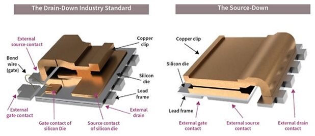

This Source-Down innovation simply inverts the Silicon die inside the MOSFET package. The source potential is thus connected to the lead frame instead of the drain potential. Figure 1 shows the structure of the new Source-Down technology compared to conventional Drain-Down technology. In Source-Down, the Silicon die's gate and source connection is directly established on the lead frame. A large copper clip connects the drain’s electrical connection from the top of the die. The drain, source, and gate's electrical connection continue to be at the exact location, making a drop-in replacement extremely easy.
Figure 1: The internal construction of a PQFN 3.3x3.3 mm Drain-Down power MOSFET (left) and the internal construction of a PQFN 3.3x3.3 mm Source-Down power MOSFET (right)

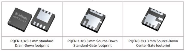

Optimal Layout: Another key benefit of the Source-Down Technology is the effective layout option, enabling high power density and high system efficiency. Source-Down comes in two different footprint versions: Source-Down Standard-Gate and Source-Down Center-Gate. For the Center-Gate version, the gate-pin is moved to the center, supporting easy parallel configuration of multiple MOSFETs. In this version, with its larger drain-to-source creepage distance (0.75 mm), it is possible to connect the gates of multiple devices on a single PCB layer. Figure 2 shows the difference in the footprints of the PQFN 3.3x3.3 mm OptiMOSTm MOSFET family. Drain, Source, and Gate electrical connections continue to be at the exact location, making a drop-in replacement easy.

Figure 2: Comparison of a standard Drain-Down device with the new Source-Down footprints Image Source: Infineon

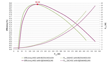

The IQE006NE2LM5 Source-Down package technology enhances electrical and thermal performance, enabling the power density needed in modern datacenter applications. To compare the performance benefits, two versions of an 8:1 HSC (hybrid switched-capacitor) are considered, using the contemporary standard Drain-Down device (BSZ011NE2LS5I) on one board and the new Source-Down device (IQE006NE2LM5) on the other. The HSC DC-DC converter is a new intermediate bus converter (IBC) solution for a 48 V power-delivery architecture, providing high efficiency and high power density for data centers and AI servers. The HSC (Figure 3a) is a creation of six MOSFETs bifurcated into two legs, connected through two flying capacitors and a magnetic device called a multi-tapped autotransformer. Figure 3b compares the thermal performance of the devices. The standard package shows a hot-spot that is eliminated with the use of the new Source-Down package. The MOSFET surface temperature is significantly improved, showing a 9°C difference compared to the Drain-Down device. Figure 3c illustrates the efficiency comparison, including auxiliary losses. The system's higher efficiency featuring the new source-down device leads to a significant jump in power density.
Figure 3a Figure 3b Figure 3c
image image image
Figure 3a: HSC converter topology. 3b: The thermal behavior of the HSC at 450 W from 48 V input with BSZ011NE2LS5I and IQE006NE2LM5. 3c: The HSC converter efficiency.
