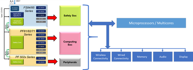

For example, smartphones - the dominant segment of portable consumer devices - come packed with attributes reinforced by sturdy application processors and a lightweight battery that powers GPS, multiple sensors, Bluetooth, NFC, cameras, radios, Wi-Fi, and cellular wireless. These handsets combine multiple PMICs that dynamically administer use and battery life. Figure 1 below shows the Multiple PMICs concept introduced by NXP for optimizing different blocks like computing, safety, and peripherals of a Multi-Processor System.
Figure 1: Multiple PMIC concept for complex SoCs (Image Source: NXP Semiconductors)

Multiple PMICs Concept for High Processing Applications
NXP has introduced the Multiple PMICs Concept for high processing applications that include integrated one-time programmable memory. These store key startup configurations, substantially reducing external components typically used to set output voltage and external regulators' sequence. Regulator parameters can be adjusted via high-speed I2C after startup, offering flexibility for different system states. The following are a few examples of these offerings.
