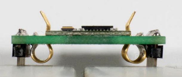

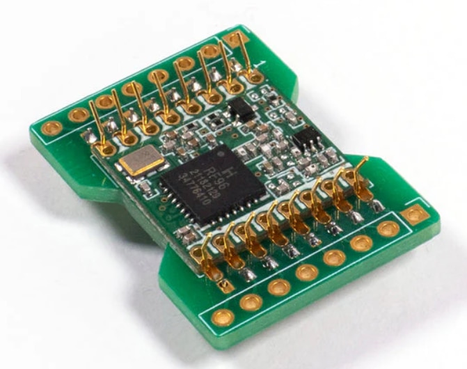

The first clue this time is simply an image of a bare PCB which will eventually be incorporated into the project:
There is something strange about this PCB....Sunglasses
PCB

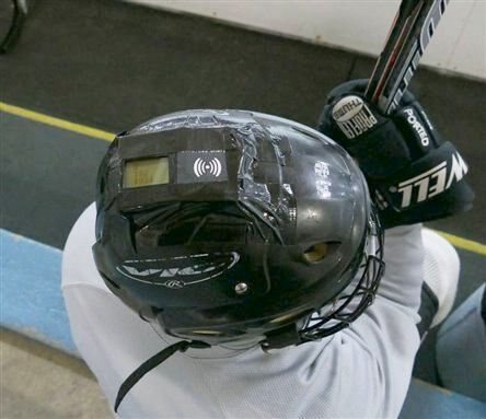

Enclosure
Clue #2 - a picture, and yes it does have a puck....
Here is a look inside one of them....but why do I need two of them?

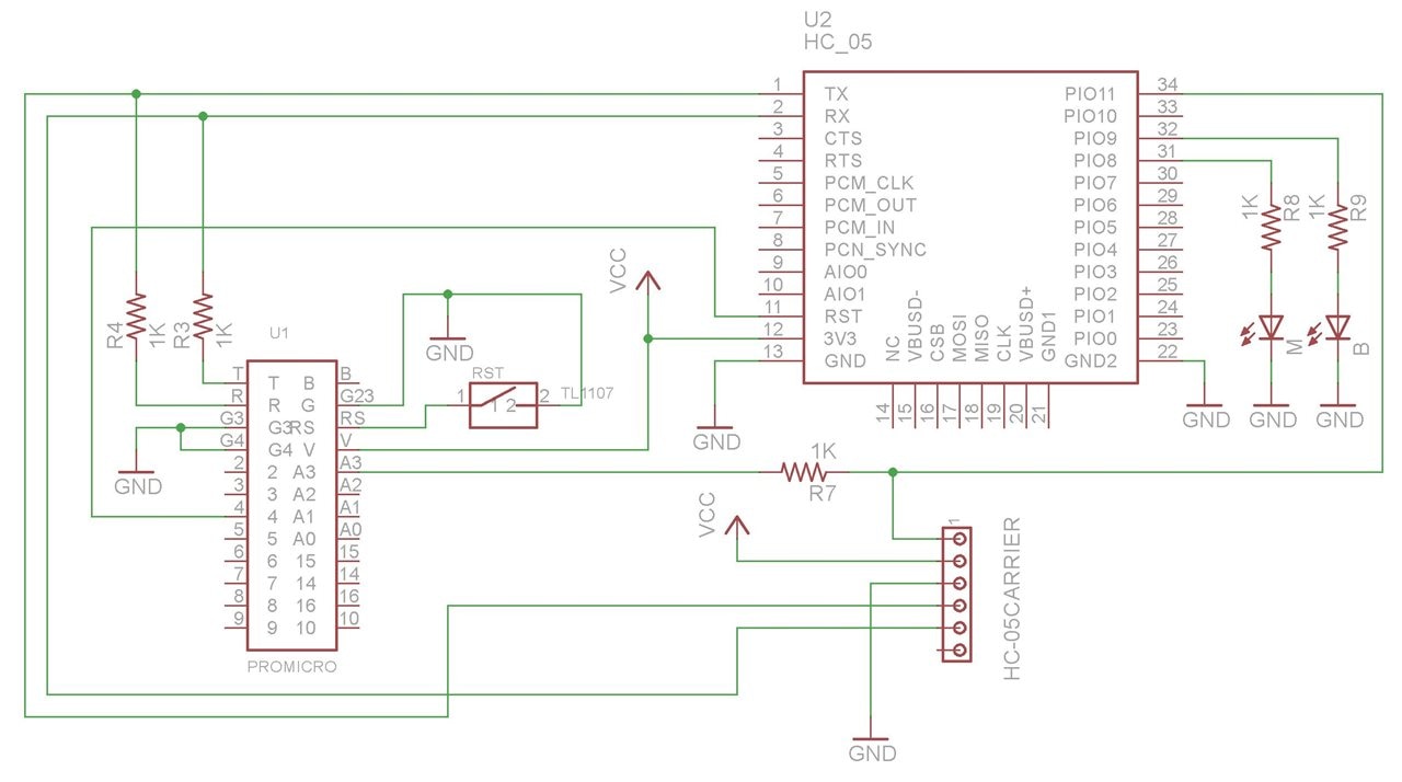

The project objective is simple - develop a couple of instruments that can program HC-05 Bluetooth modules to give them unique names.
I toyed with the idea of making them stand-alone, but ended up opting to run them from a VB6 program on a PC - why not leverage the keyboard and display available on a PC?
The MCU chosen is an Arduino Pro Micro because it is small and there are both 3.3 V and 5 V versions available - I actually had both in stock.
The functions of the MCU are simple, be able to place the HC-05 in either data or command mode and pass through AT commands and responses.
Schematic

  • beacon_dave
    beacon_dave over 1 year ago +2
    Solder Party does something similar to the test point insert called the 'FlexyPin' https://www.solder.party/docs/flexypin/ https://www.solder.party/docs/flexypin/adapters/
  • beacon_dave
    beacon_dave over 1 year ago in reply to dougw +1
    "Multipath routing" supported - one bit over there, another bit somewhere else...
    DAB over 1 year ago +1
    Great project Douglas.
  • dang74
    dang74 over 1 year ago +1
    I was indeed baffled by the footprint with the pair of holes. Thanks for taking the time to explain this special feature in the video.
  • beacon_dave
    dougw over 1 year ago in reply to beacon_dave
    I bought some, but have misplaced them. Confused They are much more expensive....Disappointed
  • beacon_dave
    Ah - yes, you actually mentioned FlexyPins in the video but I think my brain had registered 'flexible pins' at the time... Slight smile
    I take it that the double via holes per pad were what you were alluding to as 'something strange' earlier in the text ? I see FlexyPins tend to use a via and a slot to allow the full spring action.
    Yes - the weird SMT footprint was strange.
