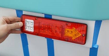

Hi all,
I'm thinking of using a transistor in a car circuit, to switch a light depending on the state of another light.
So it will be 12v as the signal at the base of the transistor.

    Dang, I just realized a logic error in my design!! Noooo!!
    Consider brakes are on at an intersection, and turning right.
    I just tested this on the 4-wire tailer harness in the car.
    In that case the left light stays on, and the right light flashes - and by that I mean there's steady 12v on the left wire, with 12v/0v on the right wire.
    Using my logic, when both lights are on, the red brake lights will be on (good),
    BUT when the flashing right light is off, the left light will be the only one on, which using my logic, will make it show the left orange arrow...
    so then the result looks like "red brake lights" intermittent with "left orange turn light"... giving the impression that we're turning in the opposite direction that we're actually going.
    Dang!
    This just got a whole lot more complicated!
    Anyone have any brilliant ideas?

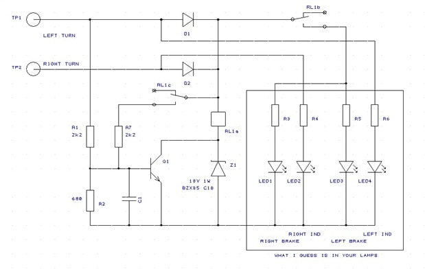

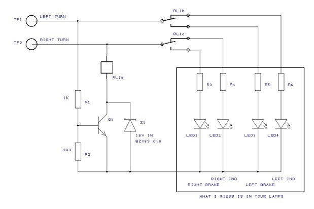

  • michaelkellett
    0 michaelkellett over 10 years ago in reply to ntewinkel
    Hello Nico,
    Here's my scheme:
    The relay can be any 12V coil double pole change over (often called DPDT)  you fancy. The coil resistance should be at least 100R if you want to use up your pn2222a transistors.
    The relay will only be energised when both turns inputs are high and the brake lights get the power. If only one turn input is high then the turn indicators get power.
    With R1 and R2 as shown the turn on threshold for Q1 on the LT input is only about 0.8V, you could reduce R2 to 100R which would set the threshold at 6V or so.
    The transistor only switches the relay coil current and is protected against supply spikes and relay coil inductive spikes by Z1.
    A small capacitor (100nF ceramic) from Q1 base to emitter wouldn't hurt and might reduce sensitivity to electrical noise.
    MK

  • michaelkellett
    0 michaelkellett over 10 years ago in reply to michaelkellett
    Hello Nico,
    Here's a better design - two extra diodes but the relay only needs to be DPST so will be cheaper and easier to find.
    I think this nearly does what you want - if only one input is high the appropriate turn light comes on, if both inputs are high the relay energizes and the brake lights come on (but so do the turn lights), the brake lights stay on until both inputs go low because the c terminals on the relay hold it on so long as there is power through either diode.
    I don't really like the turn lights coming on at all when braking but this gets much harder since you need quite a lot of 'statefullness' in the controller - are you up for a micro ?
    MK
    • Reject Answer
