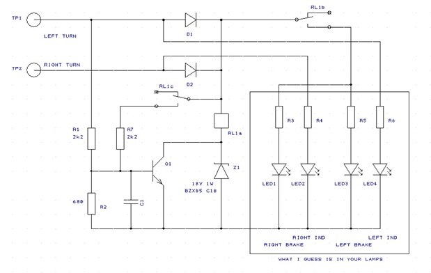

I'm thinking of using a transistor in a car circuit, to switch a light depending on the state of another light.
So it will be 12v as the signal at the base of the transistor.
I have a bunch of pn2222a transistors, and I can't figure out from the datasheet what the maximum means for that. It seems to be a reverse maximum (ie, don't let the output be more than 5v over the base voltage).
So the question is - is it possible to switch a transistor like that using 12v at the base?

    Short answer - no. The base of a transistor is current driven - think of the base emitter junction as being a diode (the arrow on the emitter shows the direction of conventional current when forward biased…

    Thanks Michael! To be more precise with the details, they are to switch the LED taillights on a camper trailer. I should test how much it draws. The description said 3W, but that might be for the whole…

    Hello Nico,
    Here's a better design - two extra diodes but the relay only needs to be DPST so will be cheaper and easier to find.
    I think this nearly does what you want - if only one input is high the appropriate turn light comes on, if both inputs are high the relay energizes and the brake lights come on (but so do the turn lights), the brake lights stay on until both inputs go low because the c terminals on the relay hold it on so long as there is power through either diode.
    I don't really like the turn lights coming on at all when braking but this gets much harder since you need quite a lot of 'statefullness' in the controller - are you up for a micro ?

    That's really good, Michael!
    You're right about the turn lights coming on when braking being a bit annoying, and might be confusing to other drivers.
    It's similar to hooking up the wires directly to the red and orange lights together, but gains the benefit that signals are only using the orange.
    ...this gets much harder since you need quite a lot of 'statefullness' in the controller...
    That's the conclusion I came to as well.
    It seems that the only way to tell if it's a turn signal is by the flashing action.
    But of course! That's probably where I'm most comfortable. My worries are that the micro would have to start up very fast, or else be kept powered up by an alternate source. I'm guessing that a capacitor would keep it running long enough between blinks though. After that it should be possible to determine when a light has been on and off, and then flash the orange indicator on the transition from 0v to 12v, maybe missing the first flash, but that's ok.
    ps, the trailer does have it's own 12v power source too, so that could be used to power it, however, the failure mode (ie, no trailer power available) should provide safe function still (maybe just using the red lights, as would be the usual for trailers).
    Maybe the easiest way to handle it is to add two lines from the car turn indicator wires to directly control the orange turn indicators.

    Hello Nico,
    Simple micros with on chip RC oscillators can be up an running in under 1mS quite easily - I don't think you need store power between blinks because if the brake is on there is always at least one turn signal high to provide power.
    Do you have  a micro preference - almost anything would do (PIC, AVR, ARM) and do you need it to be in a DIL package or are you OK with SO which would need a board. The whole thing will be much more reliable with a board of course.
