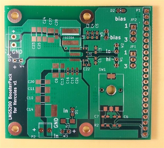

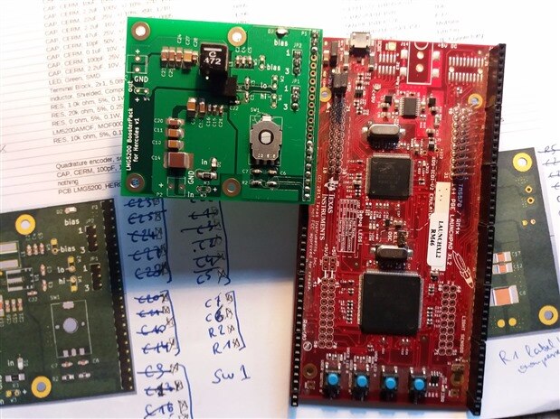

Just like previous designs I did with OSHPark, the Seeed boards look very good at first inspection.
This design is 4 layers, so I have no mechanism to look at the two inner layers. The top and bottom layer look very nice, so that's a good sign.
In the images below, the artist renditions on the left side are generated by the Seeed portal.
The photos on the right side are the actual thing. Click on them to get a detailed view.

This is the first time I'll populate a two-sided board. I'll use hot air for the smd components.This is how I plan to approach it:
  1. solder the GaN IC and the inductor. These two have the pins under the device. I'll have to massively bombard them with heat to transfer the energy underneath where the solder paste is.
    I'll use the pre-heater that shabaz gave  me to get the whole board to a close-to-reflow temperature.
  2. then all the smd components on the bottom side. If they fll of later, that's not a big deal, because the are only few.
    I'll also use the pre-heater but on lower temperature, because its heat will be radiating on the inductor and GaN chip.
  3. Then I'll do the remaining top smd components.
    The pre-heater again on a temperature low enough to not desolder the bottom components.
  4. the trough-hole components by hand
It is my first time. I'd be happy to take your advice on the preferred order to solder the components.

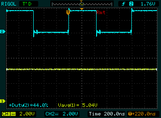

edit: I've attached the waveform of one High input pulse as hi01.wfm.
If you have a Rigol DS1052E you can upload that to your scope and examine the ringing with cursors.

    The board is built up, not tested yet.
    Reflow worked ok, except for 0402 and some 0603s.
    C22(0402) toombstoned, I had to rework C15, C21 and LED D2 too.
    I'm happy that the (somewhat) complex footprint of quadrature encoder - with one oval and two round mounting holes fitted perfectly.
    The two screw terminals however, P2 and P3, are a complete goof-up. The holes are too small, the distance between them is wrong and the total size of the footprints doesn't match the component.
    I have to check how that happened, because I made this footprint myself from the data sheet. (wrong part ordered or delivered, wrong drawing selected in the sheet, inch/cm switch, I don't know yet)

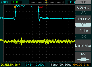

    When I apply bias voltage to the GaN device, power supply goes trough its knees. Even if this is supposed to be a 3mA maximum. The led indicator in parallel is taking more current normally than the whole bias part.
    The LMG5200 is getting real hot too.
    I first used a DMM to check if there are shorts (I did that just after mounting the GaN and inductor too). No.
    So I have now desoldered the GaN device and will check all of the signals going there. I may have damaged the device.
    Hope not. Because I only have once IC left and they aren't cheap.
    On the other side, this is a chance to go and probe the circuit without fear of damaging the GaN device...

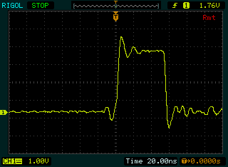

    I see what you mean with the previous capture. That's the ground lead (and possibly, in some degree, the probe itself which isn't really intended for looking at these kind of edge rates). So that really leaves us up in the air. My confident assertion that the ringing is always worse than you see isn't necessarily true (you are testing the test equipment at the same time as the board).
    The input levels are TTL, but with hysteresis. I would be concerned with the ringing you show, given that the oscilloscope may be under-reporting. The peak of one of the ringing cycles has to get to 2V. If it does, do you get shoot-through of the FETs or is there logic on the chip that prevents that?
    The 200k isn't a terminator, it's just a light pull-down to ensure the input remains in the inactive state if nothing is connected to it. The stripline across the board will have an impedance of something like 40-100 ohms depending on where the ground underneath is and the width of the track. For end termination the resistance needs to match, but that assumes that the driving end can actually drive it which might not be the case if it's a weedy processor pin. If the processor output has FETs with a channel resistance of 20 or 25 ohms, you'd be better off with the series termination at the sending end - basically you add resistance to bring the channel resistance up to the line impedance, so if the channel resistance is 20 ohms and the stripline is 50, you'd have an external 33 ohm to match.
    What is the width of the track and the height above the ground plane?

    For the time being, a scope capture of the high side input, measured after the cap, with the IC in place (just soldered a new one in place).
    I'll redo this capture with the trigger point a little more to the left to capture the additional ringing after falling edge, then use cursors to measure the peaks of the rings...
    The ringing stops right at the edge of the screen. The last rising edge you see is also the last significant ring.
    I've uploaded the waveform in RIGOL DS1052E wfm format. If you have access to that type of oscilloscope, it's possible to load the file via USB and perform measurements on the scope.

    Jan Cumps over 9 years ago in reply to jc2048
    First time tested with voltage in, without load. (yay, no explosion nor smoke)
    Here's the ripple of the output, with the scope in AC mode, 20mV/DIV.
    This is DC output with a PWM duty of 44%, input 11.35V
