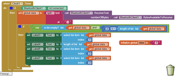

Edited on 10 August 2015........problems can arise if the Arduino Transmission and Android Receive delay times are set identically. This wasn't a problem for my set up, but seems to be for others. If you leave the Arduino delay at 1000mS, then reduce the clock/timer delay in App Inventor to 950mS, it should be good image

    summi Ok what's happening here is that the Android read and the Arduino send are overlapping so that the Android read buffer is corrupted. This happens very very rarely on my Android devices - can't explain why it's so frequent on yours.
    The only solution I can think of is to test the data read from Bluetooth and makes sure it's a number. I've had this running for a long time with no problems
    Here is the modified code block which does that: I will attach a copy of the modified .aia file to the original post.
    I hope this fixes your problem

    That sadly didn't fix it, because the sended data's characters are only numbers so nothing happend image. But i fixd the problem I bought a new phone, just kidding image. I modified the arduino's sketch. The sended data is now a string and the sensor's value's are divides withc comma's like thes:

    The first comma is neded just for my phone for others it isn't necessary. And the apk is loks like thes:
    it is necessary to take the timer's Timerinterval lower than the arduino's sending time intervall, becasue thes way there wil be no bufferd two line in the droid's buffer. Thes way you can send multiple data too. I know thes is not the best way to  make the communication but it's working image .

    First of all, my original posting was intended to transmit a single item of data - a number, or a string of text to the Android device.
    The solution you have been following,  by Kovacs Lajos, is sending 2 numeric data items as a concatenated text string - in fact sort of .csv data. Why his phone needs the leading comma, I don't know - I get the same error as you if I try his code.
    So if you are only wanting to transmit a single data item, my original solution should work, but maybe not out of the box - sorry!
    I'm pretty sure that the problem you have is probably caused by the transmit and receive both running at the same nominal delay - ie 1000mS. This results in the Android buffer sometimes containing 2 transmissions from the Arduino.
    I get the problem sometimes, but not very often!
    However, if you reduce the clock/timer time in the App Inventor from 1000mS to 950mS, while leaving the delay in the Arduino at 1000mS, that should fix it. If not, try reducing it to 900mS.
