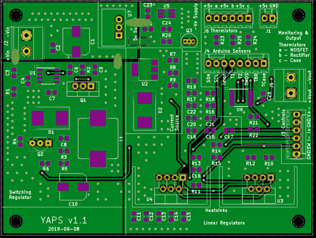

    Hello Andrew, Having now looked at your schematic and their design article [I'm doing this all backwards!], here are a few quick observations. In the context of their circuit (I found your schematic confusing…
  • jc2048
    jc2048 over 7 years ago
    Hello Andrew,
    In the context of their circuit (I found your schematic confusing), the feedback circuit looks reasonable. Do you understand, from your simulating, how that tracks the converter output so that it's just above the linear regulator outputs or would you like me to talk you through it? (Understanding it is useful because you could then [temporarily] modify it to give more headroom for experimenting with the circuit - always keeping in mind the dissipation of the linear regulators, of course.)
    The converter you've substituted operates at a much lower switching frequency - theirs is 700kHz and yours is 200kHz. That will have an effect from the point of view of the ripple (higher) and the control side (the voltage loop control bandwidth is consequently much lower - so it will respond to changes at the Vf input much more slowly).
    A second obvious difference is the reference voltage (yours is higher at 1.2V - theirs 0.97V). Curiously, because of the way this all operates, that isn't too much of a problem - it just gives a small amount more of headroom which, if anything, is probably helping you a little.
    There's also an odd quirk (look at the graph called 'Frequency vs Feedback Voltage' in the datasheet) where it shows the frequency dropping when Vf is low. (May not matter, but it's the kind of thing to keep in the back of your mind, just in case.) It could be part of the explanation for why you're seeing the 100kHz switching frequency.
    Loop stability, once you move away from recommended circuits and simple, resistive, potential-divider feedback, is difficult with a switcher because of a) the mix of analogue and PWM making analysis difficult anyway and b) they probably don't tell you all you need to know about what goes on inside the chip. It was easy for the LT engineers because they have to understand it intimately to design the chips in the first place. You may well be lucky and it may all be unconditionally stable. If not, you'll need to experiment with it. Keep it in the back of your mind as a possible cause of problems.
    The capacitors, the one on the transistor emitter and the one you've got at the Vf input, look to me to have been intended as noise filters to reduce high frequency noise rather than modify the loop response.
    The trickiest situation would seem, to me at least, to be when the output load changes. The linear regulators will counter that change fairly quickly but the poor old converter will just trudge along slowly behind and there's then a real risk the regulators run out of headroom as the capacitor on the output of the dc-dc converter discharges before it can be replenished. Perhaps try switching your load resistors with a logic-level MOSFET with the gate driven from an Arduino, or something like that, and see how the linear regulators and the dc-dc converter respond to the load going on and off. You should be able to work out what's going on from the scope traces if you probe around. [Perhaps, for experiemnting, you could make the headroom variable (with a pot), rather than the fixed 1.7V or whatever it currently is.]
    As far as noise goes, you need to think differently about the switching ripple noise and the switching spike noise. The ripple comes from two things: indirectly, the coil current ramping up and down (a natural part of the converter operation) converted to a voltage by the ESR of the output capacitor(s) and, directly, the output capacitor(s) voltage as it charges and discharges. The linear regulators will remove much of that.
    The spikes come from the very rapid changes at the switching node when the switching takes place and are difficult to deal with once you've generated them. The very fast edges will have frequency components that are radio frequency signals and they'll readily skip around through quite small parasitic or intrinsic capacitances. If you've got some clip-on ferrites, you might experiment with passing the output wires from your board (ground as well as the Vout) through one and see if that helps reduce it a bit. Keep the wires coming out away from those going in or you'll get some capacitive coupling across, reducing the effectiveness.

    I've been mulling over a few things since Sunday:

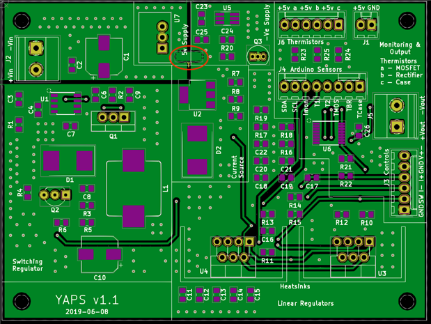

    • The feedback circuit: I’m no stick in the mud - if a common refrain is “something up with the feedback?” from you and Shabaz (and a couple of other people who haven’t even seen the circuit) I think that perhaps there is indeed “something up with the feedback”!
    • The ground plane: I think I’ve got this hideously wrong and I’m coupling noise from the switching circuit into the rest of the control circuit.  This is just something I was thinking about and have been researching.
    I thought I understood what the feedback circuit is doing but I've been mulling over the data sheets again and in trying to articulate it here, it doesn't add up in my head - I can't see how it operates to reach the 1.7v difference, sorry.  Essentially, it is 'programming' a different output voltage for the LTC1624 as the load voltage changes.  I had thought the two 100K resistors were providing a voltage to the PNP transistor approximately half way between the output voltage from the inductor (switching circuit) and the load voltage.  The 1K resistor is reducing the voltage from the inductor to just enough to turn the PNP on and allow enough of a current to flow over the 5K resistor to tune the voltage to the feedback pin.  That is being internally referenced to balance the output of the LTC1624 such that it adjusts the current to the Inductor so it remains in balance with the output current.  That naturally adjusts the voltage to allow for that balance to occur.  I guess I took it for granted because looking at the simulation in more detail, I can't work the maths out,
    If I look at the ground plane I have - first image is bottom layer with silk screen; second is the top layer - I kept the power ground separate (as the datasheet said) but I'm thinking that the way I've laid this out is contributing to the problem.  You can see where the net tie is (circled), so path to ground for the switching circuitry is underneath the rest of the control circuitry but is also mixed on the top layer as well.
    I'm now thinking I should have done the following (replicated on the top layer), and tying in multiple places:
    Next Monday, I'm meeting up with a colleague who is bringing along a DC load so we can see more of what is going on and what happens as the load varies.  It always struck me that to build a power supply, one could do with a DC load, but to build a DC load, one needs a power supply - I didn't want to buy either!

    Thanks Jon, that's very useful and I can follow that easy enough.  When you mention 1.2V as the reference do you mean 1.19V or 1.28V?  The former seems more tied in to the adjustment of output (through the Error Amplifier), but the latter is how the functional diagram is shown with the OV comparator as per your sketch - but seems to be used to limit transient overshoots (1.19V + 7% = 1.28V).  I'm assuming you are rounding 1.19V for ease.
    I don't want to change my circuit physically just yet - a colleague is bringing a DC load on Monday to try out and I want to make sure its working (he's bringing it from Yorkshire!).  Having blown Arduino analog pins yesterday I'm now unsure of the state of either the LTC1624 (from the incorrectly soldered Schottky which blew, at least, the Mosfet and sense resistor) nor the LT3081s.
    What I have been doing is playing around with the feedback circuit in LTSpice and I can stablise the Vfb significantly - keeping it at 1.19V:
    Before (compare to measured actual in my comment below which changes from 696mV to 1.46V):
    Whether or not it improves things in reality is anyone's guess until I try it: Vout is stable in both setups so I can't really trust the simulation but I have nothing else to go on.  However, my thinking is that if the feedback isn't stable around the reference voltage of 1.19V (1.2V) then it's going to struggle with ith-run and compensating the output.
    The changes that make the most improvements are re-routing C6 and adding C4 (this is the LT Spice circuit NOT the schematic!).  I have also set the ESR value for C8 to 0.028 Ohms (I can get a replacement cap with that value at 100kHz which if I've understood correctly would be better at a higher frequency) - the data sheet for the existing one doesn't state the ESR but judging from its tan-theta at 100Hz, it's almost certainly too high.  Changing the Inductor to 50uH makes a much smaller improvement.  I've already physically tried a 0.1uF capacitor alongside C8 but it made no discernible difference.
    Ultimately, I will need to re-layout the board as well, change grounding and so on.  But the above changes are readily implementable so I could see the impact of the changes first to make a judgement call.
    Do you think perhaps I'm flogging a dead horse with this feedback circuit and this Switching Regulator?  If so, I can head back to the drawing board and try and work out a different approach.

    I meant 1.19V. [They were obviously trying for 1.2V, missed slightly, and I'm being polite and pretending they hit their target.] 1.2V is very common and you'll see it a lot - it must be something to do with what's possible in a chip with a bandgap reference. The partial diff amp I drew is the one marked EA on their functional drawing - it's what is generating the error term.
    The [controller] compensation doesn't roll things off quite as fast as I would have expected (assuming I'm simulating it right - I'm a bit confused by the additional bits and bobs hanging on the output of the transconductance error amplifier) - it looks like it's about 40kHz or 50kHz before the gain is down to its minimum value. [The internal compensation comes from the Cc capacitor and Rc resistor.]
    Be careful of how much capacitance you add in the feedback circuit - too much and the dominant pole of the controller compensation won't necessarily be dominant anymore.
    The feedback circuit is an amplifier with a gain of 2.5 (the potential divider at the base is a gain of 0.5 and the ratio of collector resistor to emitter resistor is 5, giving 2.5 overall). You might experiment with lowering the gain a bit to give the curve a lower slope. That might help with not running into the overvoltage comparator or, the other way, having the clock slow down.
    There's an offset because of the Vbe. That may, possibly, be beneficial - I haven't looked at it carefully. If you wanted to remove it partially, you could add a diode in series with R5 to counter it - only partial cancellation because the current is lower.
    How did you arrive at a value of 100uF for the output capacitor? [If you've got some spare ones, it would be quite easy to add a couple more if you scraped away resist. That would divide the ESR in three and triple the capacitance (roughly). Might be an interesting experiment to try.]
    I suspect you may end up needing to give it more headroom than the original, in order to get around the problems that this controller has introduced, so you might find the regulator dissipation becoming an issue. It also depends on what you want it to do - were you hoping to control it from the microcontroller so that it works as a fast (variable) voltage source? Or is the output essentially static and just needs to respond quickly to load changes?
    I think the different behaviour when it comes up is possibly the regulators catching up with the controller more quickly in your case than the original. But the way it dips in both cases isn't very nice for a PSU.
    What are you going to be using it for? The last page of their design article shows the noise. They say it's good "for a mixed-mode" device. Whether that's true, I've got no idea, but it's poor compared to even a cheap analogue supply. They haven't made much attempt to deal with the high-frequency spike noise other than what comes from doing a reasonable layout. So you've got work to do there if you want it for powering sensitive analogue stuff (it would be fine for anything you'd normally power from a switching supply, obviously).

    Thanks Jon - I did think you meant the error amplifier but the way you drew it I just wanted to check!
    As for the output caps, it was really based on the existing schematic and the simulation on LTSpice.  I neglected to choose low ESR ones for the input and output capacitors.  Calculating ESR from tan-theta for these at 100Hz (so meh!) gives ESR of around 1.5Ohms.
    I had seen the noise graph - naively I thought I could do better given the LTSpice simulation.  Where I'm getting to know is not dissimilar: see my follow on comment at the end of this thread where I've made a bit of progress.
    I had intended the project to be a learning exercise and to end up with a useful bench power supply.  As I said at the beginning, I'm right at the edge of my comfort zone (actually, fallen off the cliff now but I haven't hit the bottom yet!) so I expected to learn a fair bit and it is absolutely achieving that goal.  If I end up with something restricted in use then I guess so be it, but I haven't finished yet.  There's optimism for you image
