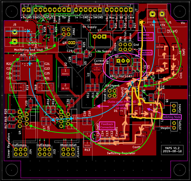

Two things became very clear to me once I got into the detailed testing of the project:
  • I have completely stuffed up the grounding and layout of the components.  In particular the Switching Regulator has a convoluted route back to Vin -ve and the route it does have takes it right under the sensitive components (until I bodged in a couple of wires).  Layout is too far apart for many components, including the bypass and decoupling caps, and non-conducive to managing noise.  There are no test points with the result that I have blown a number of components including 3 ports on the very expensive 4Duino.
  • I really didn’t have enough knowledge about DC-DC Switching Regulators - I sort of hinted at this in my design post - which becomes clear as you read the answers to some of the advice being given.  In some respects that might be a good thing as maybe I wouldn’t have started on this!  However, I apologise to those who have graciously helped out nonetheless and hopefully I've at least made a start in remedying that.
On the plus side, testing showed that functionally it works so I can get my 0-15V, 0-3A out.  I set about sorting out my understanding so that I could properly layout the board, but also have a much better understanding of how that part of the circuit is working so I can properly probe and test it.  There is excellent coverage of the subject from Micro-Rohm, starting with Switching Regulator Basics, that covers DC-DC switchers in some detail but at the same time keeps the language easy to follow.  There are also a multitude of papers from TI and Analog and the data sheets for buck converter ICs have been helpful - the LT1624 datasheet is still confusing though.
The design is still basically the same, with most changes to the Switching Circuit and Linear Regulator Circuit.

PCB
Hopefully the images I've pasted are viewable but I've attached the Gerbers as well.  With the layout needed, I've gone with a 4-layer board to achieve it - it's a bit more expensive but for the sake of £20-ish it feels worth it given the difficulty of trying to do this with 2-layers, at least that's how I perceive it.  It's also resulted in a slightly larger board at 100mm x 95mm (current version is 100mm x 75mm.)

Ground Plane vs Star Ground
Before I get into the layers in more detail, I want to start off with this as it’s come up a bit in comments.   As I researched this it became clear that TI, Analog, Micro-Rohm and others all recommend ground plane; however I cannot also ignore Gene’s comments and advice, which comes from experience, to avoid these and use Star Ground.  So where does that leave me: I don’t yet have the experience of implementations (of both approaches) to determine which would be best nor can I make multiple boards with different configurations - the costs are just too high.
So, I have to make a decision and what I’ve gone with is the advice from TI, Analog, Micro-Rohm:
  • All high current ground traces are on the top layer except for two places where I had to go down to layer 2
  • Layer 2 is a Shield Ground which connects solely by the -Ve PCB terminal for Vin.  There are no other connections to this layer.  However, there are vias and through-holes plus the two high current traces that needed to be routed off the top layer.  There is also a Keep-Out underneath the Inductor (L1).
  • Layer 3 is a Signal Ground layer which connects solely by the -Ve PCB terminal for Vin.  There are no other traces on this layer but there are, obviously, connections for all low-current components.   There are also through-holes and vias and a Keep-Out underneath the Inductor (L1).
How does one avoid creating TH 'slots' (holes in a row) in these layers?  I have no idea.  Quite a few come from the test points I’ve incorporated: even using SMD points would require vias for the ground pins unless I avoided those.
I’ve avoided Thermal Vias as testing to date shows that’s not necessary and it would make more holes through the layers.

Silkscreen and Solder Mask
To make it easier to see some of the following images, here's just the silkscreen and solder mask:
Top Layer
(Green traces are bottom layer traces)
High Current traces, shown with green arrows, route along the right, bottom and right side.  Ground traces, shown with cyan arrows route in a similar manner: where I have ducked down to layer 2, dashed cyan arrows, (the Shield Ground) I have used vias to connect the traces - I've just noticed that the fourth short arrow at U3 should be a dashed one.  These are 0.508mm diameter with 0.254mm drill but would it be worth making them bigger?  The check list calls for “numerous” but could I do with fewer of them to reduce via holes through the layers?
Components are placed quite close to each other - much closer than in the last version.  It looks do-able hand-soldering.  In particular, the feedback circuit is well away from the power traces and route through traces to just past the output capacitors.  You can see that I route the GND return under the power ground (on the signal layer) to connect there by the output capacitors as well - it is equally possible to connect at the point it ducks down but I’ve kept the traces together as recommended by the check list.

I think I’ve made a much better job of laying out and routing the design this time.  The first version was so bad it wasn’t even worth trying to start dealing with the sources of noise but my hope is this will prove capable of proper measurement and action: the placeholders for ferrite beads/capacitors/resistors can at least allow some modifications to be made as a result and the test points will prevent me blowing components up.  I'm more than happy to provide additional information if anyone is interested.
A summary of my questions:
  1. Would it be advisable to swap the MOSFET back to the TH version I used before which is more capable of dissipating power?
  2. Is the use of TH pins for the GND connection with my test points - so I can use the short GND wire on my probe - better than removing those holes through the planes?  Alternatives would be to use SMD test points with vias (smaller diameter) or doing away with GND test points and using the longer crocodile clipped GND wire.
  3. Layout guidance uses a lot of relative terms such as ‘close’ and ‘as possible’.  Is the trace from the Switching Regulator (U1) to the gate of the MOSFET (Q1) too long?
  4. The GND connections for the feedback circuit, Switching Regulator and the ITH/Run pins route around to connect to PWRGND just past the Output Capacitors (one piece of advice read.)  Would it be better to route these directly to the +ve and =ve pads of Cout1 - the 100uF output capacitor (another piece of advice read.)
  5. They don’t just connect to PWRGND just past the output capacitors, they also route under PWRGRND to do so: I could avoid doing that and connect at the point the trace jumps down.  Is it better to leave as-is?
  6. The PWRGND traces all route back on the top layer to the -Ve pin on VIN.  Very close to this point is the single connection for Shield Ground and Signal Ground.  Would it be better placing this nettie close to -Ve pin on Cout1?
  7. The Shield Ground is the full size of the board.  Should I just place this under the high-current routes or does it not make any difference?
  8. From experience, does this look hand-solderable if care is taken with the order of placement of components.
  9. I have no copper fills on the front or back layers.  If I added these and tied them to the nearest ground plane the vias would pass through all 4-layers.  Ultimately, I don’t know if it would improve anything so I didn’t bother as more holes in the layers seems ‘a worse thing’ but am I wrong?
I’d be very interested in thoughts and observations on my approach so I don’t make the same mistakes as last time.  In particular, given that grounding was a major issue in the current version, what’s your views on how I’ve done this time.

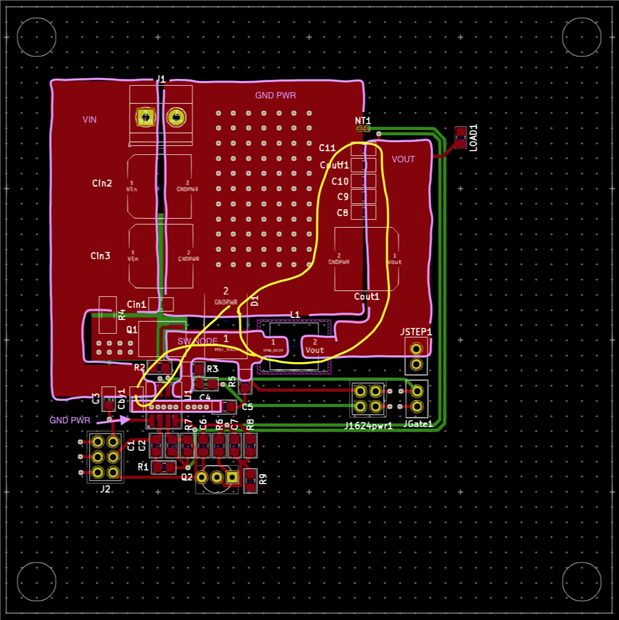

    I don't know if this will help the discussion, but I've drawn the switching currents for the regulator circuit on your layout in orange.
    This is my understanding of what's going on, but I'll just say I wasn't taught this stuff formally so don't rely on what I'm saying and feel free to question it. Like many engineers, I ended up having to deal with switching circuits but haven't gone much beyond using them as POL on digital boards and as LED drivers [in both situations you tend to follow recommended layouts and do a bit of extra filtering to get past EMC, and neither is as challenging as the more analogue-like thing you're trying for
    here]. This will sound like a lecture but believe me it isn't.
    The small 'dashed' arrows indicate where the switching currents switch on and off. The continuous stretches are where the current ramps up and down giving current ripple (assuming it's working in continuous mode). There are two loops corresponding to whether the MOSFET is on or off - remembering that the Schottky is also a switch (albeit not controlled directly by the controller) - a large loop and a small one. To keep the noise down, you need to minimise the inductance which you can do by minimising the area of the loop. You particularly need to try and minimize the inductance in the large loop you have here. You need to minimize the inductance because it's going to generate a voltage spike when the current abruptly stops [the parasitic inductance will get rid of its stored energy by generating an emf and coupling the energy elsewhere].
    The other major noise generator is the switching node which I've outlined in yellow. The voltage waveform there has an amplitude of the full supply voltage and is driven with a high current so the edges will readily capacitatively couple to anything it can develop a voltage field with. In your case that's mostly the 'shield' layer. I'm very unsure of the next bit, but I think that might result in charge mainly moving across the shield from/to the tie point [yellow line], so potentially there might be coupling back up in the area you've marked as feedback. I'm unsure because I can't really quantify it. The plane is metal and a low impedance but it takes time for the change to propagate across. The edge rate will be crucial to all this and given the reverse capacitance of the Schottky it probably can't move fast enough to give the kind of problem I'm envisioning. And now we have a current on the go - remember currents flow in loops - we need to think what is driving it and where does the return go on the top surface.
    The return presumably either flows through the power ground, 'through' the output capacitors, to the other end of the coil when it's that that's driving the change or to the input capacitors when the MOSFET is driving the change. You can see how convoluted this stuff gets and how you tie yourself in knots with it. Anyway, what you've done with the shield may be brilliant or it may be awful (but I'm not sure the input is the place to tie it).
    To be more practical, rather than analyse this to death, I'd suggest you might try alternative layouts on a piece of paper. You could probably manage something where the grounds of the input and output capacitors were much closer together and not at the extremes of a 'Z'.

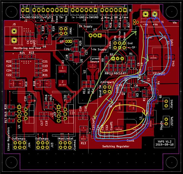

  • Andrew J
    Andrew J over 7 years ago in reply to jc2048
    Thanks Jon - I would never read it as a ‘lecture’ so don’t worry, I get a lot out of your responses.  And if it helps, I’ve been cramming a lot on this and can tell you you’re right about the loops.  Almost image  There are three (blue) loops - Vin, Cin and Bypass - formed when the MOSFET is on, and one when it is off (Yellow.)  In retrospect, it would have been useful to have put these on originally.
    The trick, worthy of The Great Mephisto, is to keep ALL on and off loops as small an area as possible AND keep the switching node (your yellow loop) as small as possible AND have power components away from the sensitive circuits AND have the bypass cap butted up to the Regulator by its VIN and GND pins(!) AND keep the gate trace short AND connect the IC to PGND and SGND simultaneously AND AND AND….  At some point tradeoffs get made: notwithstanding The Great Mephisto, the trick I need to get right is to make the right tradeoffs and not the wrong ones!
    You’ll see from the above image I’m still playing with layout and I’ve been thinking about it all day whilst wandering around some dead person’s country pile.  However, one of the no-nos is to have Cout too close to Cin - there's that relative term again, but in this case close means 1-2 cm.  This is to prevent high-frequency noise passing through Cout into the output.  Having said that, my first thought to play with at the moment is to shift the test terminals, flip the inductor -90deg put the Cout Caps there and drag it all in somewhat - pretty much what you say about getting Cin and Cout closer together, but not too close!   Except no matter how I route it, those Ground traces are going to bend unless I route it down a layer and I was really trying hard to avoid that in the Switching Regulator part of the circuit.  You know, when you read this stuff and they image their recommended layout, the imaginary Regulator they choose to use to do so has the pins in precisely the right location to make it work!  Little @£$!$.
    However, what you have highlighted in particular, is the yellow stalk (or the green arrows on my image) - as a rhetorical side thought, is it reasonable to think the AC noise would follow under the forward trace back to the nettie, away from sensitive components, rather than head direct like DC?  Would it/could it couple back up a layer again into sensitive circuits (none are connected to that Shield layer)?  I’m still researching the Shield Ground (and grounding/layout in general for SMPS) as I’m still not sure what it is when it is referred to.  Actually, the real problem is, fundamentally, that there is ZERO consistency in approach recommendations by anyone, even TI have two different recommendations: ground traces on the top only and use a ground plane.  However the consistent message I do read and do understand but still have to constantly bang my head on the desk to get it to sink in is that currents will return to their source.  I’d put the Shield Ground in precisely to pick up capacitive, or otherwise coupled, noise (which is what I had interpreted it as ) and route it back out, again failing to bang my head on the desk long and hard enough that the source isn’t always the +Ve and -Ve terminals.  So any noise coupled to Shield Ground HAS to go to that net tie to get back to source (my green arrows): not dissimilar to one of the problems with my original design.
    I did laugh at the brilliant or awful comment though: and you’re right again - either there’s no noise on that layer and it doesn't matter or it’s bonkers and I’m back to square one.   Anyway, it needs sorting in case it is a problem.   I’m still researching and still think that  top level traces are a good recommendation but that Shield Ground needs tieing at different points.  Specifically, I’m looking into advisability (or not) of tieing it at the output capacitors and Schottky and Input capacitors although that will turn it into an actual ground plane which would negate the purpose of return traces on the top layer - which unsurprisingly is both for and against recommendation depending who one is reading!  Anyway, in summary, looking into making these pesky electrons go where I want them to rather than it being a galactic free for all on my board.  The Signal Ground is connected to components so it doesn’t matter so much that the nettie is at the power in terminals - I think, I’m still looking into tieing it in at Cout (least noisiest point in theory) - I just need to track and if necessary adjust the traces vs ‘slots’ on the bottom layer so there is a clear route to source.

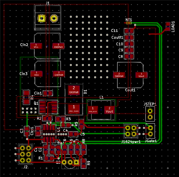

    Thanks Jon, that gave me some thought and I had a go at laying out the Switcher along the lines you've sketched.
    Hopefully that's clear enough.  This is with all the Switcher parts on the board.  Layer 2 is a GNDPWR layer across the board, and the top layer GND PWR copper stitches through.  The switching node is still small. but it feels like the loops (I've only drawn on the two main ones) are on the large side and it takes up a lot of real-estate - I can pull some elements in and I haven't shifted the locations, it was more to get an idea.  What I can do is:
    • Drop Cin2 as it was a placeholder for adding another large cap if testing indicated it might help.
    • Tradeoff the advice about 1-2cm apart for Cin and Cout to 1cm and bring the Cout caps much closer.
    Following further research, it suddenly clicked that the load is driven from Cout, and returns to Cout.  So what I have as Signal ground, on layer 3, can tie into GNDPWR where NT1 is (at the top).  It also clicked that the GNDPWR layer 2 I had - which we discussed - is, as you say, doing nothing, and should in fact be a ground plane for the switcher components - at least the high current ones.  So the layers now are:
    Top Layer: components, high current traces, signal traces
    Layer 2: GNDPWR plane which is stitched to the copper fills on the top layer and also tied to VIN -ve
    Layer 3: Signal Ground which the load components connect to and which is tied to GNDPWR where the net tie above is - by the Kelvin Sense traces
    Layer 4: Signal Traces
    This now makes a lot more sense - and is a lot clearer to me what was meant by a "shield ground".
    One of the recommendations I read, and which makes sense, is to keep the area under the inductor clear of traces and planes.  This obviously creates a hole in the ground layers: not such an issue for the Signal Ground but more so for the GNDPWR - the return loop for AC noise would follow the trace and have to flow around the Inductor which is less than ideal.  This layout also puts the Inductor smack centre of the board: I have a shielded component that will get no where near saturation (Isat is 84A) so as far as I can tell that shouldn't be an issue (and certainly the evaluation boards have the inductor in the middle!)  I would have to route that green signal trace further away but that's easy enough.
    I agree that the LT boards had copper for heat sinking the MOSFET.  I've had a go with the space available to me, which isn't much.  You can see the rows of vias by Q1 which route down to a copper fill on the bottom layer that extends back towards the top.  It may be something I can improve, however, my testing to date doesn't show the MOSFET getting particularly hot: see my test results in my first post.  Even after an hour with a 15V 5A load it had only reached 47C - and I calculated the power it was dissipating from that.  Obviously the MOSFET I have in this version is a SMD version with a much lower power dissipation spec but even de-rating to 150C it should be capable of handling that, unless I'm labouring under a misunderstanding on calculating this. As for the gate drive, and other specs, I think it's suitable, I looked for a logic level one - datasheet.  I can't see anything from the graphs that would indicate an issue but I'd be grateful if you could let me know before I make an expensive mistake!
    You asked for the source of the 1-2cm difference between Cin and Cout: https://micro.rohm.com/en/techweb/knowledge/dcdc/dcdc_pwm/dcdc_pwm03/4378.  There are quite a few recommendations if you follow some of the links.
    Thanks for taking the time to sketch that layout, I think it helps and I can work with it.
  • jc2048
    jc2048 over 7 years ago in reply to Andrew J
    I'd think about moving at least one or two of the ceramic output capacitors closer in than the electrolytic. They respond quicker than the electrolytic can (and in a sense define, for high frequencies, the extent of the loops either side of the switching node).
    It might be useful if you reviewed the input and output capacitors you've ended up with. Designed it from scratch rather than just accumulating parts from the other design; thinking about what each part does and how it needs to be sized. [Ignore the comments in the datasheet about only needing to look at the ESR - it's an old controller part and back then the only way you'd get the ESR figures they were after was with a larger electrolytic that would naturally also have a fairly large capacitance or with multiple parts where the capacitance would also add up. Capacitors have moved on since then - now you can meet their ESR requirements with a capacitor that won't have enough capacitance for the charge/discharge you want.] You certainly need enough capacitance that the switcher sustains itself nicely through the cycle and isn't forced to pull current through the ground connection or the scheme falls apart.
    I wouldn't have so many vias in the power ground area. If there's some inductance there it encourages the changes to stay on the top power ground. You obviously need enough to safely carry the current, but that's fairly low  - at worst it approaches the output current (3A) when the output voltage is at the low end of the range. You might consider a smaller group in the bottom right corner near the output capacitor ground.
    The Rohm stuff is very good. Clear examples and good explanations of why you're doing things.
    I'm not very sure about the 1-2cm thing - need to think about it a bit more. It does look like I've encouraged you to go too big with the top ground, though - I like areas of copper but tend to forget that it can go too far and start to cause problems rather than cure them.
    Not clear about the cutout under the coil. Is leakage from a hard ferrite, shielded inductor really enough to cause significant eddy currents underneath? The magnetic flux really, really wants to take the easy path in the core. The air gap - the place where there will be a little leakage - is normally a ring on the top surface, well out of the way. I can understand cutting-away for an open coil or a semi-shielded one, but I think you may be over-doing it here [feel free to correct me though].
    One interesting question is whether there is any value in cutting away plane under the switching node (in addition to keeping it as small in area as possible) in order to reduce the capacitative coupling to the layers below. If the node rings, then it might well be counter-productive, as the lessened capacitance would ring at a higher frequency which propages around more readily, but it might help reduce the spike noise running around.
  • Andrew J
    Don't sweat about the size of the grounding: what I did yesterday was as much an exercise in producing your sketch at scale with all the parts - to the recommendations I was working from - to see what it looks like.  Even I could see that something had to give in that ground area because I don't think the 20mm spacing is a worthwhile trade-off against the loop size.
    It's interesting what you say about positioning the MLCCs.  I'd specifically positioned the smallest one at 'the end', so to speak, to pick up any high-frequencies at the point the load and feedback traces connect.  I'd positioned the electrolytic closest as the one providing the bulk of the work but nothing more scientific than that.  I will take another look at the caps in general though.
    The micro-rohm stuff is good - although you may have noticed their Switcher IC in the images have perfectly positioned pins image  It really helped me understand what is going on with the switcher.  I've used their recommendations as well as some from a TI data sheet and the LT data sheet in placing things - you sketched a better alternative - but as I mentioned, it's hard to get consistent advice.  As for the hole and inductor spacing, again, there is no real clarity.  Coilcraft have this to say - my replacement inductor is a Coilcraft one - but to be honest, Würth and Bourns are no clearer:
    How much space should be allowed between components to counter interactions?
    It is not feasible for Coilcraft to recommend a specific minimum spacing between inductors. Electro-magnetic fields created by inductors generally only interact with metallic surfaces or other inductors in close proximity, however the extent of interaction between inductors depends on current (magnitude, waveform shape and frequency), orientation to each other as well as the distance between inductors. (Tip: Making sure to orient the axes of inductors perpendicular to each other, rather than parallel, helps to minimize interaction.)
    What's the advantage of using shielded parts?
    The purpose of magnetic shielding is to reduce the amount of magnetic flux generated outside the inductor, in turn reducing the likelihood of radiating energy to nearby components or circuit board traces causing electro-magnetic interference (EMI). Whether a shield is necessary depends on the proximity of other components and how field interaction would affect the performance of the circuit. Field interactions are quite challenging to model and measurement of the final circuit design is recommended. In addition to reducing radiated fields, magnetic shielding typically contributes to the inductance of the component, helping achieve more inductance per given size of inductor.
    and
    The effects of ground plane proximity depend on inductor geometry and test frequency, along with substrate thickness and dielectric constant. In many cases the effect is fairly small, but it can be significant in very tight-tolerance applications. The interaction of the magnetic field of an inductor with a metal ground plane is a complicated 3D E/M problem that requires careful measurement or simulation under specific application conditions. For this reason Coilcraft cannot quantify these effects in general.
    Because commitment is not fashionable!!  What I really take away from the above is that shielding does reduce radiated fields, not contain them, don't orientate your inductors in the same direction, don't put other components too close (whatever 'close' means in this context) and it may interact with the ground plane.  I haven't found any definitive sources yet but I'm still looking.  It would seem to be one of those "build a board and test it with expensive equipment" things or "I've done this before and in my experience...." things.  So in the lack of anything authoritative to the contrary, Micro-Rohm's advice seemed reasonable.  This would seem to be a trade-off between EM noise and return current ground bounce - what's likely to be worse, I don't know.  What I do know though is that I can do the too-obvious-I-didn't-think-of-it thing and look to see what TI, LT et al have done on their evaluation boards.
    It's an interesting thought about the plane under the switching node.  The only advice I've read in respect to ground planes and switchers is to  stretch it under the whole lot.  Which sort of implies the Inductor but as I say, there's a distinct lack of consistency!
    I still need to ask because I've a bee in my bonnet now you've mentioned it: I spent some time looking up what I think is a suitable MOSFET - Vgs(th), Gate Charge, Output capacitance, Power, RDs(on) and operation for a 5V gate drive etc.  I believe what I've chosen is suitable - certainly it's 3-legged TO220 seemed to serve in the current version (admittedly, with the noise I can't be definitive) - but now is the time to change it.  If there's anything I've missed then I'd appreciate the input.
    EDIT: it would seem consensus tends towards keeping the ground plane whole under a shielded inductor as benefits outweigh any negligible impacts of leakage.  See for example https://e2e.ti.com/support/power-management/f/196/t/538740?-DC-DC-Converter-Ground-plane-cut-below-power-inductor
