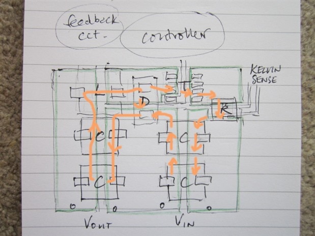

Two things became very clear to me once I got into the detailed testing of the project:
  • I have completely stuffed up the grounding and layout of the components.  In particular the Switching Regulator has a convoluted route back to Vin -ve and the route it does have takes it right under the sensitive components (until I bodged in a couple of wires).  Layout is too far apart for many components, including the bypass and decoupling caps, and non-conducive to managing noise.  There are no test points with the result that I have blown a number of components including 3 ports on the very expensive 4Duino.
  • I really didn’t have enough knowledge about DC-DC Switching Regulators - I sort of hinted at this in my design post - which becomes clear as you read the answers to some of the advice being given.  In some respects that might be a good thing as maybe I wouldn’t have started on this!  However, I apologise to those who have graciously helped out nonetheless and hopefully I've at least made a start in remedying that.
On the plus side, testing showed that functionally it works so I can get my 0-15V, 0-3A out.  I set about sorting out my understanding so that I could properly layout the board, but also have a much better understanding of how that part of the circuit is working so I can properly probe and test it.  There is excellent coverage of the subject from Micro-Rohm, starting with Switching Regulator Basics, that covers DC-DC switchers in some detail but at the same time keeps the language easy to follow.  There are also a multitude of papers from TI and Analog and the data sheets for buck converter ICs have been helpful - the LT1624 datasheet is still confusing though.
The design is still basically the same, with most changes to the Switching Circuit and Linear Regulator Circuit.

Ground Plane vs Star Ground
Before I get into the layers in more detail, I want to start off with this as it’s come up a bit in comments.   As I researched this it became clear that TI, Analog, Micro-Rohm and others all recommend ground plane; however I cannot also ignore Gene’s comments and advice, which comes from experience, to avoid these and use Star Ground.  So where does that leave me: I don’t yet have the experience of implementations (of both approaches) to determine which would be best nor can I make multiple boards with different configurations - the costs are just too high.
So, I have to make a decision and what I’ve gone with is the advice from TI, Analog, Micro-Rohm:
  • All high current ground traces are on the top layer except for two places where I had to go down to layer 2
  • Layer 2 is a Shield Ground which connects solely by the -Ve PCB terminal for Vin.  There are no other connections to this layer.  However, there are vias and through-holes plus the two high current traces that needed to be routed off the top layer.  There is also a Keep-Out underneath the Inductor (L1).
  • Layer 3 is a Signal Ground layer which connects solely by the -Ve PCB terminal for Vin.  There are no other traces on this layer but there are, obviously, connections for all low-current components.   There are also through-holes and vias and a Keep-Out underneath the Inductor (L1).
How does one avoid creating TH 'slots' (holes in a row) in these layers?  I have no idea.  Quite a few come from the test points I’ve incorporated: even using SMD points would require vias for the ground pins unless I avoided those.
I’ve avoided Thermal Vias as testing to date shows that’s not necessary and it would make more holes through the layers.

A summary of my questions:
  1. Would it be advisable to swap the MOSFET back to the TH version I used before which is more capable of dissipating power?
  2. Is the use of TH pins for the GND connection with my test points - so I can use the short GND wire on my probe - better than removing those holes through the planes?  Alternatives would be to use SMD test points with vias (smaller diameter) or doing away with GND test points and using the longer crocodile clipped GND wire.
  3. Layout guidance uses a lot of relative terms such as ‘close’ and ‘as possible’.  Is the trace from the Switching Regulator (U1) to the gate of the MOSFET (Q1) too long?
  4. The GND connections for the feedback circuit, Switching Regulator and the ITH/Run pins route around to connect to PWRGND just past the Output Capacitors (one piece of advice read.)  Would it be better to route these directly to the +ve and =ve pads of Cout1 - the 100uF output capacitor (another piece of advice read.)
  5. They don’t just connect to PWRGND just past the output capacitors, they also route under PWRGRND to do so: I could avoid doing that and connect at the point the trace jumps down.  Is it better to leave as-is?
  6. The PWRGND traces all route back on the top layer to the -Ve pin on VIN.  Very close to this point is the single connection for Shield Ground and Signal Ground.  Would it be better placing this nettie close to -Ve pin on Cout1?
  7. The Shield Ground is the full size of the board.  Should I just place this under the high-current routes or does it not make any difference?
  8. From experience, does this look hand-solderable if care is taken with the order of placement of components.
  9. I have no copper fills on the front or back layers.  If I added these and tied them to the nearest ground plane the vias would pass through all 4-layers.  Ultimately, I don’t know if it would improve anything so I didn’t bother as more holes in the layers seems ‘a worse thing’ but am I wrong?
I’d be very interested in thoughts and observations on my approach so I don’t make the same mistakes as last time.  In particular, given that grounding was a major issue in the current version, what’s your views on how I’ve done this time.

    jc2048 over 7 years ago
    So 'Z' grounds are good after all?

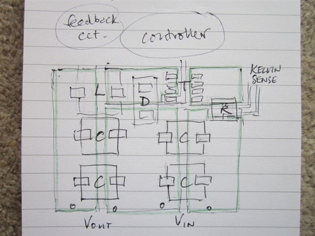

    I don't know if this will help the discussion, but I've drawn the switching currents for the regulator circuit on your layout in orange.
    This is my understanding of what's going on, but I'll just say I wasn't taught this stuff formally so don't rely on what I'm saying and feel free to question it. Like many engineers, I ended up having to deal with switching circuits but haven't gone much beyond using them as POL on digital boards and as LED drivers [in both situations you tend to follow recommended layouts and do a bit of extra filtering to get past EMC, and neither is as challenging as the more analogue-like thing you're trying for
    here]. This will sound like a lecture but believe me it isn't.
    The small 'dashed' arrows indicate where the switching currents switch on and off. The continuous stretches are where the current ramps up and down giving current ripple (assuming it's working in continuous mode). There are two loops corresponding to whether the MOSFET is on or off - remembering that the Schottky is also a switch (albeit not controlled directly by the controller) - a large loop and a small one. To keep the noise down, you need to minimise the inductance which you can do by minimising the area of the loop. You particularly need to try and minimize the inductance in the large loop you have here. You need to minimize the inductance because it's going to generate a voltage spike when the current abruptly stops [the parasitic inductance will get rid of its stored energy by generating an emf and coupling the energy elsewhere].
    The other major noise generator is the switching node which I've outlined in yellow. The voltage waveform there has an amplitude of the full supply voltage and is driven with a high current so the edges will readily capacitatively couple to anything it can develop a voltage field with. In your case that's mostly the 'shield' layer. I'm very unsure of the next bit, but I think that might result in charge mainly moving across the shield from/to the tie point [yellow line], so potentially there might be coupling back up in the area you've marked as feedback. I'm unsure because I can't really quantify it. The plane is metal and a low impedance but it takes time for the change to propagate across. The edge rate will be crucial to all this and given the reverse capacitance of the Schottky it probably can't move fast enough to give the kind of problem I'm envisioning. And now we have a current on the go - remember currents flow in loops - we need to think what is driving it and where does the return go on the top surface.
    The return presumably either flows through the power ground, 'through' the output capacitors, to the other end of the coil when it's that that's driving the change or to the input capacitors when the MOSFET is driving the change. You can see how convoluted this stuff gets and how you tie yourself in knots with it. Anyway, what you've done with the shield may be brilliant or it may be awful (but I'm not sure the input is the place to tie it).
    To be more practical, rather than analyse this to death, I'd suggest you might try alternative layouts on a piece of paper. You could probably manage something where the grounds of the input and output capacitors were much closer together and not at the extremes of a 'Z'.
  • Andrew J
    Andrew J over 7 years ago in reply to jc2048
    Thanks Jon - I would never read it as a ‘lecture’ so don’t worry, I get a lot out of your responses.  And if it helps, I’ve been cramming a lot on this and can tell you you’re right about the loops.  Almost image  There are three (blue) loops - Vin, Cin and Bypass - formed when the MOSFET is on, and one when it is off (Yellow.)  In retrospect, it would have been useful to have put these on originally.
    The trick, worthy of The Great Mephisto, is to keep ALL on and off loops as small an area as possible AND keep the switching node (your yellow loop) as small as possible AND have power components away from the sensitive circuits AND have the bypass cap butted up to the Regulator by its VIN and GND pins(!) AND keep the gate trace short AND connect the IC to PGND and SGND simultaneously AND AND AND….  At some point tradeoffs get made: notwithstanding The Great Mephisto, the trick I need to get right is to make the right tradeoffs and not the wrong ones!
    You’ll see from the above image I’m still playing with layout and I’ve been thinking about it all day whilst wandering around some dead person’s country pile.  However, one of the no-nos is to have Cout too close to Cin - there's that relative term again, but in this case close means 1-2 cm.  This is to prevent high-frequency noise passing through Cout into the output.  Having said that, my first thought to play with at the moment is to shift the test terminals, flip the inductor -90deg put the Cout Caps there and drag it all in somewhat - pretty much what you say about getting Cin and Cout closer together, but not too close!   Except no matter how I route it, those Ground traces are going to bend unless I route it down a layer and I was really trying hard to avoid that in the Switching Regulator part of the circuit.  You know, when you read this stuff and they image their recommended layout, the imaginary Regulator they choose to use to do so has the pins in precisely the right location to make it work!  Little @£$!$.
    However, what you have highlighted in particular, is the yellow stalk (or the green arrows on my image) - as a rhetorical side thought, is it reasonable to think the AC noise would follow under the forward trace back to the nettie, away from sensitive components, rather than head direct like DC?  Would it/could it couple back up a layer again into sensitive circuits (none are connected to that Shield layer)?  I’m still researching the Shield Ground (and grounding/layout in general for SMPS) as I’m still not sure what it is when it is referred to.  Actually, the real problem is, fundamentally, that there is ZERO consistency in approach recommendations by anyone, even TI have two different recommendations: ground traces on the top only and use a ground plane.  However the consistent message I do read and do understand but still have to constantly bang my head on the desk to get it to sink in is that currents will return to their source.  I’d put the Shield Ground in precisely to pick up capacitive, or otherwise coupled, noise (which is what I had interpreted it as ) and route it back out, again failing to bang my head on the desk long and hard enough that the source isn’t always the +Ve and -Ve terminals.  So any noise coupled to Shield Ground HAS to go to that net tie to get back to source (my green arrows): not dissimilar to one of the problems with my original design.
    I did laugh at the brilliant or awful comment though: and you’re right again - either there’s no noise on that layer and it doesn't matter or it’s bonkers and I’m back to square one.   Anyway, it needs sorting in case it is a problem.   I’m still researching and still think that  top level traces are a good recommendation but that Shield Ground needs tieing at different points.  Specifically, I’m looking into advisability (or not) of tieing it at the output capacitors and Schottky and Input capacitors although that will turn it into an actual ground plane which would negate the purpose of return traces on the top layer - which unsurprisingly is both for and against recommendation depending who one is reading!  Anyway, in summary, looking into making these pesky electrons go where I want them to rather than it being a galactic free for all on my board.  The Signal Ground is connected to components so it doesn’t matter so much that the nettie is at the power in terminals - I think, I’m still looking into tieing it in at Cout (least noisiest point in theory) - I just need to track and if necessary adjust the traces vs ‘slots’ on the bottom layer so there is a clear route to source.
  • jc2048
    jc2048 over 7 years ago in reply to Andrew J
    It's not easy. I still don't find grounding, shielding, and all this kind of thing straightforward. That's
    because you quickly move away from a schematic that shows simple topology [how things join together] to having to
    get your head around physical, 3D structures where you have to imagine the voltage fields or magnetic fields that
    exist because of the physicality of it and understand how charge distributes itself.
    I was actually focussing on it in an EMC kind of way - you look for the noise sources and then at how they might
    radiate (possible aerials) or conduct (paths to longish cables). So I was quickly taking you to the top of the
    list for noise sources. With EMC you think in terms of power, so a high current or a large voltage swing
    switching fast is an obvious candidate.
    There's EMC literature that's relevant to what you're doing and might help you, so you ought to consider reading
    more widely than just the applications stuff on switchers.
    As to Vin [and the output to the linear regulators and their input capacitors, which an extension to the output
    loop], you have to take a view as to how good a job you've made of the converter's input and output capacitors in
    terms of capacitance and ESR [and layout]. Ideally the switched circulating current doesn't come from the input,
    but only from the input capacitors, with the input current being more continuous, with the current either
    assisting the loop or recharging the capacitor. Of course that's a bit of a fiction, but it's what you should be
    trying for, even if you're going to fall short.

    Back to layout, here's how I would have initially sketched out a possible design if done on the top layer. Hope
    that's clear - the green lines outline the areas of copper.
    Here it is again with the current loops on it
    That minimises the loops fairly reasonably. It gets the controller and the feedback circuit out of the way. The
    gate drive and the Kelvin sense aren't too bad. Leaves an issue with the controller ground and where it ties in.
    If you had it on a board with planes, you could have a bunch of vias in the middle of the ground area to tie it
    down to the board ground planes - that then gives you a single-point ground for the converter's power.
    Aside: I think you can get sense resistors in a low inductance package (the connections will be to the long edges
    rather than the short ones). That might be worth looking at. Alternatively, you could have two in parallel to
    reduce the inductance a bit.

    Thanks Jon, that gave me some thought and I had a go at laying out the Switcher along the lines you've sketched.
    Hopefully that's clear enough.  This is with all the Switcher parts on the board.  Layer 2 is a GNDPWR layer across the board, and the top layer GND PWR copper stitches through.  The switching node is still small. but it feels like the loops (I've only drawn on the two main ones) are on the large side and it takes up a lot of real-estate - I can pull some elements in and I haven't shifted the locations, it was more to get an idea.  What I can do is:

    Thanks for taking the time to sketch that layout, I think it helps and I can work with it.

    I'd think about moving at least one or two of the ceramic output capacitors closer in than the electrolytic. They respond quicker than the electrolytic can (and in a sense define, for high frequencies, the extent of the loops either side of the switching node).
    It might be useful if you reviewed the input and output capacitors you've ended up with. Designed it from scratch rather than just accumulating parts from the other design; thinking about what each part does and how it needs to be sized. [Ignore the comments in the datasheet about only needing to look at the ESR - it's an old controller part and back then the only way you'd get the ESR figures they were after was with a larger electrolytic that would naturally also have a fairly large capacitance or with multiple parts where the capacitance would also add up. Capacitors have moved on since then - now you can meet their ESR requirements with a capacitor that won't have enough capacitance for the charge/discharge you want.] You certainly need enough capacitance that the switcher sustains itself nicely through the cycle and isn't forced to pull current through the ground connection or the scheme falls apart.
    I wouldn't have so many vias in the power ground area. If there's some inductance there it encourages the changes to stay on the top power ground. You obviously need enough to safely carry the current, but that's fairly low  - at worst it approaches the output current (3A) when the output voltage is at the low end of the range. You might consider a smaller group in the bottom right corner near the output capacitor ground.
    The Rohm stuff is very good. Clear examples and good explanations of why you're doing things.
    I'm not very sure about the 1-2cm thing - need to think about it a bit more. It does look like I've encouraged you to go too big with the top ground, though - I like areas of copper but tend to forget that it can go too far and start to cause problems rather than cure them.
    Not clear about the cutout under the coil. Is leakage from a hard ferrite, shielded inductor really enough to cause significant eddy currents underneath? The magnetic flux really, really wants to take the easy path in the core. The air gap - the place where there will be a little leakage - is normally a ring on the top surface, well out of the way. I can understand cutting-away for an open coil or a semi-shielded one, but I think you may be over-doing it here [feel free to correct me though].
    One interesting question is whether there is any value in cutting away plane under the switching node (in addition to keeping it as small in area as possible) in order to reduce the capacitative coupling to the layers below. If the node rings, then it might well be counter-productive, as the lessened capacitance would ring at a higher frequency which propages around more readily, but it might help reduce the spike noise running around.
