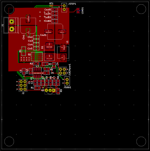

Two things became very clear to me once I got into the detailed testing of the project:
  • I have completely stuffed up the grounding and layout of the components.  In particular the Switching Regulator has a convoluted route back to Vin -ve and the route it does have takes it right under the sensitive components (until I bodged in a couple of wires).  Layout is too far apart for many components, including the bypass and decoupling caps, and non-conducive to managing noise.  There are no test points with the result that I have blown a number of components including 3 ports on the very expensive 4Duino.
  • I really didn’t have enough knowledge about DC-DC Switching Regulators - I sort of hinted at this in my design post - which becomes clear as you read the answers to some of the advice being given.  In some respects that might be a good thing as maybe I wouldn’t have started on this!  However, I apologise to those who have graciously helped out nonetheless and hopefully I've at least made a start in remedying that.
On the plus side, testing showed that functionally it works so I can get my 0-15V, 0-3A out.  I set about sorting out my understanding so that I could properly layout the board, but also have a much better understanding of how that part of the circuit is working so I can properly probe and test it.  There is excellent coverage of the subject from Micro-Rohm, starting with Switching Regulator Basics, that covers DC-DC switchers in some detail but at the same time keeps the language easy to follow.  There are also a multitude of papers from TI and Analog and the data sheets for buck converter ICs have been helpful - the LT1624 datasheet is still confusing though.
The design is still basically the same, with most changes to the Switching Circuit and Linear Regulator Circuit.
Switching Circuit
Essentially the same but with the following changes (annotated in red):
  1. Test points for the LTC1624 pins and output at the inductor
  2. A placeholder on the gate driver (pin TG) for a small resistor, R2, to adjust the rise time of the MOSFET to help counteract ringing if necessary.
  3. A placeholder for a boost resistor, R3, (pin BOOST) at the switching node to help with ringing there, if necessary.  Possibly a ferrite bead rather than resistor.
  4. A placeholder for a Snubber at the switching node, R5 and C9 ( to help with switching noise if necessary.
  5. A placeholder for a ceramic capacitor on Vout, C15, if I want to experiment with adjustments there.
  6. Upsized the sense resistor to a 1206/500mW part, same 10mOhm resistance.  Takes a bit more area but should be more resilient than the 0805, particularly as I’ve blown it up 3 times!  I’m mostly thinking of ease of replacement.
  7. Upsized the inductor to 50uH: the part I’ve chosen has better specs for resistance, self resonance frequency and saturation current than the original 10uH part (although in fairness, the other part’s specs should have been ok.)  LTSpice simulation shows that ripple on the output - and through the Feedback Circuit - is significantly improved.
  8. The MOSFET is now a SMD component - IRF8721 - with the same (slightly better) specs than the TO220 IRLB8721.
The main concern for the MOSFET was a power dissipation characteristic of only 2W.  I did some soak testing for temperature gain of the existing MOSFET and calculated wattage from that - see below.  The TO220 package doesn’t take up a lot more space than the SMD component (considering just the leg soldering area) but it is a lot more awkward to position and route to.  I did vacillate a bit on this as I know the existing part works : I’ve replaced the existing Mosfet 3 times - once when I blew it up, once when I swapped it for a better part, and once when I de-soldered it for testing when I thought I might have damaged it.
The resistor placeholders R2 and R3 will be populated with a 0 ohm (<5mOhms) resistors initially; R5 and C? will remain unpopulated.  Depending upon what I see during the testing I can populate one of more of these placeholders with actual resistors/ferrite beads and resistor and capacitor in the case of the Snubber.  My understanding is that care is needed with changing the MOSFET timing (BOOST and Gate resistors) as it will increase the switching losses.
MOSFET Temperature Soak Testing
I ran the existing circuit at a range of volts and amps for an hour - 50 mins with the 5Ohm load as I had to leave to do something else and didn’t want to leave it unattended - and captured temperatures at 10 min intervals.  I took the peak temperature for the IRLB8721 MOSFET and using the original Ambient Temperature and the MOSFET’s Tja specification, calculated the power from the temperature rise (temp diff / Tja).  Even in the worst case temperature rise, power dissipation was 0.333mW, well within the replacement's power dissipation rating even after de-rating to 150C.
I’d be very interested to hear feedback on this.  I could switch it back to the TO220 package before I get the board made if I’ve messed up the calculations.

PCB
Hopefully the images I've pasted are viewable but I've attached the Gerbers as well.  With the layout needed, I've gone with a 4-layer board to achieve it - it's a bit more expensive but for the sake of £20-ish it feels worth it given the difficulty of trying to do this with 2-layers, at least that's how I perceive it.  It's also resulted in a slightly larger board at 100mm x 95mm (current version is 100mm x 75mm.)
Layer Stack
Top: components, high current traces, high current ground traces, signal traces
Layer 2: Shield Ground
Layer 3: Signal Ground
Bottom: Signal traces

Ground Plane vs Star Ground
Before I get into the layers in more detail, I want to start off with this as it’s come up a bit in comments.   As I researched this it became clear that TI, Analog, Micro-Rohm and others all recommend ground plane; however I cannot also ignore Gene’s comments and advice, which comes from experience, to avoid these and use Star Ground.  So where does that leave me: I don’t yet have the experience of implementations (of both approaches) to determine which would be best nor can I make multiple boards with different configurations - the costs are just too high.
So, I have to make a decision and what I’ve gone with is the advice from TI, Analog, Micro-Rohm:
  • All high current ground traces are on the top layer except for two places where I had to go down to layer 2
  • Layer 2 is a Shield Ground which connects solely by the -Ve PCB terminal for Vin.  There are no other connections to this layer.  However, there are vias and through-holes plus the two high current traces that needed to be routed off the top layer.  There is also a Keep-Out underneath the Inductor (L1).
  • Layer 3 is a Signal Ground layer which connects solely by the -Ve PCB terminal for Vin.  There are no other traces on this layer but there are, obviously, connections for all low-current components.   There are also through-holes and vias and a Keep-Out underneath the Inductor (L1).
How does one avoid creating TH 'slots' (holes in a row) in these layers?  I have no idea.  Quite a few come from the test points I’ve incorporated: even using SMD points would require vias for the ground pins unless I avoided those.
I’ve avoided Thermal Vias as testing to date shows that’s not necessary and it would make more holes through the layers.
Check list
Now I have a better understanding of the Switching Regulator, I’ve been able to take a better understanding of layout practices from my reading of data sheet layouts from TI and LT (Analog) as well as the explanation and points presented by Micro-Rohm:
  • Keep the bypass capacitor (Cby1) as close to VDD of the switching regulator as possible.  TICK
  • Keep the loop consisting of Input Cap (Cin1), Sense Resistor (R4), Mosfet (Q1), Schottky Diode (D1) as short as possible.  TICK
  • Keep the loop consisting of Schottky Diode (D1), Inductor (L1) and Output Cap (Cout1) as small as possible.  TICK
  • Traces carrying high currents off the ground plane and away from the sensitive feedback circuit.  TICK
  • Keep the Switching Node - SW pin, D1, L1 and Q1 Source small.  TICK.
  • Use kelvin connections from the feedback circuit connected just after the Output Capacitors.  Vfb should connect directly to the resistors.  TICK
  • Feedback circuit should be connected to the + plate of Output capacitor.  TICK - actually, there are more than one output capacitor and it connects just after the last one as per TI advice.
  • Keep the connections from feedback resistors to the Vfb pin (R6 and R7 - and really also Q2) short and away from the Switching Node.  TICK
  • Gate drive trace should be as close as possible to the Mosfet (Q1) gate.  TICK.  in my opinion - given ‘close’ is relative and I can’t physically get the larger parts any closer!  Part manufacturers don’t help with their pin layout either.
  • Signal and Power Grounds separated.  TICK
  • Does the input capacitor (Cin1) +ve connect to Sense Resistor (R4) as closely as possible. TICK
  • Does Cin1 connect as close as possible to GND pin of Switching Regulator.  TICK - in as much as this makes zero sense as their grounds are meant to be kept seperate!
  • Is ground of Cin1 and Cout1 separated by at least 1-2cm. TICK
  • Is the Inductor (L1) close as possible to the Switching Regulator.  TICK
  • Is the wiring to the Inductor input as small as possible.  Is the wiring distance between the Inductor terminals as great as possible. TICK
  • Are there no ground or signal traces under the Inductor.  Is the Ground Plane kept from underneath the inductor. TICK
  • Are the Inductor and Output Capacitor (Cout1) as close as possible.  TICK
  • Signal and Power Grounds must be kept separate.  TICK
  • Top Layer Power Grounds and Inner Layer Power Grounds must be connected by numerous vias.  TICK (there are only two places where I have routed Power Ground to the inner layer.)
  • Power Ground should be connected to a common ground or signal ground near an Output Capacitor.  NO TICK - grounds and ground planes are connected at one point only near the Power in terminal, based on discussions/advice here.  I believe this point is based on the grounds for the Switching Regulator only, not the 'load circuit' - I have done that with the feedback circuit and IC GND connections.
Quite a substantial checklist but I think I’ve hit them all including the last point.  The grounds are tied at the -Ve pin for VIn but in Kicad I can only do this with a Net tie component - it’s not possible to specify a pin or pad as belonging to multiple nets.  You can see the Net tie in the PCB top layer by the -Ve pin of the PCB terminal.  I think this is ok - any noise from power ground that hits the Shield Ground would route out here.

Summary
I think I’ve made a much better job of laying out and routing the design this time.  The first version was so bad it wasn’t even worth trying to start dealing with the sources of noise but my hope is this will prove capable of proper measurement and action: the placeholders for ferrite beads/capacitors/resistors can at least allow some modifications to be made as a result and the test points will prevent me blowing components up.  I'm more than happy to provide additional information if anyone is interested.
A summary of my questions:
  1. Would it be advisable to swap the MOSFET back to the TH version I used before which is more capable of dissipating power?
  2. Is the use of TH pins for the GND connection with my test points - so I can use the short GND wire on my probe - better than removing those holes through the planes?  Alternatives would be to use SMD test points with vias (smaller diameter) or doing away with GND test points and using the longer crocodile clipped GND wire.
  3. Layout guidance uses a lot of relative terms such as ‘close’ and ‘as possible’.  Is the trace from the Switching Regulator (U1) to the gate of the MOSFET (Q1) too long?
  4. The GND connections for the feedback circuit, Switching Regulator and the ITH/Run pins route around to connect to PWRGND just past the Output Capacitors (one piece of advice read.)  Would it be better to route these directly to the +ve and =ve pads of Cout1 - the 100uF output capacitor (another piece of advice read.)
  5. They don’t just connect to PWRGND just past the output capacitors, they also route under PWRGRND to do so: I could avoid doing that and connect at the point the trace jumps down.  Is it better to leave as-is?
  6. The PWRGND traces all route back on the top layer to the -Ve pin on VIN.  Very close to this point is the single connection for Shield Ground and Signal Ground.  Would it be better placing this nettie close to -Ve pin on Cout1?
  7. The Shield Ground is the full size of the board.  Should I just place this under the high-current routes or does it not make any difference?
  8. From experience, does this look hand-solderable if care is taken with the order of placement of components.
  9. I have no copper fills on the front or back layers.  If I added these and tied them to the nearest ground plane the vias would pass through all 4-layers.  Ultimately, I don’t know if it would improve anything so I didn’t bother as more holes in the layers seems ‘a worse thing’ but am I wrong?
I’d be very interested in thoughts and observations on my approach so I don’t make the same mistakes as last time.  In particular, given that grounding was a major issue in the current version, what’s your views on how I’ve done this time.

    shabaz over 7 years ago in reply to Andrew J +4
    Hi Andrew, Given the tip size and iron rating, your settings are in the right ballpark for SOIC.. maybe the temperature can be raised slightly. I too use a ~1mm tip, and set to 330 degrees C, for 2 or…
  • Andrew J
    Andrew J over 7 years ago in reply to shabaz +4
    Thanks - I'll give it some thought along with what I'm going to do. At the moment, it's not going well enough for those to help I have the circuit re-assembled and I can now get 15V /1.5A with the 10Ohm…
    Hi Andrew, I think they could all be related to one issue perhaps, because things like the linear regulators should be behaving identically, since it's the same circuit for each of them, just paralleled…
  • jc2048
    jc2048 over 7 years ago in reply to Andrew J
    MOSFET looks ok to me. The maximum Vds is 30V, so not as high as the max Vin of the controller (don't forget that, if you are varying the input voltage during your testing).
    Dissipation will be worse when you slow it down to reduce the edge rate. You ought to be able to get an idea from your simulation.
    You might also want to have a quick look at the dissipation of the snubber resistor and whether the package you've chosen can meet that. The conduction is only a small part of the cycle but the power whilst it's doing so could be high to get the effect you want, so the average figure may be higher than a small SMD package will manage.

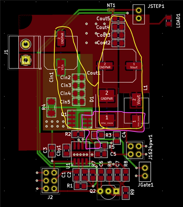

  • Andrew J
    This is it, I'm committing to this layout of the Switching circuit, otherwise I'll tweak it forever.
    I've pulled components in but kept some distance between the Cin1 an Cout1 - although the only reference to this distance came from Micro Rohm and I could find no other mentions.  Feedback traces are away from the noisy nodes.  The parts have an orientation and a distance that will allow for hand-soldering.  Hence the thermal reliefs (I'm still looking at the pros/cons of hand-soldering without these.) Board real estate also looks optimal.
    Here's a version with loops and SW node highlighted:
    In all the permutations of layout, this looks like the best trade off.  SW node is small.  The right hand loop is 37mm long; left one a few mm shorter.  My first attempt probably had a shorter right hand loop equivalent but a longer left hand loop: looking at the grid in that image at 5mm steps there's little in it.  The only thing I can do to tighten it further is to remove R2, R3, R5 and C5 which are there as placeholders if needed to help deal with ringing and noise.  R2 and R3 will be populated with a 0 ohm resistor (<5mOhm).  R5 and C5 will be left unpopulated until, and if, needed.
    I can't get any more thermal relief for the MOSFET but all my calculations, and re-calculations, show this won't be an issue - my last set showed it getting to 37C from a 25C ambient and empirical evidence from soak testing is showing 46-47C after an hour.
    Not shown is the GNDPWR plane on layer 2 which extends across the board - the vias that seem to go nowhere, go there.  Switcher GND, ITH/Run, FB pins connect to GNDPWR at NT1 which is where SIGNAL GND will connect (layer 3.)
    Thanks again for all the input.

    Andrew J over 7 years ago in reply to jc2048
    Don't sweat about the size of the grounding: what I did yesterday was as much an exercise in producing your sketch at scale with all the parts - to the recommendations I was working from - to see what it looks like.  Even I could see that something had to give in that ground area because I don't think the 20mm spacing is a worthwhile trade-off against the loop size.
    It's interesting what you say about positioning the MLCCs.  I'd specifically positioned the smallest one at 'the end', so to speak, to pick up any high-frequencies at the point the load and feedback traces connect.  I'd positioned the electrolytic closest as the one providing the bulk of the work but nothing more scientific than that.  I will take another look at the caps in general though.
    The micro-rohm stuff is good - although you may have noticed their Switcher IC in the images have perfectly positioned pins image  It really helped me understand what is going on with the switcher.  I've used their recommendations as well as some from a TI data sheet and the LT data sheet in placing things - you sketched a better alternative - but as I mentioned, it's hard to get consistent advice.  As for the hole and inductor spacing, again, there is no real clarity.  Coilcraft have this to say - my replacement inductor is a Coilcraft one - but to be honest, Würth and Bourns are no clearer:
    How much space should be allowed between components to counter interactions?
    It is not feasible for Coilcraft to recommend a specific minimum spacing between inductors. Electro-magnetic fields created by inductors generally only interact with metallic surfaces or other inductors in close proximity, however the extent of interaction between inductors depends on current (magnitude, waveform shape and frequency), orientation to each other as well as the distance between inductors. (Tip: Making sure to orient the axes of inductors perpendicular to each other, rather than parallel, helps to minimize interaction.)
    What's the advantage of using shielded parts?
    The purpose of magnetic shielding is to reduce the amount of magnetic flux generated outside the inductor, in turn reducing the likelihood of radiating energy to nearby components or circuit board traces causing electro-magnetic interference (EMI). Whether a shield is necessary depends on the proximity of other components and how field interaction would affect the performance of the circuit. Field interactions are quite challenging to model and measurement of the final circuit design is recommended. In addition to reducing radiated fields, magnetic shielding typically contributes to the inductance of the component, helping achieve more inductance per given size of inductor.
    and
    The effects of ground plane proximity depend on inductor geometry and test frequency, along with substrate thickness and dielectric constant. In many cases the effect is fairly small, but it can be significant in very tight-tolerance applications. The interaction of the magnetic field of an inductor with a metal ground plane is a complicated 3D E/M problem that requires careful measurement or simulation under specific application conditions. For this reason Coilcraft cannot quantify these effects in general.
    Because commitment is not fashionable!!  What I really take away from the above is that shielding does reduce radiated fields, not contain them, don't orientate your inductors in the same direction, don't put other components too close (whatever 'close' means in this context) and it may interact with the ground plane.  I haven't found any definitive sources yet but I'm still looking.  It would seem to be one of those "build a board and test it with expensive equipment" things or "I've done this before and in my experience...." things.  So in the lack of anything authoritative to the contrary, Micro-Rohm's advice seemed reasonable.  This would seem to be a trade-off between EM noise and return current ground bounce - what's likely to be worse, I don't know.  What I do know though is that I can do the too-obvious-I-didn't-think-of-it thing and look to see what TI, LT et al have done on their evaluation boards.
    It's an interesting thought about the plane under the switching node.  The only advice I've read in respect to ground planes and switchers is to  stretch it under the whole lot.  Which sort of implies the Inductor but as I say, there's a distinct lack of consistency!
    I still need to ask because I've a bee in my bonnet now you've mentioned it: I spent some time looking up what I think is a suitable MOSFET - Vgs(th), Gate Charge, Output capacitance, Power, RDs(on) and operation for a 5V gate drive etc.  I believe what I've chosen is suitable - certainly it's 3-legged TO220 seemed to serve in the current version (admittedly, with the noise I can't be definitive) - but now is the time to change it.  If there's anything I've missed then I'd appreciate the input.
    EDIT: it would seem consensus tends towards keeping the ground plane whole under a shielded inductor as benefits outweigh any negligible impacts of leakage.  See for example https://e2e.ti.com/support/power-management/f/196/t/538740?-DC-DC-Converter-Ground-plane-cut-below-power-inductor
  • jc2048
    I'd think about moving at least one or two of the ceramic output capacitors closer in than the electrolytic. They respond quicker than the electrolytic can (and in a sense define, for high frequencies, the extent of the loops either side of the switching node).
    It might be useful if you reviewed the input and output capacitors you've ended up with. Designed it from scratch rather than just accumulating parts from the other design; thinking about what each part does and how it needs to be sized. [Ignore the comments in the datasheet about only needing to look at the ESR - it's an old controller part and back then the only way you'd get the ESR figures they were after was with a larger electrolytic that would naturally also have a fairly large capacitance or with multiple parts where the capacitance would also add up. Capacitors have moved on since then - now you can meet their ESR requirements with a capacitor that won't have enough capacitance for the charge/discharge you want.] You certainly need enough capacitance that the switcher sustains itself nicely through the cycle and isn't forced to pull current through the ground connection or the scheme falls apart.
    I wouldn't have so many vias in the power ground area. If there's some inductance there it encourages the changes to stay on the top power ground. You obviously need enough to safely carry the current, but that's fairly low  - at worst it approaches the output current (3A) when the output voltage is at the low end of the range. You might consider a smaller group in the bottom right corner near the output capacitor ground.
    The Rohm stuff is very good. Clear examples and good explanations of why you're doing things.
    I'm not very sure about the 1-2cm thing - need to think about it a bit more. It does look like I've encouraged you to go too big with the top ground, though - I like areas of copper but tend to forget that it can go too far and start to cause problems rather than cure them.
    Not clear about the cutout under the coil. Is leakage from a hard ferrite, shielded inductor really enough to cause significant eddy currents underneath? The magnetic flux really, really wants to take the easy path in the core. The air gap - the place where there will be a little leakage - is normally a ring on the top surface, well out of the way. I can understand cutting-away for an open coil or a semi-shielded one, but I think you may be over-doing it here [feel free to correct me though].

    Thanks Jon, that gave me some thought and I had a go at laying out the Switcher along the lines you've sketched.
    Hopefully that's clear enough.  This is with all the Switcher parts on the board.  Layer 2 is a GNDPWR layer across the board, and the top layer GND PWR copper stitches through.  The switching node is still small. but it feels like the loops (I've only drawn on the two main ones) are on the large side and it takes up a lot of real-estate - I can pull some elements in and I haven't shifted the locations, it was more to get an idea.  What I can do is:
    • Drop Cin2 as it was a placeholder for adding another large cap if testing indicated it might help.
    • Tradeoff the advice about 1-2cm apart for Cin and Cout to 1cm and bring the Cout caps much closer.
    Following further research, it suddenly clicked that the load is driven from Cout, and returns to Cout.  So what I have as Signal ground, on layer 3, can tie into GNDPWR where NT1 is (at the top).  It also clicked that the GNDPWR layer 2 I had - which we discussed - is, as you say, doing nothing, and should in fact be a ground plane for the switcher components - at least the high current ones.  So the layers now are:
    Top Layer: components, high current traces, signal traces
    Layer 2: GNDPWR plane which is stitched to the copper fills on the top layer and also tied to VIN -ve
    Layer 3: Signal Ground which the load components connect to and which is tied to GNDPWR where the net tie above is - by the Kelvin Sense traces
    Layer 4: Signal Traces
    This now makes a lot more sense - and is a lot clearer to me what was meant by a "shield ground".
    One of the recommendations I read, and which makes sense, is to keep the area under the inductor clear of traces and planes.  This obviously creates a hole in the ground layers: not such an issue for the Signal Ground but more so for the GNDPWR - the return loop for AC noise would follow the trace and have to flow around the Inductor which is less than ideal.  This layout also puts the Inductor smack centre of the board: I have a shielded component that will get no where near saturation (Isat is 84A) so as far as I can tell that shouldn't be an issue (and certainly the evaluation boards have the inductor in the middle!)  I would have to route that green signal trace further away but that's easy enough.
    I agree that the LT boards had copper for heat sinking the MOSFET.  I've had a go with the space available to me, which isn't much.  You can see the rows of vias by Q1 which route down to a copper fill on the bottom layer that extends back towards the top.  It may be something I can improve, however, my testing to date doesn't show the MOSFET getting particularly hot: see my test results in my first post.  Even after an hour with a 15V 5A load it had only reached 47C - and I calculated the power it was dissipating from that.  Obviously the MOSFET I have in this version is a SMD version with a much lower power dissipation spec but even de-rating to 150C it should be capable of handling that, unless I'm labouring under a misunderstanding on calculating this. As for the gate drive, and other specs, I think it's suitable, I looked for a logic level one - datasheet.  I can't see anything from the graphs that would indicate an issue but I'd be grateful if you could let me know before I make an expensive mistake!
    You asked for the source of the 1-2cm difference between Cin and Cout: https://micro.rohm.com/en/techweb/knowledge/dcdc/dcdc_pwm/dcdc_pwm03/4378.  There are quite a few recommendations if you follow some of the links.
    Thanks for taking the time to sketch that layout, I think it helps and I can work with it.
