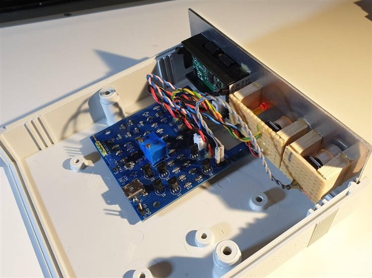

    shabaz over 6 years ago in reply to fmilburn
    Hi Frank,
    I thought you might want to see your V1.3 project design part-assembled : )
    The assembly is still a work-in-progress, I still need to drill the socket locations at the back, and figure out the power supply (I'm going with in-built battery). A low-supply indicator would be nice but I might assemble that on a separate PCB sometime (or probably that exists as an adafruit/sparkfun type module, it sounds like the type of thing that may already exist)..
    I permanently glued the PCB into position, since I can easily fix things from the top, there are no components on the underside of the PCB anyway.
    Anyway, construction was straightforward as expected!

    fmilburn over 6 years ago in reply to shabaz
    That looks really nice. One of the nice things about the PCB is that it is small and allows about any case to be used.  Your layout is really neat and tidy.

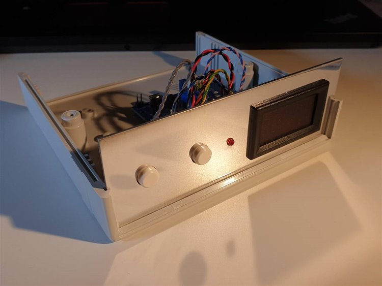

    Thanks! : )
    Experimented with labeling today:
    I had a low-cost (£50 in the UK) handheld label printer (Brother PT-E300) and I'd been using opaque label tape for ages. However, it turns out that transparent labels exist for it too. I cut them with scissors around the box shape that can be printed. And, since it's transparent, I could put the label on top of the LED hole.
