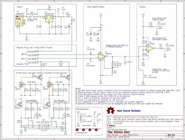

Revised Schematic
The revised schematic is shown below:
The added current source is identical to the first but designed for 1 mA current.  A dual N-Channel MOSFET with pull-down resistors is connected just above ground to allow selection of a source.  It will add maybe an ohm to ground.  There are jumpers and bypass resistors so that the second current source and MOSFETs can be omitted if desired.  This has not been incorporated into the working prototype so a second eye and comments on the design are welcome.  An additional 5V set of pins was added so a source other than the USB connection could be used as well.  Thanks for ideas and suggestions shabaz  image.

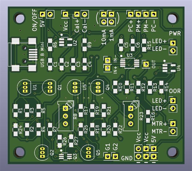

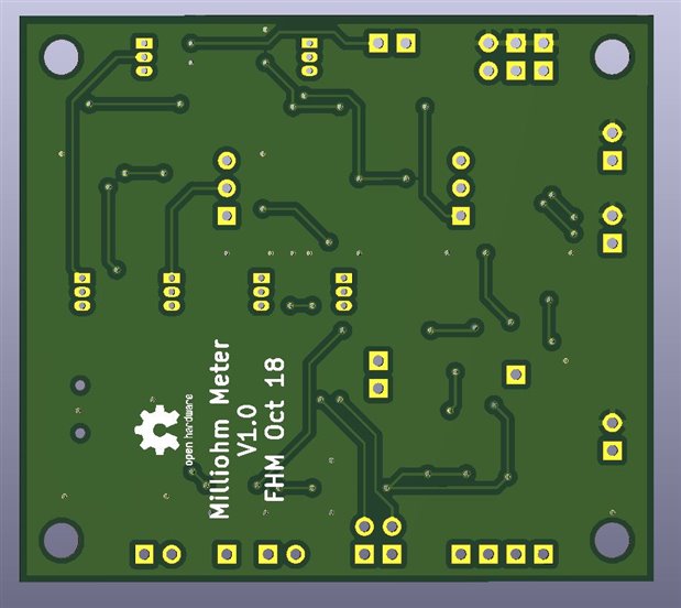

PCB Design
The PCB was done in KiCad (5.0.0) which is a new version for me and I am still finding my way around the changes.  The layout was done with ease of hand soldering in mind which led to what I consider poor routing so I may redo it and hope send it to the board house tomorrow.  There were a couple of unfinished wires when the renders below were made but those are finished now and it passes electrical check.

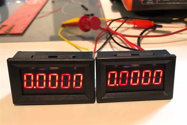

The panel meter I ordered from China came in earlier in the week but they were a disappointment.  Although they advertised 5 digit resolution they are not much better than 3 and show zero when down in the low millivolt range so they aren't much use for this project.  There is a zeroing procedure which I tried without much luck and a small pot which doesn't seem to do much.  I also ordered a ammeter but haven't had a chance to really test it.  It looks like I will be using patch cables and a multimeter for the display.

    Hi Shabaz, From you description, it looks like I ordered the wrong meter... Could also have a particularly bad sample. I spent a fair amount of time trying to calibrate it again this evening without luck…
    shabaz over 7 years ago in reply to fmilburn +7
    Hi Frank, Some good news, and some uncertainty : ) The good news is that it is assembled, it was a breeze using the PCB. Also it is just the right size for the enclosure, it all fits hopefully : ) I've…
    shabaz over 7 years ago +6
    Hi Frank, Sorry to hear the panel meters were no good : ( I'll check the ones I have, in case any function better. (By the way from the back of it, if there is a 5 or 6-pin SOT-23, that should have been…

    I started building this tonight : )
    I've soldered all the resistors and pots, and then trimmed to the desired resistance.
    Hopefully tomorrow I'll get the rest all soldered up, and try powering it up before putting it in the case!
    Hi Frank,
    Problem solved (I think) : )
    Somewhere along the line the tolerance of the LM334 was missed, we probably both assumed it was absorbed into the calculations once we'd created the spreadsheets, or that it would be trimmed out by the existing trimmer circuit, and didn't examine the datasheet again. But, although it is stable, it might not be at 10mA. Although it can be adjusted out, really two resistances need to be trimmed for 10mA, and two for 1mA, otherwise the temperature compensation will get affected : (
    Here's an alternative suggestion, and it seems to work.. basically, instead of trimming current to 10mA, the gain of the amplifier could be trimmed instead. I think we don't need the current source trimmers at all, since it seems to be stable with no adjustment. So, no more trimmers are needed, but they are instead used for amplifier gain adjustment (plus this is better for the future too, since if it is ever modified for ADC, then zero trimmers are needed since the measured value can be multiplied by the microcontroller).
    Since there are two ranges, that means that amplifier trimming also needs to be switched along with the range. But that's ok, it is possible to do it with a normal DPDT switch with one pole selecting the current source, and the other pole switching in the second trimmer. It means the second current source should be changed from 1mA nominal, to (say) 1.1mA, because then it's easier to have such a trimming mechanism without more switch poles.
    The mod below shows the idea.. the 20k trimmer is used to adjust the reading for the 10mA current source. Then, the switch (one half of the DPDT switch) is closed, and the 500k trimmer is used to adjust for the 1.1mA current source. The values were chosen so that a +-3% gain adjustment can be made via the trimmers, for both ranges. The 10mA gain adjustment has to be trimmed first with this topology, since the 20k trimmer is never switched out. The 500k trimmer will work regardless if the 20k trimmer is set at any extreme, if the current source is designed for 1.1mA +-3%.
    I don't have a 500k trimmer, so I just tested the 20k trimmer, and the measurements are spot on for 116mohm, and 14mohm (these are the only two values I tested so far) with sub-milliohm error. Since both of my current sources have approximately the same proportion error, I actually don't need the 500k trimmer switched in if I keep the second current source at 1mA instead of 1.1mA, but that can't be assumed for all builds of course!
    This is what my build looks like currently, i.e. just the 20k trimmer mod, and no switching since the error adjustment happens to be the same across both ranges:
    Maybe for the rev 2 PCB, as well as these new amplifier trimmers, the existing trimmer locations are kept, but are set to do-not-fit for now, since all seems stable without them.
    Here are the values for the 10mA and 1.1mA current sources:
    10mA: use -1.85mV/degC and Vf=0.7199
    top resistor network to equal 17.7931ohm, which is 33.2 ohm paralleled with 38.3 ohm
    lower resistor network to equal 127.2167 ohms which is 160 ohm in parallel with 620 ohm
    1.1mA: use -2.01mV/degC and Vf=0.660V
    top resistor network to equal 145.8354ohm which is three resistors, 150 ohm, 5.6k and 82k all in parallel
    lower resistor network to equal 1145.483 ohms which is 1.33k in paralled with 8.2k
    With the current schematic, R7 and R22 and trimmers R8 and R23 would become DNP.
    I'm going to box it all up now, see if it still functions : )

    fmilburn over 7 years ago in reply to shabaz
    Hi Shabaz,
    That is very clever!  I am more committed than ever to a new revision.  It needs to be something that even John Wiltrout would be proud to put on his bench :-)
    I suspect you are correct on the issue and on looking back at the datasheet I am sure I did not appreciate it at the time and was thinking it could be corrected with the trim pots (in fact it was very close on the protoboard and easily trimmed). Since we are rethinking, I have a couple of thoughts...
    • Will this create a tempco issue at the instrument amp?  I need to work through this.
    • Is tempco really an issue?  If it is calibrated at say 25 C will the temperature change by more than say 10 C which should be OK?
    • Can the scale switching problem be easily solved - i.e. having to scale by factor of 100 in ohm range - this point was CORREcTED for earlier brain freeze
    • Can the comparator switch a MOSFET for automatic range setting?
    I see there is still room for a larger board in your enclosure (which I would like to use).  The next version could have:
    • proper mounting holes that match the enclosure.
    • Would ~6 V battery power / holder fit in the case?
    • What about including a 1 ohm calibration resistor into the design with a jumper
    Mostly just thinking out loud...
    Frank
