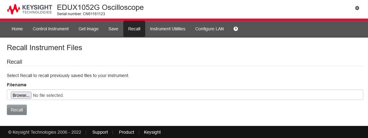

Recall allows for the upload of settings files.

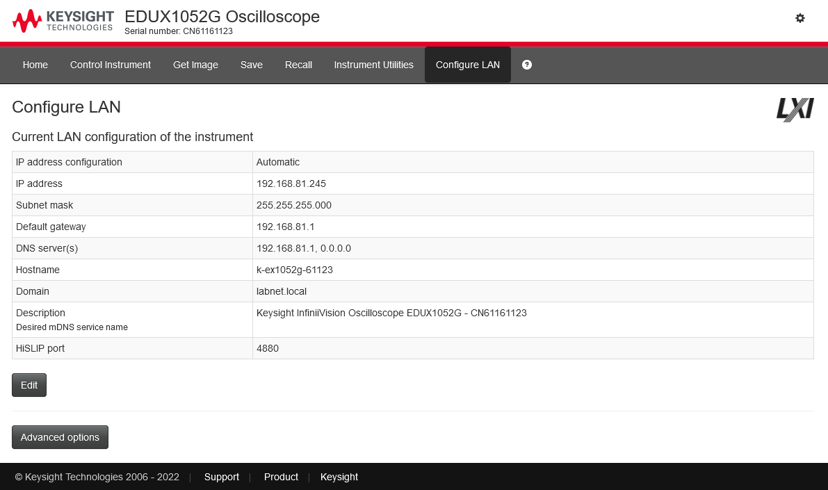

Finally, the Configure LAN option allows for setting Ethernet configuration.

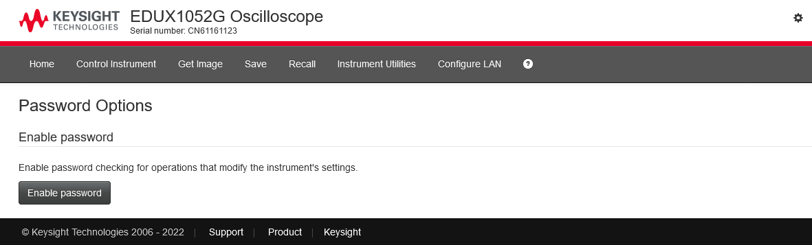

By default, no password is set on the remote interface, however, this can be set. Furthermore, there is also a context-sensitive help pop-up window which is available and provides basic tips.
In all, the browser-based web interface of the EDUX1052G is quite functional, even if the remote front-panel performance does leave a little to be desired.
