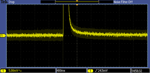

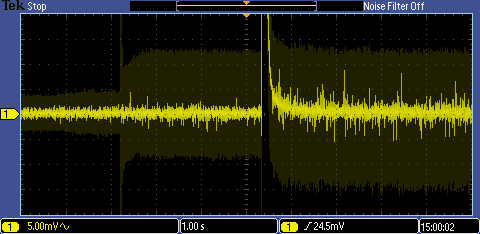

    You got me curious as to what I would see with a couple of my own power supplies.
    I had a look at the output of a cheap linear bench supply, GW INSTEK GPS-30300 [usual kind of thing: transistors and opamps, with a pair of 2N3055s for the hard work], and it looks like this. This is x1 with a 20MHz bandwidth limit. To the left, the PSU is off, to the right it's on. No real difference, so any noise from the PSU circuitry is getting lost within the 5mV pk/pk that we see there.
    I'm using a 50ohm coax lead with a terminator at the scope, but it does have croc clips at the PSU end with about 2 inches of unshielded wire. With the scope set to the input GND position, I see about 2mV pk/pk of noise, so the rest is either pickup at the end of the leads, or what is coming through from the mains at the PSU (or maybe the scope end).
    So this one is a bit of a challenge to measure properly using the test equipment that I've got. (Preamp maybe?)

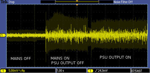

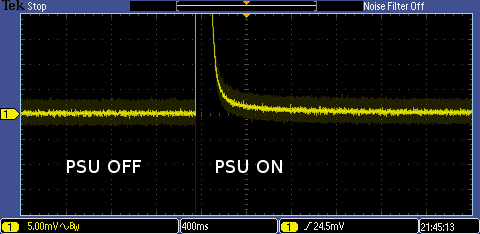

    For comparison, here's a switching supply (Maplin N93CX). This has an output switch. You can see just before the mains goes on it gets slightly quieter - that's my hand moving close to the case. The PSU output control might be electronic - the switch doesn't maintain its state (it always starts up in the off state) and I can't hear a relay clicking. With this supply, the circuitry is definitely contributing to the output noise.
    Not all that rigorous, but it shows the difference between the two. I might try and rig up a transient test later to see if that mirrors what you were seeing.
    Both cases were at an output of 5V with a light load of 10 ohms (0.5A).
