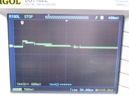

The experiment will look at the ripple of each supply with no load and with full load. Each supply will also be tested and compared to see how it reacts to a load as well as how it reacts to the removal of a load. The test parameters will be 10 volts from channel one of each supply. The load will be an automotive brake light which has a beginning resistance of approximately 0.8 Ohm and an operating resistance of approximately 5.7 Ohms. The low beginning resistance of the bulb will serve to highlight the ability of the power supply to respond to a high current load.
The test instrument is a Rigol DS 1102E DSO.
Here is a layout of the test rig wiring.
I have set up the rig so that both power supplies are switched to their loads simultaneously. One of the weak spots of this experiment is my assumption that the two load bulbs that I will be using are identical. This may not be true in the strictest sense but they will be close enough for the tolerance of this experiment.
Our first test will be to look at supply ripple without and with the load bulbs in the circuit. As a convention when displaying comparisons I will display the Commercial Supply first followed by the Linear Supply and then the Switching Supply. First however let's look at the base line noise on the scope. This is 32 mV PP with the scope probe shorted to its ground wire.
The No Load Trace of the three power supplies is as follows:
The Commercial Supply has 56 mV PP, the Linear Supply has 60 mV PP and the Switching Supply has 40 mV.
1.75 Amp load on each supply gave the following results:
The Commercial Supply has 80 mV PP, the Linear Supply has 700 mV, and the Switching Supply has 640 mV. The characteristic of the switching supply scan is however showing a much more regular pattern which is likely a vestige of the switching frequency.
Next I tested the supply for how they would react to being switched onto the test load.
The Commercial reacts with a 6 volt instantaneous drop that over corrects slightly and stabalizes after 350 ms, The Linear Supply also dips slightly less than 6 volts and also over corrects with a stabilization reached in about 450 ms, and the switching supply reacts with a 3 volt drop and recovers without an over correction to a stable level in about 100 mS.
The last test that I ran was to look at the situation when the load was removed from the supply.
The Commercial supply has the lease reaction with only a 400 mV PP disruption while the Linear had a 960 mV deflection and the Switching had an 800 mV deflection.
My conclusion is that the Commercial at 10 times the cost of the other supplies was the best performer with respect to ripple on the voltage under all test conditions. The surprise for me was that the Switching Supply actually out performed the Linear Supply in my opinion. This was not expected as I had always assumed that the switching supplies would be worse. The obvious switch noise on the Switching Supplies output may be more of a concern than the apparently random noise on the Linear supplies output but I do not know enough to make a proper evaluation of this. I have not gotten to the stage of precision in my experiments so far where I have had any problems . I want to thank Michael for suggesting this experiment as it has given me some potentially valuable insights into the performance of these three supplies.

    With a 10V supply and a cold load of 0.8 ohms you are asking the supplies to give you 12.5A. The commercial supply current limits and reduces the voltage to 4V (4V/0.8ohms = 5A). It does that nice and…

    Thank you Jon for taking the time to give me these excellent insights into what is going on with the results from my tests. Since both Linear supplies have current limiting what you said makes good sense…

    With a 10V supply and a cold load of 0.8 ohms you are asking the supplies to give you 12.5A. The commercial supply current limits and reduces the voltage to 4V (4V/0.8ohms = 5A). It does that nice and precisely. As the bulb warms, the resistance increases and the PSU can increase the voltage, still on the limiting. That's the initial ramp. When the current is down to 5A, it goes over to voltage control (the handover is a little uncertain) and you have the transient part that you would have measured if you had stuck to the rated current.
    Your linear supply does the same thing, but the current limit isn't precise at all and it's very uncertain at the start, though the handover is better.
    The switcher looks like it limits at about 8.7A, which isn't precise at all if it's meant to be 5A and that might just the limiting it does to protect itself. This time the bulb warms much quicker (obviously). The transient part is quicker than the linears, but not too much so. The switcher has better control of the output - the output smoothing caps are smaller and it can throw them around much quicker.
    It would be worth looking at the noise of your linear supply without the switcher on the other trace (physically disconnect it, don't just turn the trace off; even better turn the switcher itself off). Even with the best scopes, there's a certain amount of contamination between the channels, particularly with spikey, high-frequency noise. If you still see the spikey noise, try turning off other equipment that might be injecting noise through the mains lead. I would not expect 700mV of noise like that from a linear design (where is it going to come from?) - the true noise figure should be a few mV at most. My bench supplies - cheapish ones - quote <1.0mV rms for currents over 3A and <0.5mV rms for currents less than 3A in the spec, though I haven't tried to measure the figures, but I don't remember much in the way of mains filtering (it's a while since I had a look inside one) so they may be prone to feeding noise through.

    I'm not that happy with the transient load pulses you guys are seeing (big enough to blow stuff). I quickly lashed up an experiment on a Rigol DP832 switching in a 3.3R load with a big MOSFET. I set the supply for 9V so the current was going between 0 and 2.7A.
    The positive transient when the load is removed peaked at 10.7V and took 1.6us to drop back to 9.3V - much slower after that to get back to 9V, probably because there was no load at all.
    Noise is about 1mV RMS or 6mVp-p over at 15MHz bandwidth.
    I think your peak is a much higher but the pulse is narrower.  No time to play more right now, but I almost wonder if your supply with a small capacitor across it would look rather like the Rigol.

    Thank you, you are quite right. I'm measuring the reluctance of the large electrolytic on the output of the PSU to supply current. If I put a 1uF ceramic capacitor across the output to give it a helping hand, I get this for the linear supply:
    Now I'm starting to see the deficiencies in my switched load. The glitch on the 'load off' waveform looks like this in more detail- yellow is voltage out, blue is the voltage at the MOSFET drain
    so the glitch comes from the switch node ringing when the MOSFET is finally off (I've pieced the load together from multiple 3W metal oxide resistors and there's obviously a little too much inductance to the whole array). There's also something else ringing on a longer scale, which I don't quite understand.
    The switcher's reaction to having the output cap is a bit alarming
    it now has 3 paths between load on and load off [possibly the constant-current circuit is coming into play]. Think I'll stick to using the linear supplies.
