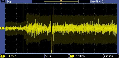

    You got me curious as to what I would see with a couple of my own power supplies.

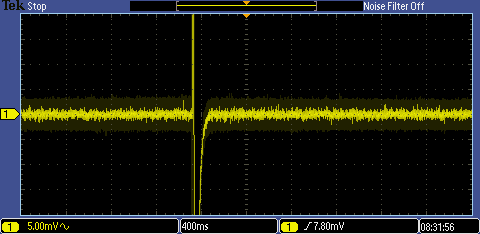

    I had a look at the output of a cheap linear bench supply, GW INSTEK GPS-30300 [usual kind of thing: transistors and opamps, with a pair of 2N3055s for the hard work], and it looks like this. This is x1 with a 20MHz bandwidth limit. To the left, the PSU is off, to the right it's on. No real difference, so any noise from the PSU circuitry is getting lost within the 5mV pk/pk that we see there.
    I'm using a 50ohm coax lead with a terminator at the scope, but it does have croc clips at the PSU end with about 2 inches of unshielded wire. With the scope set to the input GND position, I see about 2mV pk/pk of noise, so the rest is either pickup at the end of the leads, or what is coming through from the mains at the PSU (or maybe the scope end).
    So this one is a bit of a challenge to measure properly using the test equipment that I've got. (Preamp maybe?)

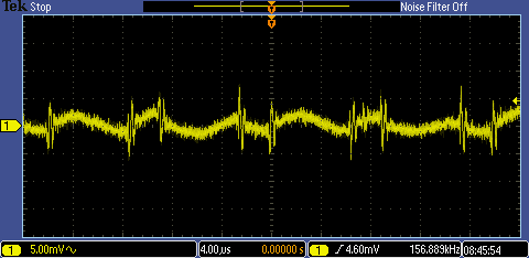

    For comparison, here's a switching supply (Maplin N93CX). This has an output switch. You can see just before the mains goes on it gets slightly quieter - that's my hand moving close to the case. The PSU output control might be electronic - the switch doesn't maintain its state (it always starts up in the off state) and I can't hear a relay clicking. With this supply, the circuitry is definitely contributing to the output noise.
    Not all that rigorous, but it shows the difference between the two. I might try and rig up a transient test later to see if that mirrors what you were seeing.
    Both cases were at an output of 5V with a light load of 10 ohms (0.5A).

    I've added traces showing the results without the bandwidth limit. In the case of the linear supply, it's still the case that the supply doesn't noticeably add to what's there before it's turned on. I'm now wondering about the left switcher trace - how come there's no transient at the point I switched the output on [the switch is recessed and sometimes  I don't operate it properly, so maybe I never actually turned it on]?

    jc2048 over 9 years ago in reply to jw0752
    Yes. The traces above were for 0.5A.
    Here they are for 2A.
    As before, the linear is still just the noise that's fed through from the mains or picked up.
    The switching supply isn't a lot different either - bit less on peak amplitude, maybe.
    This is what the switchers ripple looks like at 2A

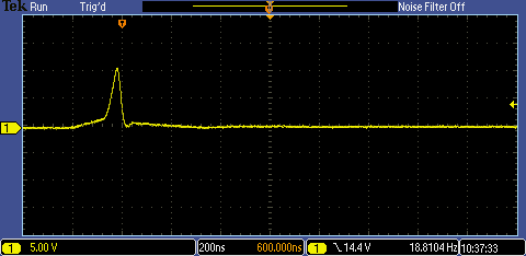

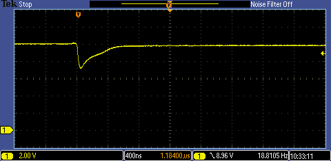

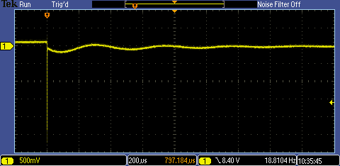

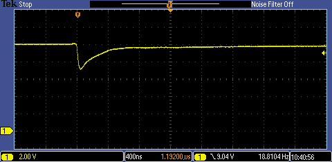

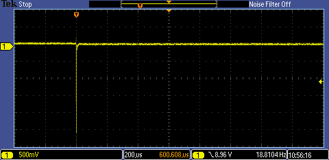

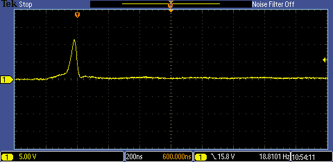

    This is a transient test of the two supplies. This time the output is 10V with the load switching between 0.5A and 2.5A. The load consisted of resistors switched with a power MOSFET.
    [Sorry about this, I seem to be blogging in your blog.]
    Left trace is the switching supply, right is the linear.
    First of all, 0.5A to 2.5A. They both dip by about 3V and get back on course after about 600nS.
    This is a longer view of the above [there's a 10V offset, so the marker is actually at 10V and not 0V]. The switcher is wobbling around for a long time after.
    Finally, 2.5A to 0.5A [again with the 10V offset, so they're both getting up over 20V]. Again fairly similar.

    If I calculate the thermal noise for a resistance of 5.6 ohms and a bandwidth of 5MHz (just to give an idea)
    thermal noise cold at room temp (293K):
    square root (4 x 1.38^-23 x 293 x 5^6 x 5.7) = 0.68uV rms
    now if the filament were at 2400K:
    square root (4 x 1.38^-23 x 2400 x 5^6 x 5.7) = 1.94uV rms
    Have I done that right? It looks ok - you tend to think of thermal noise in resistors being a problem with hi-fi preamps with signals at the 10s of uV level and sensitive instrumentation. In this case the low resistance balances the higher than usual temperature.
    So you are unlikely to be able to measure it with your scope (if it is anything like mine).

    I'm not that happy with the transient load pulses you guys are seeing (big enough to blow stuff). I quickly lashed up an experiment on a Rigol DP832 switching in a 3.3R load with a big MOSFET. I set the supply for 9V so the current was going between 0 and 2.7A.
    The positive transient when the load is removed peaked at 10.7V and took 1.6us to drop back to 9.3V - much slower after that to get back to 9V, probably because there was no load at all.
    Noise is about 1mV RMS or 6mVp-p over at 15MHz bandwidth.
    I think your peak is a much higher but the pulse is narrower.  No time to play more right now, but I almost wonder if your supply with a small capacitor across it would look rather like the Rigol.

    Thank you, you are quite right. I'm measuring the reluctance of the large electrolytic on the output of the PSU to supply current. If I put a 1uF ceramic capacitor across the output to give it a helping hand, I get this for the linear supply:
    Now I'm starting to see the deficiencies in my switched load. The glitch on the 'load off' waveform looks like this in more detail- yellow is voltage out, blue is the voltage at the MOSFET drain
    so the glitch comes from the switch node ringing when the MOSFET is finally off (I've pieced the load together from multiple 3W metal oxide resistors and there's obviously a little too much inductance to the whole array). There's also something else ringing on a longer scale, which I don't quite understand.
    The switcher's reaction to having the output cap is a bit alarming
    it now has 3 paths between load on and load off [possibly the constant-current circuit is coming into play]. Think I'll stick to using the linear supplies.
  • michaelkellett
    michaelkellett over 9 years ago in reply to jc2048
    That last one is a very interesting (and horrible) result. When I can I'll try a couple of switching supplies. My MOSFET rings too - so I'll think about a more controlled switch off for it.
    MK
