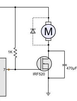

Here is a schematic of the project:

    Maybe I'm not understanding your circuit, but it looks like you have an n-channel MOSFET controlling the pump. If the 555 output gets up to eleven and a half volts, you're only going to see eight and a half at the source, or something like that depending on what the Vgs is at the 0.3A. [You're using the FET as a source follower rather than a switch.] You might do better to put the FET on the low side of the load and use it as a switch.
    One other thought regarding the motor - you could, perhaps, try experimenting with overriding the PWM for the first few hundred milliseconds to get it off to a good start.

    I hadn't captured that the type of FET changed between the two designs.
    You may be onto something, Jon. As the voltage over the motor increases, the gate-source voltage decreases and the FET will not be driven to fully On.

    Thank you for the excellent catch of this error. You and Jan Cumps  are 100% correct. Unfortunately for producing an actual improvement in performance it is an error in my drawing of the schematic and not the actual build.  In simple circuits like this one I will usually build and then go back and produce a schematic. Unfortunately this usually happens at 2:00 AM and I am not always in my best form. I have verified that the actual circuit was built as you recommended and I have redone the schematic to accurately depict reality. The problem I am currently facing is that the thickened water sets up if it is allowed to sit too long and the little peristaltic pump has to start against a considerable load. I have experiments going on at this time where I have removed as many restrictions in the feed tube as possible and have increased the inside diameter of the feed tube overall. Originally I chose a smaller diameter feed tube so that the cord would be more flexible but that problem will probably have to be addressed by using a more silicone based hose. A hose that was soft enough to expand slightly under the pressure exerted by the pump may also allow the pump to start and come up to speed more easily. That approach will have to be tried in another set of experiments. Here is the improved schematic. Thanks again for taking the time to help me analyze this project.

    John, is it possible to feed the pump the full 12V until it's 'primed'?
    a possible setup may be to draw the MOSFET into conduction for a given short amount of time, using an RC circuit. And then handing over control to the 555's output?
    that would give the pump an aggressive kick of power for a brief moment, and have it moving.
    An RC circuit, with a Schmitt trigger, could pull the FET into saturation just for a short pulse ( a kick in the butt), and then the more moderate signal of the 555 can deliver a smooth moderate pump activity.
    you could put an OR gate in place (two diodes image ) to combine the two signals at the gate....

    jw0752 over 10 years ago in reply to Jan Cumps
    Hi Jan,
    I really like your idea to start the pump with a 1 or 2 second full power boost. From your good description you have done all the hard work for me already. Tonight I will start the fun part and try to breadboard the circuit that you described.

    The method Jan suggests is fairly essential to get it to operate at low speeds. There is also a general way of doing it, but it is awkward. The problem with PWM on its own is (as can be seen) the lack of torque at low speeds. If the peristaltic pump is hackable then the motor could be replaced with a stepper motor but then a controller for that is needed/ Another way is to get some feedback off the motor shaft (before it is geared down) so you can feed it into a servo controller type circuit where the pulses off the shaft will be compared with a set value from your potentiometer. This could be achieved maybe by using bits from hobby servo motors, but again will be difficult. If you do see a way of getting pulses from the shaft (e.g. attaching a magnet) then something like MC33030 or MC33033 (it is actually intended for brushless operation but it can be used in a brushed motor mode) would work, but the trouble is they are obsolete. I do have a board I made with a MC33033 on it, and the board could be repurposed for your project. Let me know if you want to pursue that method, and I'll get it sent across. It will require fiddling with R and C values to get the pulses from the shaft sensor to a suitable form for comparing with the potentiometer setting, etc.
    Alternatively a microcontroller could be used, to detect when the shaft is not rotating (from the magnet and a digital output hall sensor) and increase the pulse width to get it moving again. That might be the easiest to be honest. If you want to go that route, I'd suggest a FRDM-KL25Z board and I can help you with the software. This method would just require the shaft magnet/sensor, and a FET for your motor which you already have in the circuit anyway, provided it can be switched from 3.3V which is what the FRDM-KL25Z output will be. The PWM can be implemented in software in the KL25Z board, and it has an analog input for the adjustment potentiometer too. Basically with all these methods, the closed-loop feedback from the sensor will always ensure that the motor is never stalled even at slow speeds.

    A P-channel FET between the positive rail and the gate of Q2 could work.
    The gate of this FET would have a 1M pull-up to the rail and a 1uf cap to ground.
    The gate of Q1 will be high until the capacitor charges up, then the new FET is dormant.
