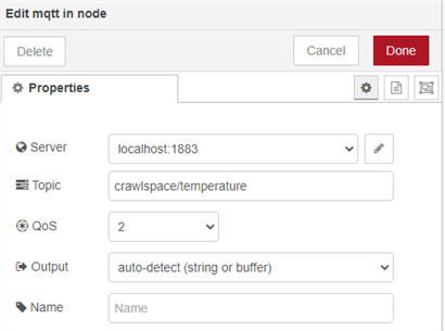

This flow has 4 elements for each sensor data input:
  1. mqtt in - receives data (subscribes to topics) from the Nano 33 IoT
  2. inject - to reset initial state (clear chart data)
  3. debug - provides received data logging for debug
  4. chart - line chart of received data
Example for Temperature data:
Properties:
  1. Server - the Rpi4 is both web host and MQTT server so using localhost on standard port 1883
  2. Topic - this is the subscribed topic that is being published by the Nano 33 IoT
  3. QoS - 2 guarantees that there is only a single response received
  4. Output - autodetect data type
  5. Name - optional, if left blank it will take the topic name

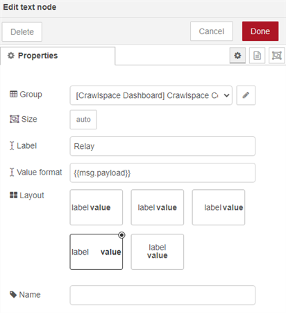

This flow has the additional elements:
  1. mqtt out - publishes topics
  2. switch - to set Override Enable and Relay Set on/off values
  3. slider - sets the control temperature value
  4. text - displays Relay State on dashboard
