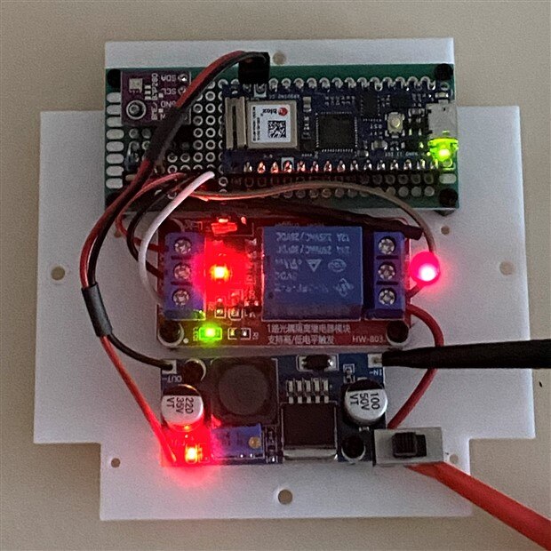

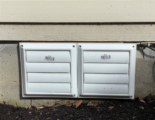

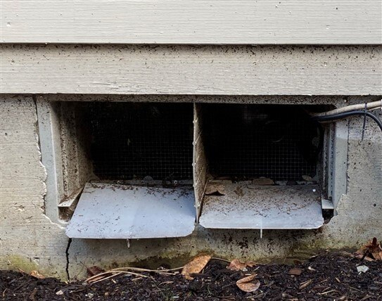

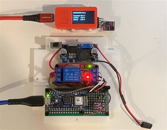

This is the non-electronic part of the project.  I found a couple of 6" Louver Vent Hoods and built a wooden frame that I attached to the foundation vent using a couple of magnetic cabinet latches.  I thought it would improve the look and it provides some form of passive automatic closure when the fan isn't running.
Proto board assemblies
I printed a mounting plate for the boards that are going into the weatherproof enclosure.  I have them wired up so that I could start software development.  I don't have the 20V power connectors attached yet.  We are having a typical Oregon spring - cold and wet.  I may end up doing my project demo indoors and deploy the circuit when it gets sunnier and drier.  I have a portable 20V power supply that I can use to emulate the solar panel and I've put an LED on the relay output to test the switching of the 20V supply.  For initial programming and testing I'm not using the 20V input (i.e. not using the buck converter, though I've set the 5V output and tested that separately with 20-25V at the input).  I'm also using 5V as "solar voltage" for the A/D measurement.  When I get to final test, I'll use the 20V circuits.
The remote sensor that I'm using was built for a different project.  It uses an M5StickC Plus module with the same BME280 sensor that I'm using for the local temperature.  I had posted about my experience with the M5StickC earlier M5StickC Modules .  The Plus module has a larger display and a higher capacity battery.  I will probably switch to using a more power optimized remote sensor later as this sensor will be battery powered and inconveniently located under the house..
The modules from top to bottom
  1. M5StickC Plus with BME280
  2. LM2596 Buck Converter
  3. HW-803 5V Opto-isolated Relay
  4. Nano 33 IoT with BME280 on protoboard

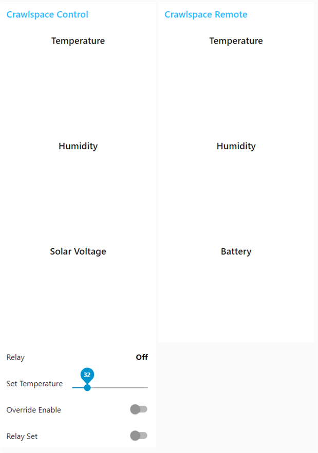

Here is the dashboard I implemented (I'm a Node-Red noob, so I kept it simple):
This is the dashboard in reset state (charts are not populated)

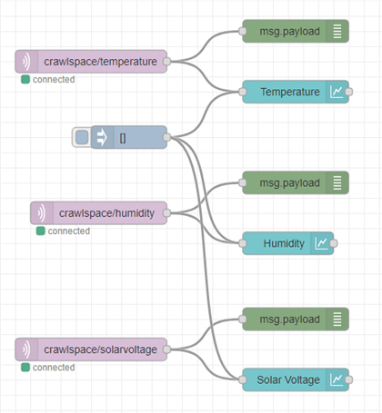

The Node-RED flow to implement the MQTT interaction with the dashboard
Node-RED Subscribe Flow for data charting
This flow has 4 elements for each sensor data input:
  1. mqtt in - receives data (subscribes to topics) from the Nano 33 IoT
  2. inject - to reset initial state (clear chart data)
  3. debug - provides received data logging for debug
  4. chart - line chart of received data

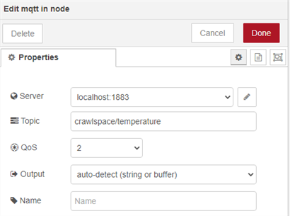

Example for Temperature data:
Properties:
  1. Server - the Rpi4 is both web host and MQTT server so using localhost on standard port 1883
  2. Topic - this is the subscribed topic that is being published by the Nano 33 IoT
  3. QoS - 2 guarantees that there is only a single response received
  4. Output - autodetect data type
  5. Name - optional, if left blank it will take the topic name

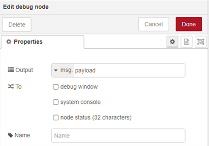

Properties:
  1. Output - this could be the msg payload, the complete message object, or an javascript expression
  2. To - selects where to put the output, defaults to debug window - but I only select when debugging to reduce clutter
  3. Name - optional, if left blank it will take the output name

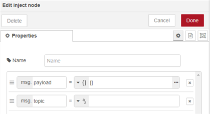

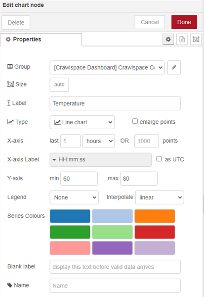

Properties: Lots of options here.  I use the following:
  1. Blank data array {[]} to clear out the chart data.
  2. Text string to initialize value (e.g. On/Off for switches)
  3. Numerical data to initialize (e.g. 32 for slider)

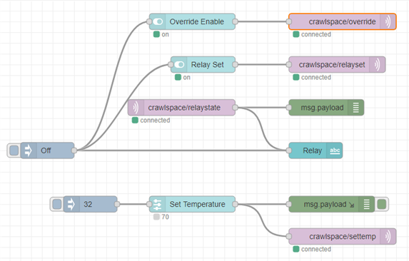

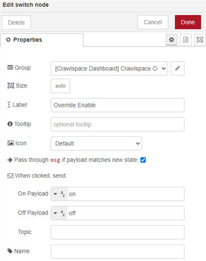

Node-RED Subscribe/Publish Flow for monitor/control

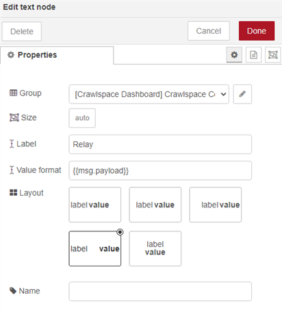

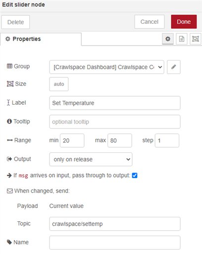

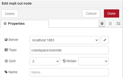

This flow has the additional elements:
  1. mqtt out - publishes topics
  2. switch - to set Override Enable and Relay Set on/off values
  3. slider - sets the control temperature value
  4. text - displays Relay State on dashboard
Example for Override Enable:

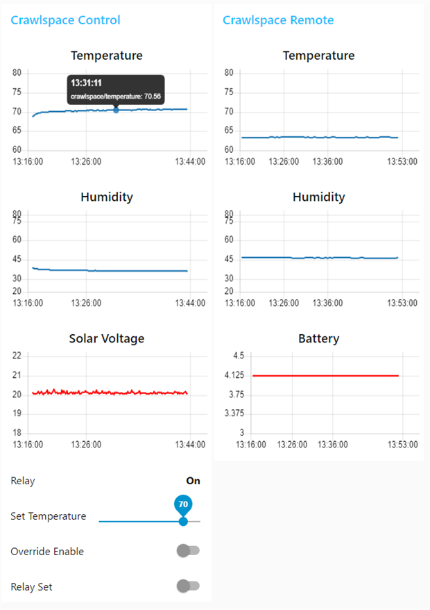

Dashboard Display while running final program

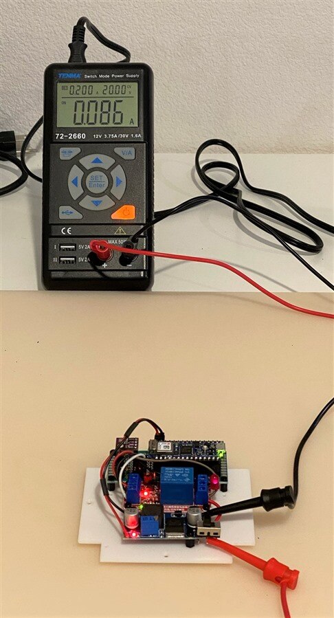

This is still running indoors (not deployed), but using the 20V Portable Power Supply.  The 20V (Solar Voltage) measurement is still somewhat noisy, I'll need to take a look at that.  The Remote Battery reading is high because I'm running on a USB battery bank (LiPo battery is in charge mode).  The Remote is in a colder room in the house (not the crawlspace).  The Relay is on because the temperature is above the Set Temperature.
20V Test Setup
The LED on the terminal block on the right side of the relay module is the proxy for the vent fan (running off the switched 20V with a 1.2K ohm series resistor).

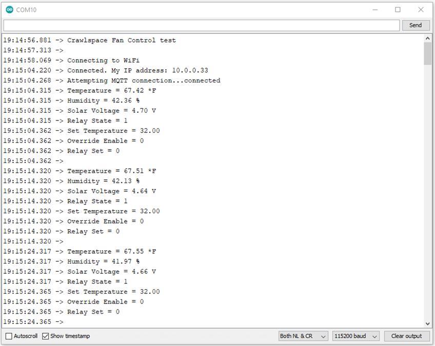

Arduino Control Program
The program startup sequence:
  1. Connect to WiFi
  2. Connect to MQTT Server (RPi4)
  3. Publish
    • Local Temperature
    • Local Humidity
    • Solar Voltage
    • Relay State
  4. Subscribe
    • Set Temperature
    • Override Enable
    • Relay Set
Program defaults:
  • Relay State = 0
  • Set Temperature = 32 F
  • Override Enable = 0
  • Relay Set = 0

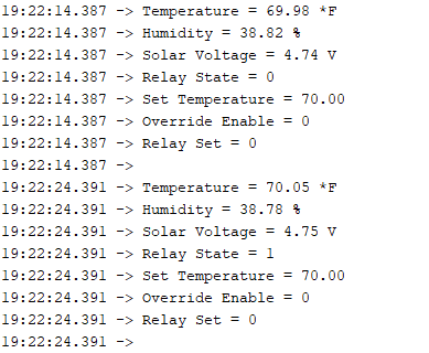

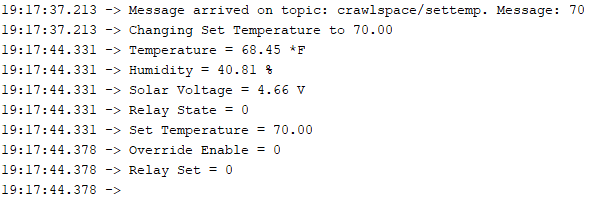

Here is debug serial output of the startup (currently publishes every 10 seconds for debug - probably extend it to 60 seconds when I deploy):
This output was captured prior to switching to the 20V setup (no USB connection for serial output in that case).
Relay State = 1 because the Temperature is above the Set Temperature (32 F)
Solar Voltage ~4.7V (this is 5V that comes from the USB - it's quite noisy, I'll need to check it at 20V)
Change the Set Temperature to 70 F from dashboard
Message is received and Set Temperature is changed
Relay State = 0
After about 5 more minutes of operation the Temperature rises to above 70 F and Relay State = 1

void printValues() {
    DEBUG_SERIAL.print("Temperature = ");
    DEBUG_SERIAL.print(bme.readTemperature()*1.8 + 32);
    DEBUG_SERIAL.println(" *F");
//    DEBUG_SERIAL.print("Pressure = ");
//    DEBUG_SERIAL.print(bme.readPressure() / 100.0F);
//    DEBUG_SERIAL.println(" hPa");
    DEBUG_SERIAL.print("Humidity = ");
    DEBUG_SERIAL.print(bme.readHumidity());
    DEBUG_SERIAL.println(" %");
    DEBUG_SERIAL.print("Solar Voltage = ");
    DEBUG_SERIAL.print(voltSolar);
    DEBUG_SERIAL.println(" V");
    DEBUG_SERIAL.print("Relay State = ");
    DEBUG_SERIAL.println(relayState);
    DEBUG_SERIAL.print("Set Temperature = ");
    DEBUG_SERIAL.println(setTemp);
    DEBUG_SERIAL.print("Override Enable = ");
    DEBUG_SERIAL.println(relayOverride);
    DEBUG_SERIAL.print("Relay Set = ");
    DEBUG_SERIAL.println(relaySet);
    DEBUG_SERIAL.println();

      // print values
      printValues();
Demo Video
Demo showing the interaction between the MQTT Dashboard and the Nano 33 IoT.  The operational delay is due to the 10 second update rate.

Well, that's my Arduino Day Project for 2021.  I made a silly mistake when loading the contacts of the Mini Fit JR connectors (I loaded the wrong sex into the housings - had them reversed).  I'll blame pandemic brain fog which in reality is probably true.  I can't manage to get the contacts extracted, so I'll need to make another set.  So, another reason to wait for it to dry out before I deploy/mount this outside.  I've measured the solar panel and fan setup, so there shouldn't be any issues.  The max voltage that I've measured is about 21.5V and the max current is less than 500mA (surprised me that it was that low, but I can't read the fan label to check the spec).

  • ralphjy
    ralphjy over 4 years ago in reply to ntewinkel
    Hi Nico,
    Node-RED has the capability to interface with MQTT servers, but does not include one that I am aware of.  Plus, Mosquito does work well.
    Relative to your building-science question, I did not seal up the other vents.  I haven't researched how newer houses are built (mine isn't that old - built in 1995), so I'll probably learn something from you image.  I would probably need to do a lot of rework if I wanted to seal those vents permanently.  I did have a full coverage vapor barrier, but it has perforated in spots due to age.  It would be nice to have vents that automatically opened and closed.  Let me know if you find a good air intake solution and maybe I can give it a try.  I'll probably get someone to replace my vapor barrier after the pandemic calms down.  I'm too old to do that kind of work in a restricted space.
