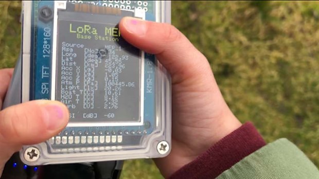

For these tests it was just me, the captain, and science officer.  Functionally, everything performed well.  Although we did not have a Raspberry Pi sending the data over the internet, the shore base captured data as it was coming in and displayed it properly.  In the photo below our 3 year old science officer is holding the base station and reporting out pertinent information.
