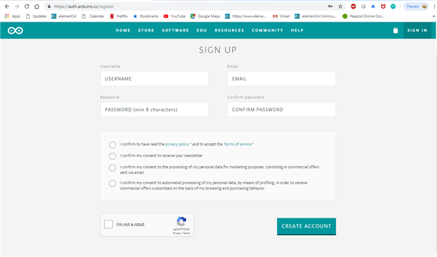

Sign up to Arduino IoT cloud at https://auth.arduino.cc/register :

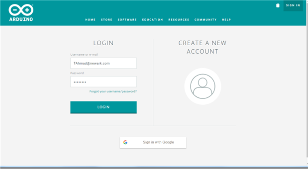

or login if you have an account or use your google account:

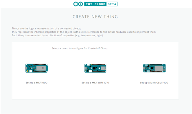

You'll find a step-by-step tutorial as well as an FAQ.  Currently, Arduino IoT Cloud only supports the MKR 1000, MKR WiFi 1010 and the MKR GSM 1400 boards.  In the future the MKR VIDOR 4000 and Arduino Uno boards will also be supported.  Next click on "New Thing" and select the board you wish to use to configure:
You'll need to download and install a plugin onto your computer, connect your board via USB, give it a name, and then configure your board. Arduino IoT Cloud is currently in the public beta stage. We welcome feedback on what you like and what you don’t!
