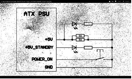

I am taking the plunge and building a Work Bench Power Supply from a PC Desktop power supply.
The guy in the video suggest that a approximate 0.5 amp load be put on the 5 volt rail (12 volt rail on newer) of the switching PS in order to stabilize it.
This diagram shows how he suggests putting it together.
What say you?

    R_Phoenix over 14 years ago +2
    The resistor isn't to stabilize the PSU, but rather give the system a dummy load on the 5v that helps "pull up" the 12. Taking the green wire to ground will still turn it on, but then messure the voltage…
    Taking the green wire to ground will still turn it on, but then messure the voltage with a meter. It will most likly be under 12 volts, something like 11.7 volts instead. Also you will notice that about an amp of draw on the 12 volt will trigger the crowbar and shut it down with no load on the 5v rail.
    The resistor isn't "needed", but it is suggested.
