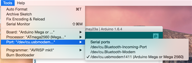

I own an Arduino mega 2560 and have been having problems with it recently. When I load a sketch, this error comes up :
avrdude: stk500v2_ReceiveMessage(): timeout
I can't figure out what it is ( I've read that its a problem with the communication with the computer). When I plug it in the green power LED turns on and so does the orange pin 13 LED. I think that the sketches we're uploading at one point ( I'm not 100% sure as I didn't get it doing anything due to my lack of arduino knowledge ). I am on mac running OS X Yosemite.

    Have you checked you have the right programmer set in the IDE, I remember having a similar issue way back and it was because I had changed this setting inadvertently
    When you start programming, do you see the LEDs start to flash (The coms LEDs)

    I would follow Robert Peter Oakes advice. You can check the target board is correct by going to 'Tools > Board' and seeing which one is selected.

    Thanks for the advice, I selected the right board ans processor but still nothingimage. I think the problem is the Port, I read somewhere that is should be port " /dev/tty.usbmodem1411 " but I only have "/dev/cu". Any more ideas?
    Thanks
    p.s. the LEDs don't flash when programming

    Is AVRISP the right programmer ?I know this is the default now and once I can find my Mega I will try it but that seems to be the 6 pin port from memory

    I tried all the other programmers and nothing is working
