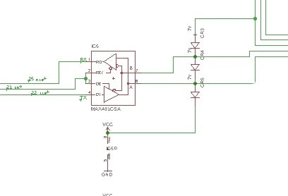

  I`m currently making some proto circuits and I would love some feed back/Ideas etc.
All these circuits will connect to Arduino or Arduino compatible devices.
Anyone have time to help out with some reviews?
First circuit is a 4-20ma board
    genebren over 8 years ago in reply to s1buell +4
    You might need to modify your 4-20ma loop front end somewhat. First, the circuit as shown does not have a return path for the current loops. Also, the current loop may not necessarily be directly referenced…
    Tom, Again, I am not sure that you can count on the second leg of the 4-20ma loop to be at ground potential. You might end up shorting out a driver or introducing ground noise into the circuit. Here is…
    Tom, Here is an even better link. This shows how to differential sense the loop current. https://www.sensorsmag.com/components/implementing-a-4-ma-to-20-ma-sensor-interface Good luck! Gene

    s1buell over 8 years ago in reply to genebren
    Yes agree. I reviewed the worst-case spec`s (13VDC upper end for example) and then put the TVS inside these specs to save the components. I really like these TVS diodes they are an easy way to protect bus side of the solution.
    So, do you think its worth keeping the optical chips?
    Tom,
    Strange, but I had replied earlier, and stated that I think you should leave out the Optoisolators.  They really are buying you and protection given that the transceiver is now protected nicely.  About the only time I would use the optoisolators is if the transceiver was power by an isolated DC-to-DC supply, or if there was a high voltage source nearby (on the other side of the 485 bus).
    Good job!
    Gene
    1. Agree. I don’t see the need now for the optical. I have the power side covered well I think....
    Here is the final RS485
    I’m going to post the RS232 for you to have a quick look

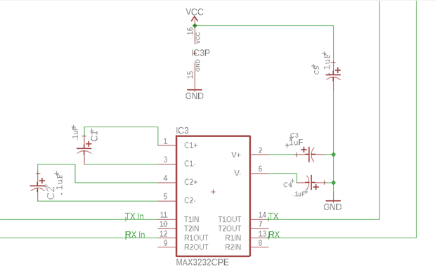

    RS232 with TVS protection
    I used .1uF Tant at 3.3VCD power input. Now the manual says to use a different config but everything I read and every circuit I see is using this config at 3.3VDC.image
    Have a look.
    Tom,
    Typically the bypass capacitor (in this case C5) does not need to be a tantalum.  I usually just use a ceramic.  Otherwise, this looks good.
    Gene

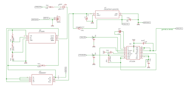

    Gene you have time to check out a 12V DC power supply with reverse polarity/surge  protection?
    I need a second pair of eyes.....
    Tom,
    Sure, post it and I'll review it.
    Gene
  • s1buell
    U2 & U3 are  the protection circuit.
    U7 is a simple 12vdc regulator for 12VDC connections
    U1 is my 12VDC dual output source
