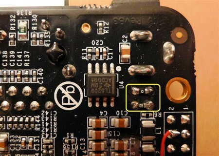

    Well I've half solved my problem! image
    I noticed that RT1 (Polyswitch type fuse for HDMI) was rather hot when I had the HDMI to VGA Adaptor plugged in! Remembering that the HDMI to VGA converters draw a fair bit of current and as the Polyswitch is only 100mA hold current I hooked it out and connected the HDMI 5V to VDD via meter on 300 mA current range and discovered it draws between 140 and 200 mA and worked when connected like this!
    So that explains why I got a display briefly when I connected the HDMI converter having already booted connected to the TV but got nothing when booting with it connected directly - there was a couple of seconds before the Polyswitch started to go to high resistance and drop the voltage below that required for the HDMI converter to function correctly.
    I've now put a link in between VDD and the HDMI 5V and the HDMI to VGA converter works OK and with no overscan, unlike the TV. I just need to try to sort out the overscan problem when connected to the TV.
    I'll start having a play with creating an EDID file and trying different resolutions and refresh rates and see what happens.

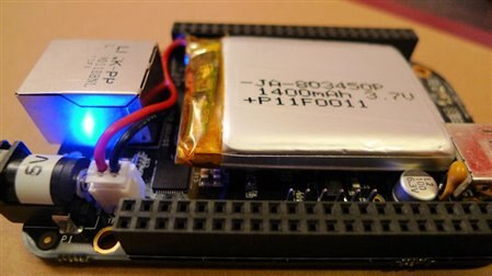

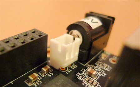

    shabaz over 13 years ago in reply to e14 Contributor
    Until we have some space to work in, I might as well add to this thread:

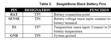

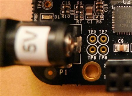

    I've not had much time to experiment with the board recently, but I had an hour today, and I tried powering the board from a battery.
    The LiPo was from Olimex, and basically just connects to the pins as according to the SRM table 3:
    My LiPo has built-in circuit, so I soldered a 10k resistor to TS and GND. The LiPo connector was convenient to solder to pins TP6 and TP8, and then  a zero-ohm link between TP5 and TP6 on the underside.
    I had only a right-angle connector so I bent it appropriately (the connector is on a 2mm pitch whereas the holes are not, so the pins need slight bending, so maybe an already-vertical connector would not have space to bend them)
    Plugging it in, the board worked fine, and the serial port allowed for the usual access. I didn't try Ethernet yet.
    The battery (Olimex code "BATTERY-LIPO1400mAh") by luck fits flush with the connectors so a daughter board can still be stacked over it in future.
    Really I need to write to the config registers to set the charge voltage to 4.2V (the default is 4.1V) but I've not looked to see how to do that yet.
