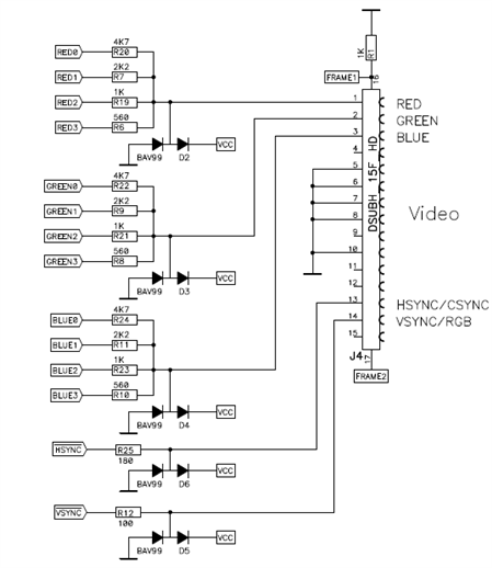

    Or, you could make a VGA adapter out of resistors: http://hackaday.com/2012/06/26/offloading-vga-generation-onto-a-coprocessor/
    Pity that the link from hackaday to the details seems to be dead now image
    Still, interesting and creative use of the PRU..
    Cool! I didn't realize that was possible.

    shabaz over 13 years ago in reply to fustini
    Hehe sounds like a challenge!
    The PRU VGA link doesn't point any more to the details, but it could be straightforward, if the video memory location is known. The circuit below is what the 'Minimig' project uses for VGA. PRU#1 could be used, which has lots of PRU GPO capable pins (i.e. the video pins used for HDMI).
