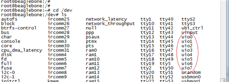

    A quick question, do you see /dev/uio0...7 files on your board?
    At the same time as enabling the 400kHz I2C, I have enabled the PRU in the dts, but before when I messed up, I was using the older image (now I'm on the 8th May image), so I'n not sure if the /dev/uio0..7 which I see now is a result of the new image(it wasn't in the old image), or because of the PRU enablement that I changed in the dts.
    I've tried building up one of the PRU examples, and finally it appears to run, so now I may spend some time learning the bare minimum assembler.
    e14 Contributor over 13 years ago in reply to shabaz
    I'm still using the original image with the 3.8.6 kernel. There seems to be a fair number of differences, no uio* ircomm* for me, but I do have dri & fb0 which you don't. presumably there's other differences in the newer image as well.
