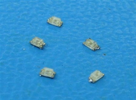

I used thesethese 0603 leds, not fun to solder.  I bought some 0402 replacement resistors too, but looks like I don't need them - good thing, as I wasn't looking forward to soldering those..

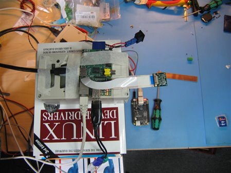

    BeagleBone Red being watched by R-Pi

    I may go ahead, since you got good results without replacing them.
    the ones I used are only 15mcd and supposedly have a diffused lens, although it's hard to be sure when they are so small. It does seem to make a difference compared to the usually clear lensed blue ones though.
    Lead free solder, tiny device, very close together certainly makes it tricky to swap them. I didn't quite have to reach for the hot air tools and tweezers, but close..

    BeagleBone Red being watched by R-Pi image
