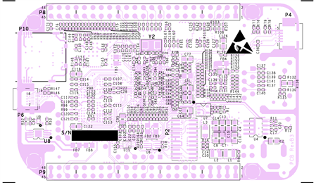

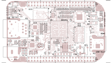

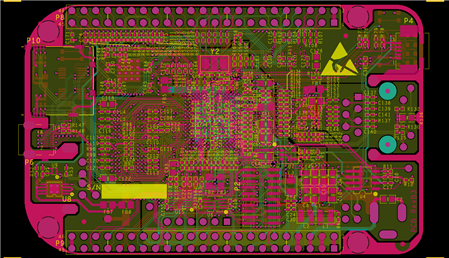

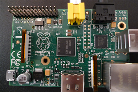

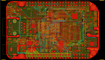

    shabaz over 12 years ago in reply to morgaine
    Also,
    This:
    (by the way, it looks like the ticks on the silkscreen near the headers is ideal for counting off 10 pins at a time)
    versus this:
    shabaz over 12 years ago in reply to shabaz
    Also,
    (We could use these images to annotate any mods/changes we make).
