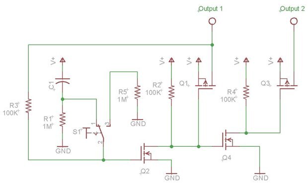

Hi!
I wonder if there are any curcuits that allow me to only switch when device is powered off.
I select between 2 chips with their 5V pin and I want to prevent to be able to "hot swap". If I would toggle the switch when power on it will stay on the state it was when the system was powered on.
Is there any solution, any chip I could use?

    dougw over 9 years ago in reply to atmn
    This is a quick example that doesn't need any chips...
    Q1 and Q3 are P channel FETs like BSS84, Q2 and Q4 are N channel FETs like BSS138.
    With the switch in the capacitor position, Q2 will turn on Q1 and turn off Q4 upon power up. Q3 stays off because R4 pulls the Q3 gate up. The circuit will then latch in this state as R3 will hold Q1 on. Switching the switch will not change the state.
    With the switch in the grounded position at power on, Q2 and Q1 never turn on since Q2 gate is always grounded. This Allows R2 to pull up the Q4 gate, turning on Q4 which turns on Q3. Again the switch has no effect after initial power up.

    atmn over 9 years ago in reply to dougw
    Looks great!
    I really wanted to go analogue with my solution so this looks doable. image
    Gonna order some components and try it out!, again thanks!
