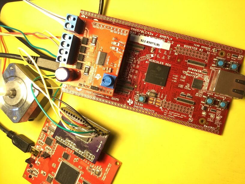

I'm trying to control an unknown stepper motor with the high-end timer (NHET) module of a Texas Instruments Hercules microcontroller
I got a freebie from TI almost a year ago. An unknown stepper motor, a driver board and a Hercules RM57 LaunchPad. The code to run the motor was expected to arrive too (it was an assignment for an internal) but that never materialised. In this blog series I'm trying to program the NHET module so that it sends the right signals to make the stepper step.
In the 6th blog I port the MSP40 SPI commands for the DRV8711 to the Hercules RM57 safety microcontroller..
This post shows that even with very different hardware, you can often reuse big chunks of code.
In this case, the DRV8711 register definitions serve me very well.
Big SPI differences between Hercules Controller and MSP430, Little Impact

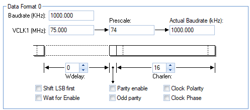

Here's how you set the SPI bit width and speed:

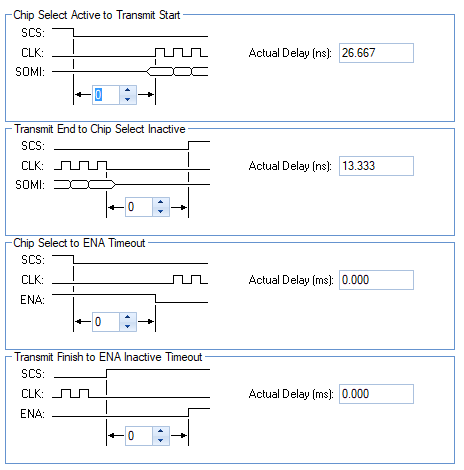

There's also a screen where you can fine-tune the timings within a SPI communication burst:

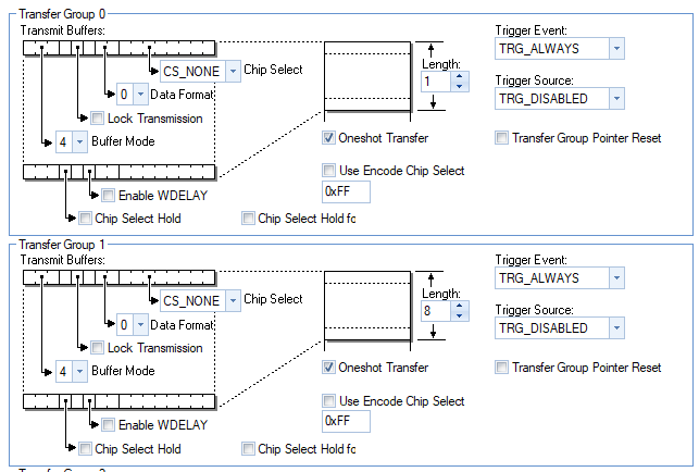

When performing the communications, these settings can be used to do unbuffered (upper part of screen capture) and buffered (lower part) SPI.
The upper part exchanges one  16-bit value (in our case, because we've defined a Data Format 0 with bit size ).
In the lower part, we can exchange 8 16-bit values in a single shot.
The Hercules off-loads the work to the SPI module.
The ARM controller can do different things in the meantime.

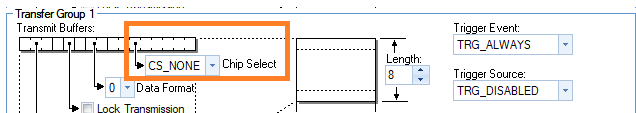

You can see that I haven't selected a SPI CHIP Select. That's because the Stepper Motor BoosterPack doesn't have it's CS pin on a SPI capable pin.
Don't ask me why. If only they moved it to the free pin above, it would be OK - that's a default CS pin for BoosterPacks. Don't call me. Call TI.
Solving Incompatible Chip Select
Easy (in our case. Less easy when dealing with a big chunk of buffered data. In that scenario I would change the hardware).
As told before, the CS pin on the boosterpack isn't matching a CS of the LaunchPad Standard. So we have to provide the CS ourselves.
The first thing to do is tell the SPI module to not set a CS.
From that moment on, the CS decision is up to your own firmware.

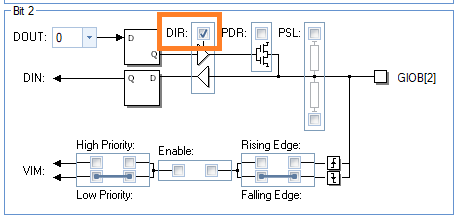

The DRV8711 CS matches the RM57 GIOB[2] pin.
So I have to do a few things
. First is to set this as a GIO output pin:
Once we've called gioInit(), this pin can be programmed.

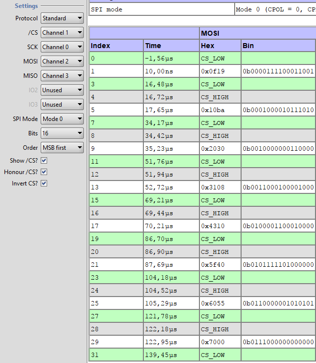

The excellent news is that everything works. I've replicated the code that initialises the DRV8711 from the MSP430, and the Logic Analyzer capture is fully compatible:

Protocol Analyser capture:
That's perfect for this application. There's room for optimisation, but let's only do that if needed. Any changes make comparison with the original MSP430 example more complex ..
