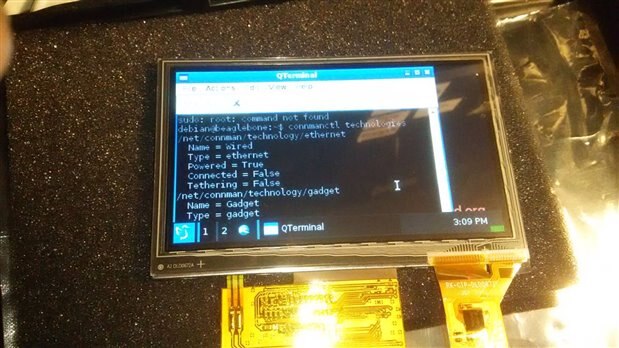

I  am  having  trouble  flashing  the  Beaglebone  Black  Wireless eMMC  with  the  image  file  provided for  the  E14 Beaglebone  4.3  LCD  Display.
README - 4.3 LCD Display Cape for Beaglebone Black
4.3 LCD Display Cape for Beaglebone Board (White, Black, or Wireless)
I have  followed  the  instructions  for  flashing  the  eMMC but it's  not  working.
The  LED status lights  on the  BeagleBone  Black  W blink for  a  few seconds  and  go out. The  micro  SD status  light  remains  on constant after attempt  to  flash.
I can't figure  this  out. Beginning to  regret  the  purchase  of  this  Display.
The  first  one  arrived  damaged, had to  wait  for  a  replacement .
Now on day two  of  trying  to  get  this  display  to  work  with  the  Beaglebone  Black  W.
The image will boot from microSD and display will work.
I need to flash the eMMC with this image.
So far unsuccessful
It seems  the   image  is not   compatible  with  the  BBB Wireless.
When   checking   available   services  with   " connmanctl  technologies   ", ethernet   and gadget   were   listed   but   not   Bluetooth  and   wifi .image
This image   seems  to  be  only  compatible  with  the   Beaglebone  Black  and   not   the   Beaglebone  Black  Wireless .
Is there  any  one  who  might  be  able  to  assist  with  finding  a  solution  to  this  problem?

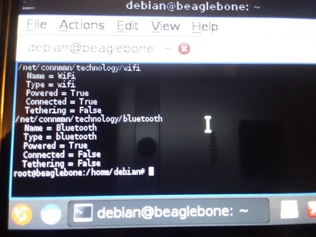

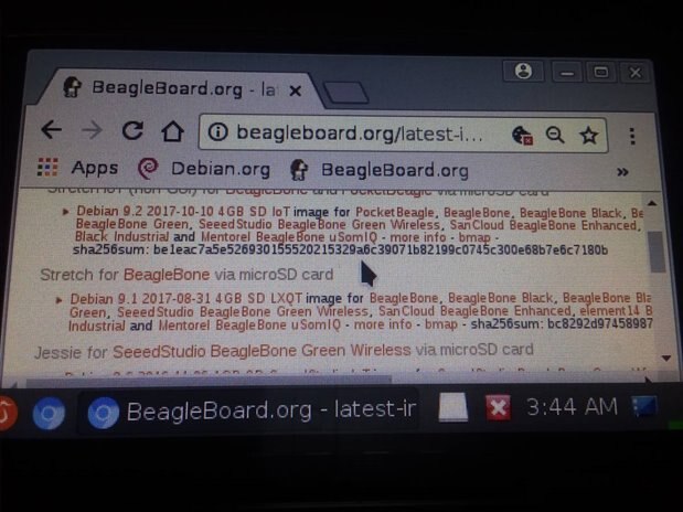

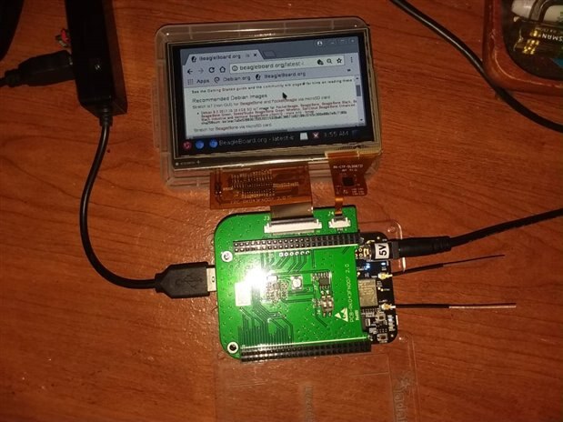

  • ninjatrent
    0 ninjatrent over 8 years ago
    The Debian 9.1 2017-08-31 4GB SD LXQT Desktop image available at Beagleboard is confirmed working properly with the Beaglebone LCD Display Cape.
    Wi-Fi and Bluetooth are detected.image
    Chromium Desktop works.
    Beaglebone Black Wireless with the LCD Cape.
    Everything seems to be in working order.
    I would really like to thank everyone for the help.
    Trent
