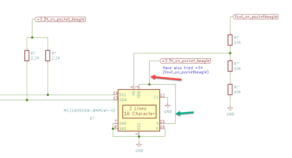

    shabaz over 6 years ago in reply to chrischristian14 +1 suggested
    It's hard to follow the wiring, so I couldn't check that, but something looked odd in the areas marked with red arrows below. The left side says +5V, but the right side says +3.3V. However, most breadboards…

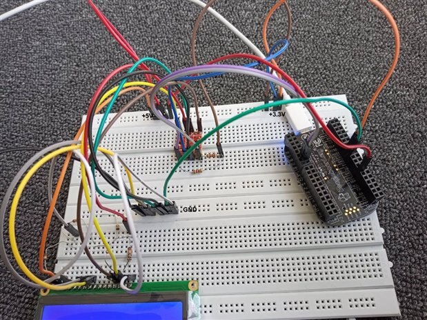

    Please see  below, I have two of those LCDs and none of them are working, so I don't think they both are faulty out of the box. Are you suggesting putting capacitor across power lines on LCD ?
    btw: I am running the whole circuit from pocketbeagle, which runs from USB connected to PC, I have also tried using breadboard power supply but no difference.

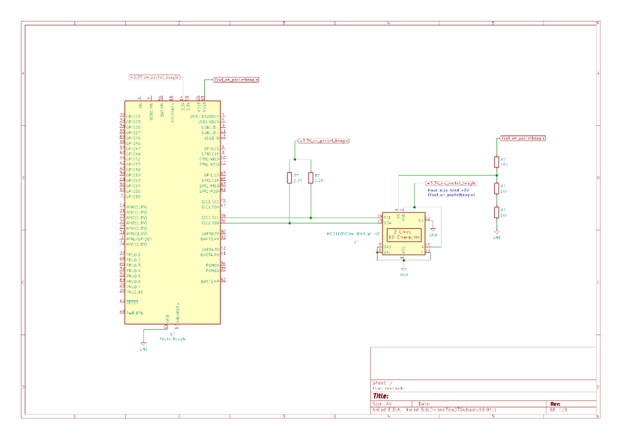

    0 shabaz over 6 years ago in reply to chrischristian14
    Hi Chris,
    I think part of the issue is your connection to pin 15 - it needs a resistor at the green arrow location below, it is not optional. 100 ohms should be fine.
    Also, the datasheet says VDD has to be between 4.5 and 5V, so it shouldn't be connected to the 3.3V supply.
    Capacitor is needed on that rail (i.e. see red arrow below).
    If that doesn't work, you'd need to probe the I2C lines and check that the levels there look correct. Sometimes people do strange things like run extremely long cables, or have broken connections, so it needs to be probed.

    I don't have capacitor with me at home need to go back to Lab and will update you then, Midas got back to me and asked me to put the 100R on the backlight and also told me to try to increase the pull ups to 4.5K or more, I rearranged the circuit, tried with 100R and 10K pull ups but no joy, so I tried with logic level converter and 10K pull ups on the i2c lines on LCD side and 2.2K pull ups on the beagleboard side of the i2c lines, but still no joy.Please see the below image of the breadboard setup
    I will try the oscilloscope and capacitor from workshop and will update then.

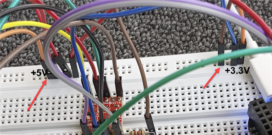

    The left side says +5V, but the right side says +3.3V. However, most breadboards have all of those sockets connected in one long horizontal line across the entire length of the breadboard. Is that not the case with the breadboard you're using?
    If the capacitor, and the suggestions from Midas do not help, then it is possibly a construction issue (e.g. faulty or broken wiring, or breadboard could be damaged). Needs multimeter and 'scope to test it all out.
