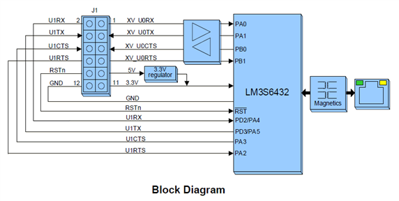

The tiny-footprint StellarisRegistered Serial-to-Ethernet Module (MDL-S2EMDL-S2E) offers a complete, ready-to-implement solution designed to add web connectivity to any serial device. The most common application for the MDL-S2E..MDL-S2E.. is for augmenting legacy products that only contain a serial port for a configuration or control interface. In addition, newer computers, especially laptop computers, do not necessarily have serial ports, and a serial connection is limited by cable length (typically 10 m).
Simply installing a StellarisRegistered Serial-to-Ethernet Module into the legacy serial device provides many benefits including no major board redesign or software changes, easy sharing on a network other than Ethernet, tiny form-factor for unobtrusive implementation, and 10-meter maximum cable length for serial connections is no longer a limitation.
The Serial-to-Ethernet (S2E) module is a simple add-on product that provides serial to Ethernet communications. Existing systems that lack Ethernet connectivity but have a UART or RS-232RS-232 port can be easily upgraded by the addition of the S2E module. A web server supports module configuration from any web browser.
The MDL-S2EMDL-S2E is the first serial-to-Ethernet converter available with a highly integrated ARMRegistered CortexTm-M3 microcontroller with 50 MHz of performance and ample single-cycle, on-chip Flash and SRAM memory for efficient network traffic handling. For maximum space savings, the StellarisRegistered microcontroller is offered in a small BGA package and integrates the 10/100 Ethernet MAC and PHY on-chip.

Kit Features
The MDL-S2EMDL-S2E is a ready-for-production serial-to-Ethernet module with the following features:
  • LM3S6432LM3S6432 in a 10 x 10 mm BGA package for reduced board size
  • 10/100 Mbit Ethernet port
  • Auto MDI/MDIX cross-over correction
  • Traffic and link indicators Serial ports
  • UART ports include RTS/CTS for flow control
  • UART0 has RS232 levels, transceiver runs at up to 230.4 Kbaud
  • UART1 has CMOS/TTL levels, can run at 1.0 Mbaud
  • IP configuration with static IP address or DHCP
  • Telnet server for access to serial port (VCP software included)
  • Web server for module configuration
  • UDP responder for device discovery
  • Telnet client for Ethernet-based serial port extender
  • Module supports 5 V and 3.3 V supplies
  • Multiple mounting options
  • JTAG port pads for factory programming
