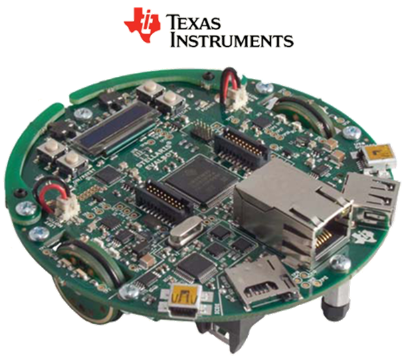

The StellarisRegistered Robotic Evaluation Board (EVALBOT) is a is a mini robot that allows developers to experience the Stellaris ARMRegistered CortexTm-M3 based LM3S9B92 MCU in real-world applications that leverage the processor's integrated 10/100 Ethernet MAC/PHY, USB On-The-Go, CAN, and motion control capabilities. Based on a complete analog and embedded processing signal chain from TI, the kit includes all of the hardware and software required for quick assembly so that developers can begin evaluation in 10 minutes or less. The board also uses a range of Texas Instruments’ analog components for motor drive, power supply, and communications functions. After a few minutes of assembly, the EVALBOT’s electronics are ready-to-run.
When roaming, three AA batteries supply power to the EVALBOT. The EVALBOT automatically selects USB power when tethered to a PC as a USB device or when debugging. Test points are provided to all key EVALBOT signals. Two 20-pin headers enable future wireless communications using standardized Texas Instruments’ low-power embedded radio modules (EM boards). Additional microcontroller signals are available on break-out pads arranged in rows adjacent to the microcontroller.
The EVALBOT has factory-installed quickstart software resident in on-chip Flash memory. For software debugging and Flash programming, an integrated In-Circuit Debug Interface (ICDI) requires only a single USB cable for debug and serial port functions.

The Stellaris LM3S9B92 is an ARMRegistered CortexTm-M3-based microcontroller with 256-KB flash memory, 96-KB SRAM, 80-MHz operation, Ethernet MAC/PHY, USB Host/Device/OTG, and a wide range of other peripherals. Unused microcontroller signals are routed to either the 20-pin EM expansion headers or to 0.1“ pitch break-out pads which are labeled with their GPIO reference. An internal multiplexer allows different peripheral functions to be assigned to each of these GPIO pads. When adding external circuitry, consideration should be given to the additional load on the EVALBOT’s power rails.

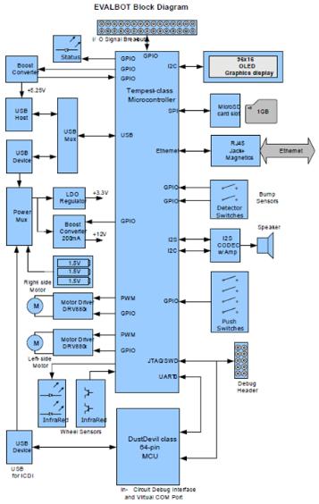

    The EVALBOT uses a 16.0-MHz crystal (Y3) to complete the LM3S9B92 microcontroller's main internal clock circuit. An internal PLL, configured in software, multiples this clock to higher frequencies for core and peripheral timing. A 25.0 MHz (Y1) crystal provides an accurate timebase for the Ethernet PHY.
  • Power Supplies
    The EVALBOT can be powered either from batteries, the ICDI USB cable, or a USB device cable. The power source is determined by a Texas Instruments TPS2113 Auto Switching Power Mux and two Schottky diodes. Battery power is selected automatically when USB power is not present.

Kit Features
This evaluation kit provides a hands-on mini robotic platform for learning and using the μC/OS-III real-time kernel. The evaluation kit includes the following features:
  • Evaluation board with robotic capabilities
  • Mechanical components assembled by user
  • StellarisRegistered LM3S9B92 microcontroller
  • MicroSD card connector
  • I2S audio codec with speaker
  • USB Host and Device connectors
  • RJ45 Ethernet connector
  • Bright 96 x 16 blue OLED display
  • On-board In-Circuit Debug Interface (ICDI)
  • Battery power (3 AA batteries) or power through USB
  • Wireless communication expansion port
  • Robot features
    • Two DC gear-motors provide drive and steering
    • Opto-sensors detect wheel rotation with 45° resolution
    • Sensors for "bump" detection
