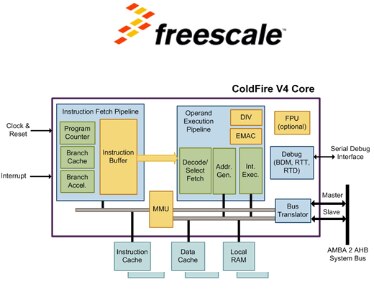

The ColdFire V4 core delivers exceptional performance - more than 500 MIPS - while maintaining a low cost and small size. Upward compatibility from ColdFire V1, V2 and V3 cores provides a smooth roadmap to higher performance designs, giving customers exceptional design flexibility.
The ColdFire V4 core can provide over 500MIPs of performance using a standard cell-based design methodology in a generic 90-nm process technology and interfaces to the System-on-Chip (SoC) using the standard AMBA-AHB bus. The core supports a variable-length RISC architecture that allows instructions to be 16, 32 or 48 bits in length. The result is more efficiently packed code in memory, reducing memory requirements and lowering overall system cost. All ColdFire cores (V1, V2, V3 and V4) share the same architecture and instruction set, making upward compatibility to other ColdFire cores a smooth roadmap to higher performance designs.

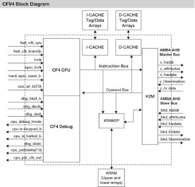

The ColdFireRegistered 4 microarchitecture provides a 2.8x performance improvement when compared with the ColdFire 3 core over a broad range of applications.
  • Improved microarchitecture for higher performance: greater than 200 Dhrystone 2.1 MIPS @ 150 MHz
  • Small set of new instructions for better code density and performance
  • Enhanced MAC and debug functionality
  • Core size = 4.5 mm2 in 0.25 micron drawn process
  • Independent, decoupled pipelines
  • 4-stage Instruction Fetch Pipeline (IFP)
  • 5-stage Operand Execution Pipeline
  • FIFO I-Buffer is the decoupling mechanism
  • Limited superscalar execution through use of instruction folding
  • Approaches dual-issue performance but at a much lower silicon cost
  • Harvard memory architecture
  • Most instructions execute in 1 cycle
  • Sophisticated 2-level branch acceleration mechanisms in the IFP minimize execution time of change
