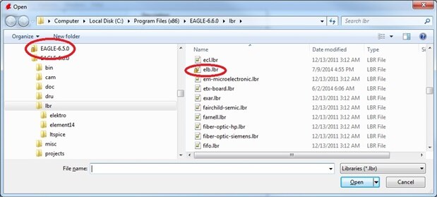

e14 Contributor
I'm new to Eagle and trying to use it for some projects I am working on.  I started a personal library, but I can't seem to find the actual file it is in.  I can see it in the Open dialog in Eagle, but it is not visible in Windows Explorer.  The file is present because if I try to create a new file in the library directory by that name, it reports a file already exists.  The thing I don't understand is the lock image on the file.  I attached a screenshot and marked two of these directories.  One of them is an old install of Eagle.  What is going on with this?

    0 autodeskguest over 12 years ago
    Am 11.07.2014 04:21, schrieb Elmo Clarity:
    To view any images and attachments in this post, visit:
    http://www.element14.com/community/message/120013
    I do not see your image, but assume that you are working with
    Windows 7/8/8.1.
    The User rights manangement puts all your data into a roaming
    folder. This could be something like, C:\users\your_
    name_\Appdata\Roaming\Local\CadSoft\Eagle\.......
    Windows Explorer does not show these folders by default!
    Hope this helps.
