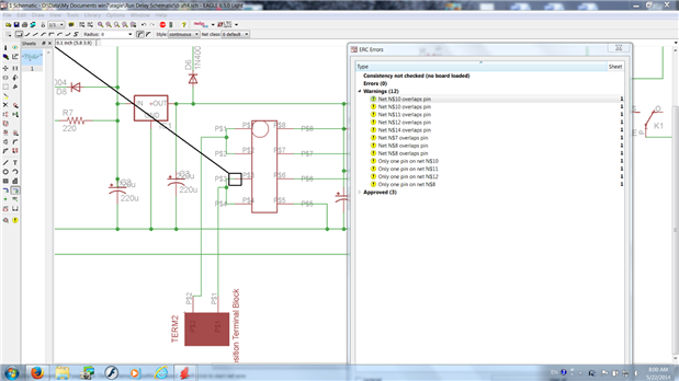

    Am 22.05.2014 14:04, schrieb J Chop:
    Thank you Alfred, however, the advice you gave did not help. I tried to
    both realign the schematic and symbol separately. Each process completed
    but stated that nothing was done. I am attaching a picture for you to
    see the areas that are in question. Is there anything else I can do?
    Thanks again!
    1. please check the coordinate of the PIN in SYMBOL, must be 0.1 inch
        grid.
    2. check the Gate in device-editor, must be in 0.1 inch grid.
    3. check the origin of the gates in schematic, must be in 0.1 inch grid.
    Do you have run the ULPs in exact order:
    RUN snap-pin-in-symbol (Symbol-Editor)
    UPDATE library  (Schematic Editor)
    RUN snap-on-grid-sch.ulp (Schematic Editor)
    How do you draw the net? By NET-Command, or WIRE-Commend?
    For more support, you can send me the schematic.

    e14 Contributor over 12 years ago in reply to e14 Contributor
    I resolved the issue by redrawing the devices I made and redrawing the schematic from scratch while importing the new devices. Something was stuck on a metric grid apparently. Thanks for your response. :-)
    Can you point me to a resource for designing copper planes in eagle - a tutorial if you will on power/gnd plane construction?
    Thanks in advance!
    Thank you Alfred, however, the advice you gave did not help. I tried to both realign the schematic and symbol separately. Each process completed but stated that nothing was done. I am attaching a picture for you to see the areas that are in question. Is there anything else I can do?
    Thanks again!
