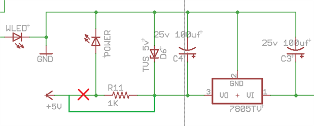

    That said, I have looked at the files uploaded and whilst the input AC routing issue is relatively trivial to fix, the main reason the auto router is generally making such a HUGE mess is that the placement is not ready for routing yet, there is a lot of additional placement work to do before I would even consider putting any routing in. I also found some circuit peculiarities, e.g. why was the whole 5V rail supplied through a 1K resistor? I presume this was a mistake and that 1K was there for the power LED? Where are the bypass decoupling caps etc? Also, the pinout of the MEGA8 just leads to a total mess.

  • rachaelp
    0 rachaelp over 9 years ago in reply to omega-5
    Friedrich Bleikamp wrote:
    I suppose there's an error in this circuit.
    Yep that was the error I referred to in my post above. It wouldn't have worked too well!
