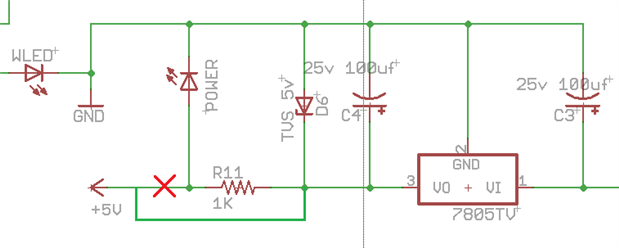

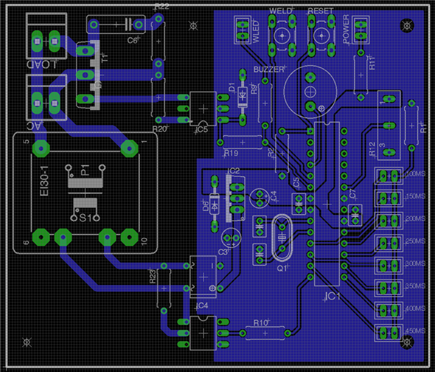

A total newbie to eagle design and PCB fab. So plase bear with on my silly questions, trying to learn.
I have pcb that is schematically completed with the layout. Before i start the fabrication process i need some expert advise if the components placed and the wires routed are ok for the ac mains and the others. The load here will be a transformer. The ac mains are 240VAC and all works well as designed in the schematic on a bread broad except for the load for which MOC3023 is yet to arrive from where i've ordered.
Thanks in advance.

    George Thomas wrote:
    So i've nearly placed all the components like in the second layout rachaelp. Would it be ideal to connect all the positive/signals and later add a polygon and name it GND and all the negatives would be connected that way.
    Yes that's fine. I actually drew the GND polygon in early to clear away air wires so I had a better idea of how many more nets needed routing. Then once I had sorted the pinout on the MEGA8 to stop unnecessary net crossing it all went in really easily.

  • michaelkellett
    0 michaelkellett over 9 years ago in reply to rachaelp
    For mains input spike suppression I think you are much better off with this kind of device:
    http://uk.farnell.com/epcos/b72214s0231k101/varistor-60-0j-230vac/dp/1004389
    B72214S0231K101
    Farnell 1004389
    This one is rated at peak current of 4500A.
    Make sure you pick one rated and intended for the mains voltage it will experience.
    This kind of part has  a much larger volume of material to absorb spike energy than a 'transorb' zener diode like device at a similar price point.
    Generally speaking you should not expect the transient suppressor to blow fuses.
    It is not normal to protect mains powered equipment from continuous application of excessive voltage - but it should be designed to be happy with the maximum allowed in the locale in which it is used. (I would go for nominal +20% if possible - in the UK the mains is supposed to be 230V AC within  -6%, +10% tolerance).
    MK

    Yes you are probably right, AC power supplies is a little off my usual area of expertise. It seems some prefer to use a TVS rather than MOV's because MOV's degrade over time every time they see a spike. I was wondering if for this applications, with the AC to the load being switched on and off to a transformer being used for spot welding, whether there would be regular spikes because of that and hence something that can withstand many spikes without degradation may be better?
  • anishkgt
    0 anishkgt over 9 years ago
    came across this Spot welder controller from the web and he seem to be using tvs diodes as well. Why two thrustirs to control the load and am trouble witching on yhe Triac.
  • autodeskguest
    0 autodeskguest over 9 years ago in reply to anishkgt
    Triacs can suffer commutation problems with certain types of load -
    highly inductive (like a transformer) is one of the problem cases. The
    problem exhibits as a failure to turn off at the end of a half-cycle. I
    think this is more of an issue when PWMing the mains (light dimmer
    style), which is why I asked that question earlier. For that type of
    application a pair of back-to-back thyristors is more robust.
    It may not matter for your application if you occasionally get an extra
    half-cycle (10ms) as long as that is all you suffer. If you find that
    you get worse than that, the two-thyristor design is what you need.
    http://link.springer.com/chapter/10.1007%2F978-1-4612-9877-9_12 is worth
    reading on this.

  • autodeskguest
    On 12/09/16 14:00, George Thomas wrote:
    So if i understand correct, the triac, when used with an inductive load such as the MOT does not switch off the load at the zero cross but after 10ms on 240VAC 50Hz.
    Not quite. The triac turns off at the zero crossing of the current, not
    the voltage. With a resistive load, these occur at the same time. With
    an inductive load, the current lags behind by (up to) one quarter cycle,
    or 5ms on UK (50Hz) mains (~4ms in US).
    However, when the triac attempts to turn off this late in the cycle, the
    voltage is at its peak, and the act of turning off causes the voltage
    across the triac to rise extremely rapidly. This high dV/dt can cause
    false triggering of the triac, meaning it fails to turn off at all. At
    minimum, this results in one extra half cycle of conduction. But at the
    end of that half cycle the conditions for a commutation failure are
    repeated, with the risk that it fails to turn off again... and again...

  • rachaelp
    0 rachaelp over 9 years ago in reply to autodeskguest
    CadSoft Guest wrote:
    I was reading about commutaion TRAIC and came across this high commutation TRIAC, would this be ok with.
    http://www.mouser.com/ds/2/302/BTA216_SERIES_B-353015.pdf
    I'm sure Rachael would object to the 0.1" pin spacing. I'd certainly prefer the wider spacing of a TO3-P too. However, the datasheet does give figures that look OK in terms of ratings.
    Yes its figures do look fine in terms of ratings for the normal operation of the design but you are right, I wouldn't be overly happy with the 0.1" pin spacing if this were my design. The need for increased spacing is for improved creepage/clearance. Now, given this is for a spot welder, I assume this may be used in a potentially dusty / damp environment such as a shed or garage, and the environment can play a big part in whether this carries on working reliably even under normal voltage conditions let alone abnormal conditions like voltage surges. In general if the environment is dusty / damp then the required creepage and clearance values are much larger than for equipment used in a nice clean and dry environment.
