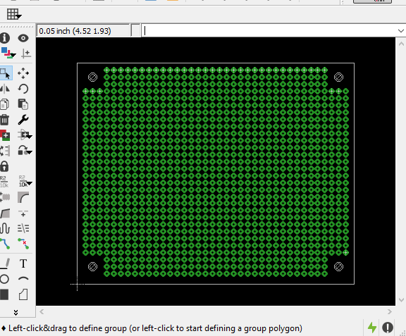

Hi, I am new in the Eagle world and I am making a 2 layers custom board with Eagle.
I am trying to do a simple custom size board full of holes for through hole components ( a simple prototyping board) and I am not sure about which is the best way to make the holes.

    Firstly to create a components in a new library by:
    a. defining a package (which just consists of the pads of the size you want),
    b. defining a symbol to associate with the package,
    c. creating a device that correlates the pads of the package with the schematic symbol.
    From that create a Project and within that project create a schematic file.
    Place your newly defined device onto your schematic (for a proto board with no connections you won't have to define any nets),
    (I.e. Your schematic will just be a bunch of non-interconnected components)
    Then click the SCH/PCB button and allow EAGLE to create a PCB for you.
    Now you can move the device into the position you want on the PCB.
    The Schematic and PCB are closely linked allowing you to switch back to the schematic to make changes and by clicking the SCH/PCB button it'll place any new components on the PCB file.
    Mechanical holes don't necessarily need to be included on the Schematic and can be placed directly on the PCB.

    If you look very closely you'll also see the two pads with the enlarged holes as per your photo.
  • COMPACT
    0 COMPACT over 9 years ago in reply to COMPACT
    It also makes for a good familiarisation practice session with EAGLE for Library, Schematic and PCB editing.

    0 COMPACT over 9 years ago in reply to ardenne
    It is always best to schematic capture a PCB because it allows revisions and additions to it to be easily accomplished.
    For example - your Proto board - There will most likely be a stage where you want to add power rails or planes to it.
    Facilitating this is done easily using a schematic.
    There's no reason why you can't capture the prototyping area as components and have them placed on your PCB.
    If fact EAGLE works best in this mode because it switches between its schematic and PCB for its Design Rule Checking.
    I just kluged this up in moments to illustrate the point. Complete with mounting holes.
    The size of this board is at the maximum freeware limit.
    • Reject Answer

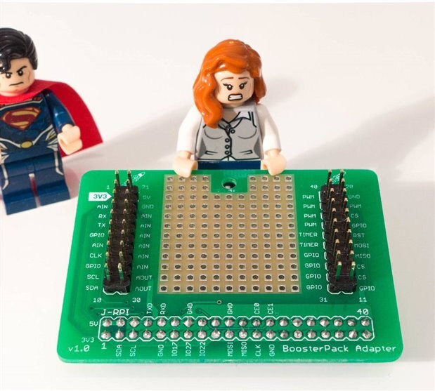

    0 shabaz over 9 years ago in reply to ardenne
    There are many ways to do it. The one in this photo was created by making a component for the pads. To simplify further I created a component that was a block of pads (e.g. 4x4 or whatever).
